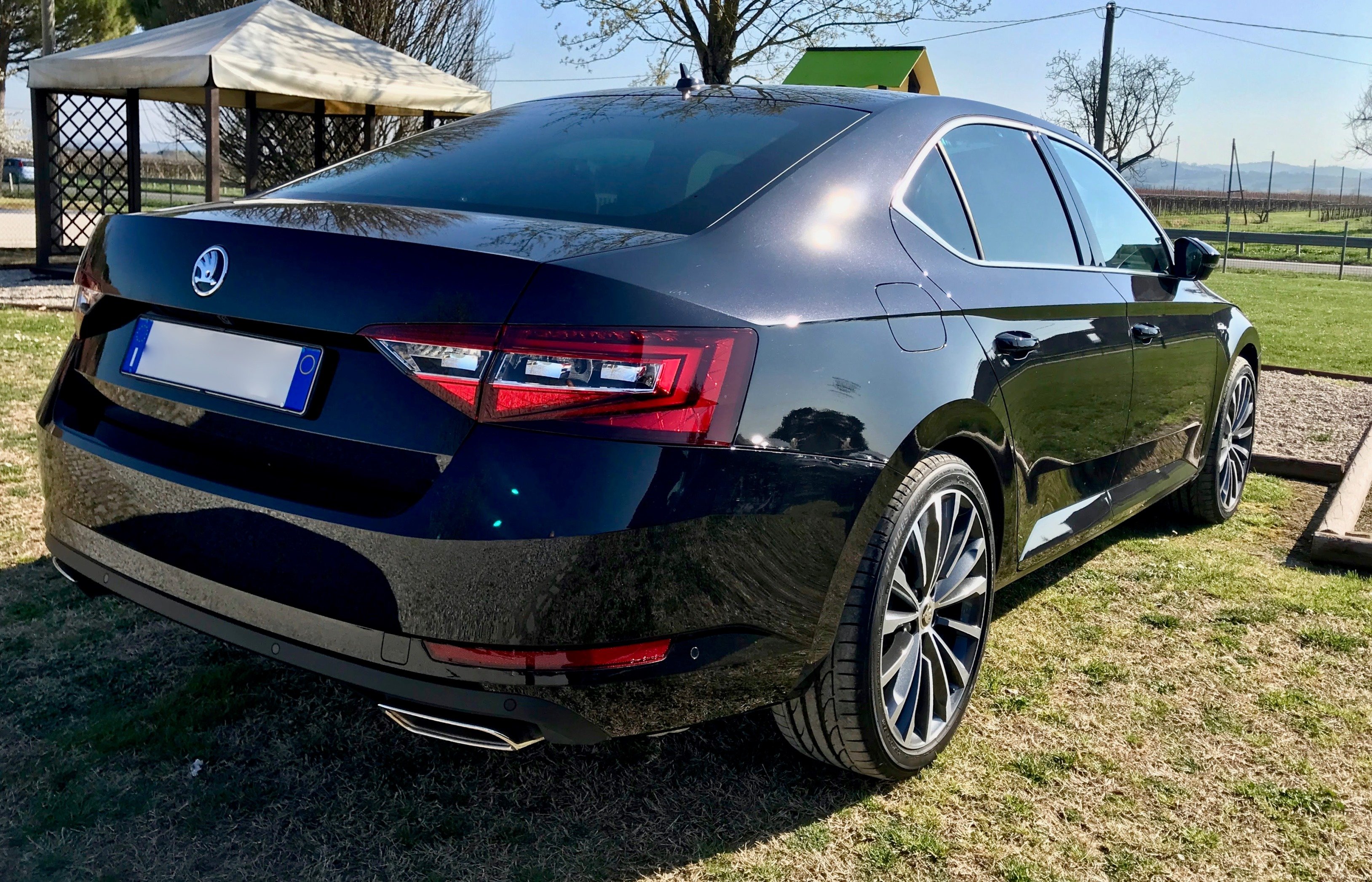

  1. I have to admit that when i bought my 272 Superb I didn't have full knowledge of this 2.0 tsi engine. I had two other options: a new Audi A4 (2.0 TSI 185kw 4x4) or a 540i with 6.000 km on the clock. Superb was the cheaper one. And it was my wife’s option n.1 (after this i’m sure you’ll understand i only had the illusion of choice, but I like to think that the choice was mine anyway). I did not have much expectations from this engine, only because i didn’t know it’s potential. After first 1.500 km driven as slow as imposed by the manual, i got 18.4 sec on 100-200, not to bad related to my expectations, but not exactly exciting. So i went to my tuner, (he had already remapped my Octavia II 2.0 tdi 140), asked for a stage1 remap. Another 1.000 km driven and the 100-200 time was 12.5 sec, with an incredible 0-100 in 4,3 sec. Quarter mile in 12,52. So I started looking for information about my DNUA engine, and little by little I understood what I had really bought. I thought I should enjoy the full potential of the engine, and this idea crept into me. I wanted it to look as original as possible, especially in terms of noise, so I had first to find a catted downpipe, and for DNU engine i had to wait till october 2019 when Milltek made a downpipe for the new Audi S3 OPF with hjs 200cell cat. Then i searched for big turbo, i didn’t want to compromise so I chose the TTE535. It took quite a long time to find the right to me big brake kit, in the end the choice fell back on vagbremtechnic kit that includes 6 pistons AP calipers, floating 390mm AP rotors and DS2500 brake pads. For sure oversized for street use, but safety first. Note that this kit fitted perfect with Racingline R360 wheels without spacers. Due to covid-19 lockdown i had to wait till may, and then we started with: Millteck downpipe with HJS 200 cell cat TTE535 turbo Racingline R600, silicone inlet hose and inlet pipe Forge intercooler and silicone hose kit Autotech HPFP upgrade Racingline oil management system Dsg has been remapped but ecu map has to be completed, it’s taking more time than expected. Aside from the performance, for now the only thing i can say is about the noise: exactly what i wanted. Driving in D feels completely stock, so no unwanted attention while driving quietly in the city. But over 3.500 rpm it becomes music. Really, i didn’t know that this 4 cyl engine could sound pretty good. No pops and bangs, no dsg farts, just only the engine with a TTE535 whistle… almost intrusive, but lovely.
