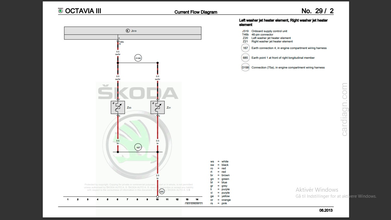

  5. Thanks Then I just have a question that I can't seem to find answers to What does it mean when theres standing "D198 Connection (75a), in engine compartment wiring harness" Is it that is just a spliece in the wiringharness that is going to J519 Connector T46b Pin 9 ?
  6. Hi guys is there anybody who know what it takes to retrofit Heated washer jets for the windscreen in a Octavia 3 without factory fitted heated Washer jets ? i tryed looking at the current flow diagram but i can't figure out where to connect the wires Thanks in Advance
