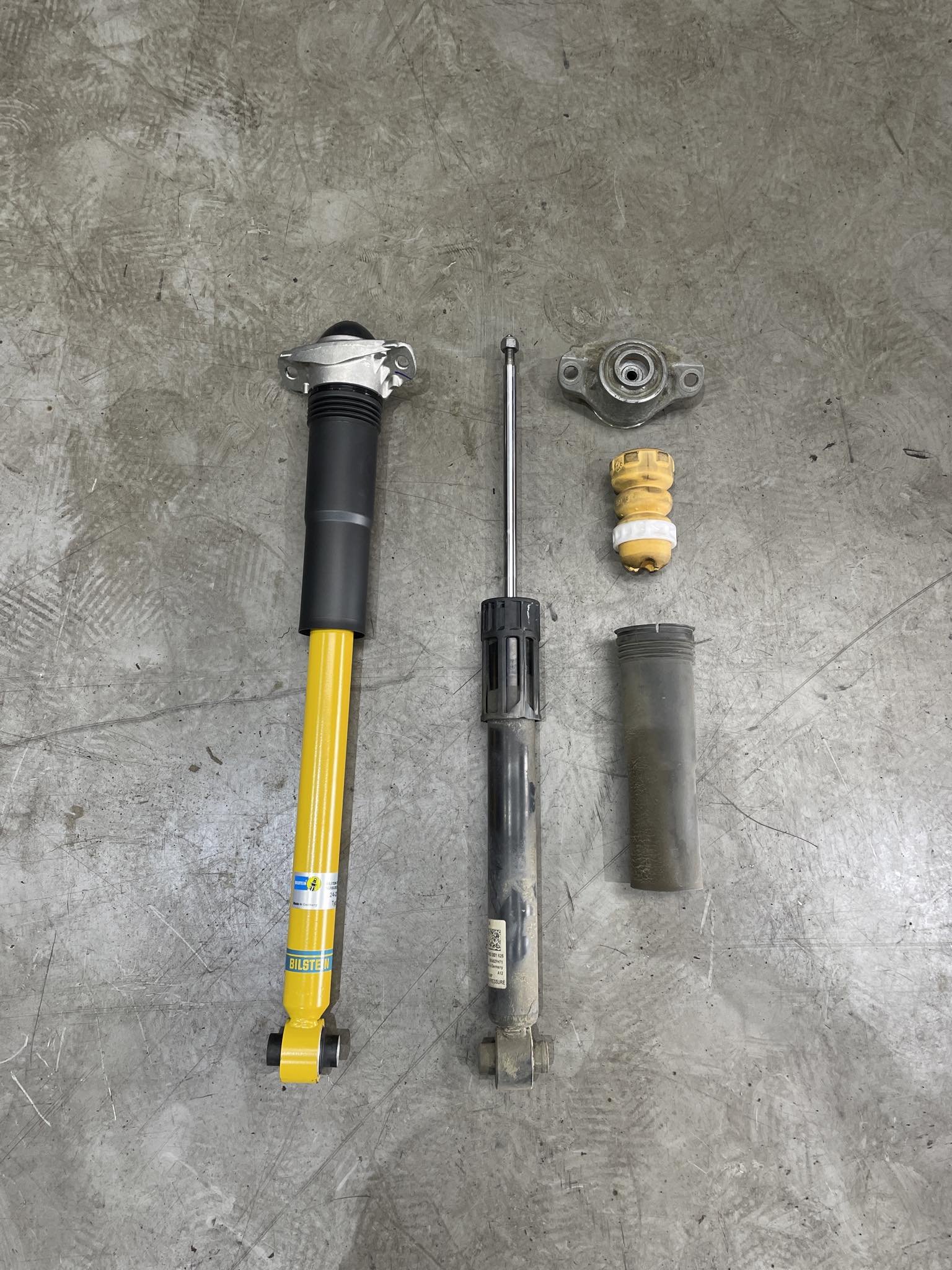

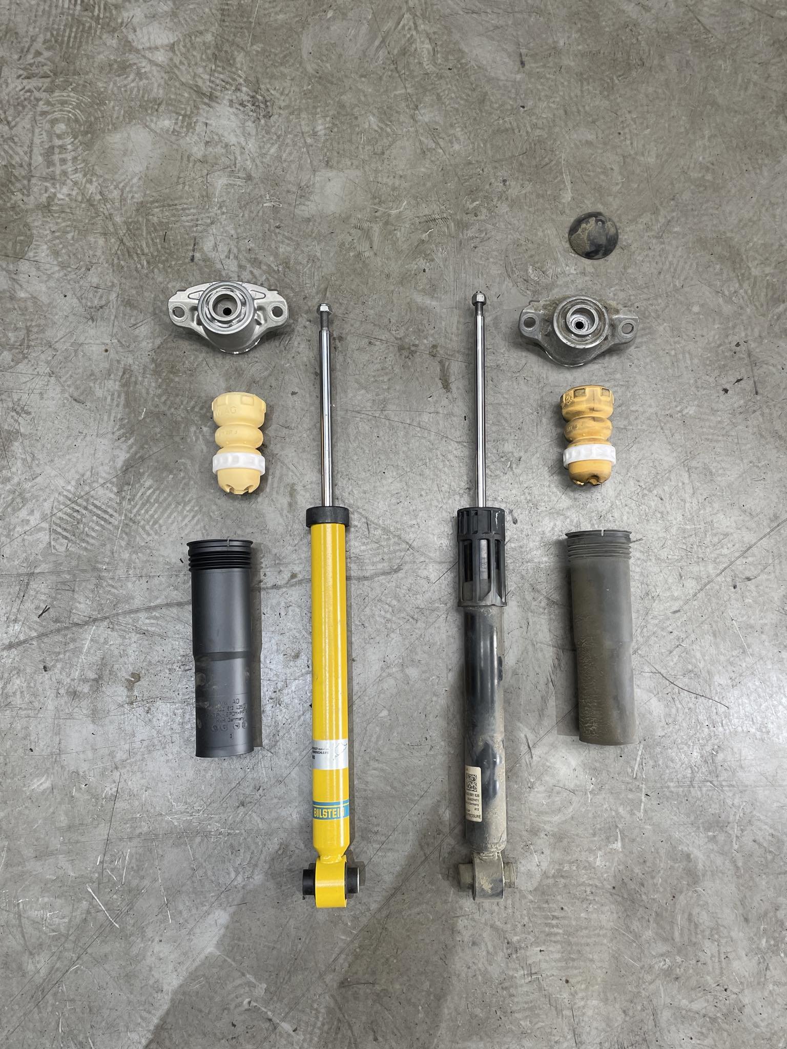

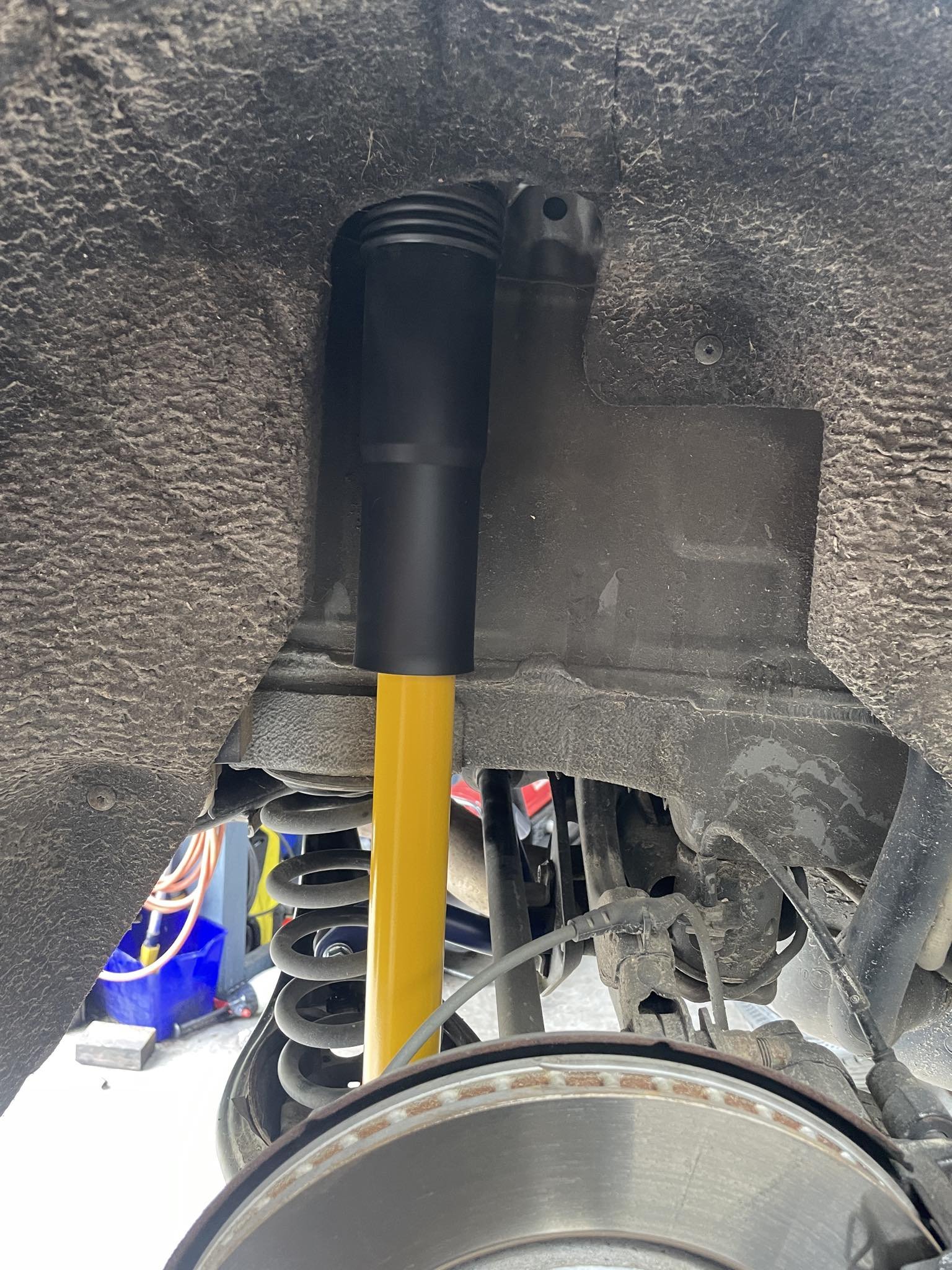

Can someone please shine some light on this ? Time came for the Eibach springs to get fitted last week only to find out that the rear springs don't fit at all. They are hitting rear droplinks without any weight put on them. Yes i know the springs are for estate and my car is saloon but they don't fit. Unless my mechanic doesn't know how to fit them I'm really lost. Pictures attached below

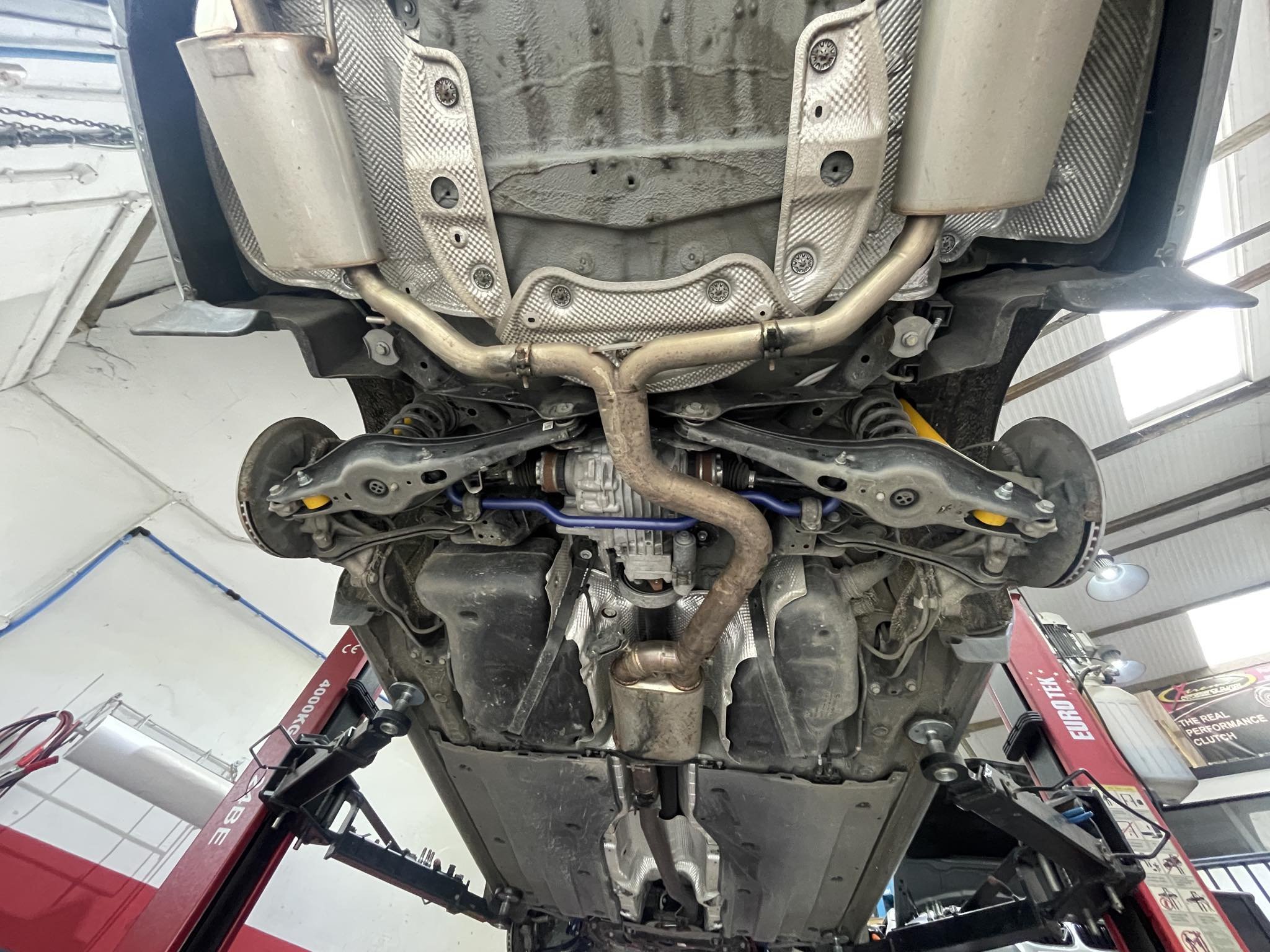

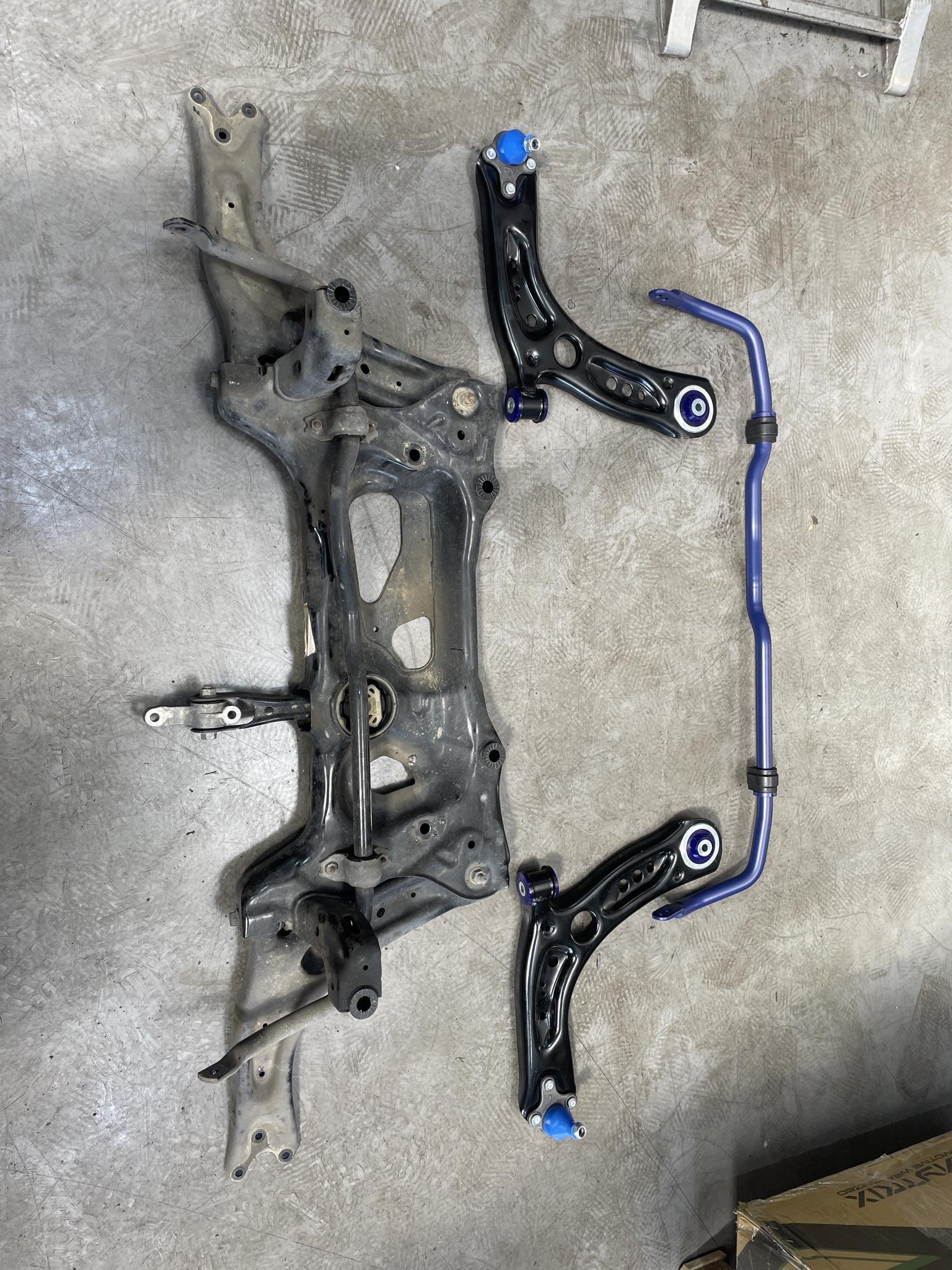

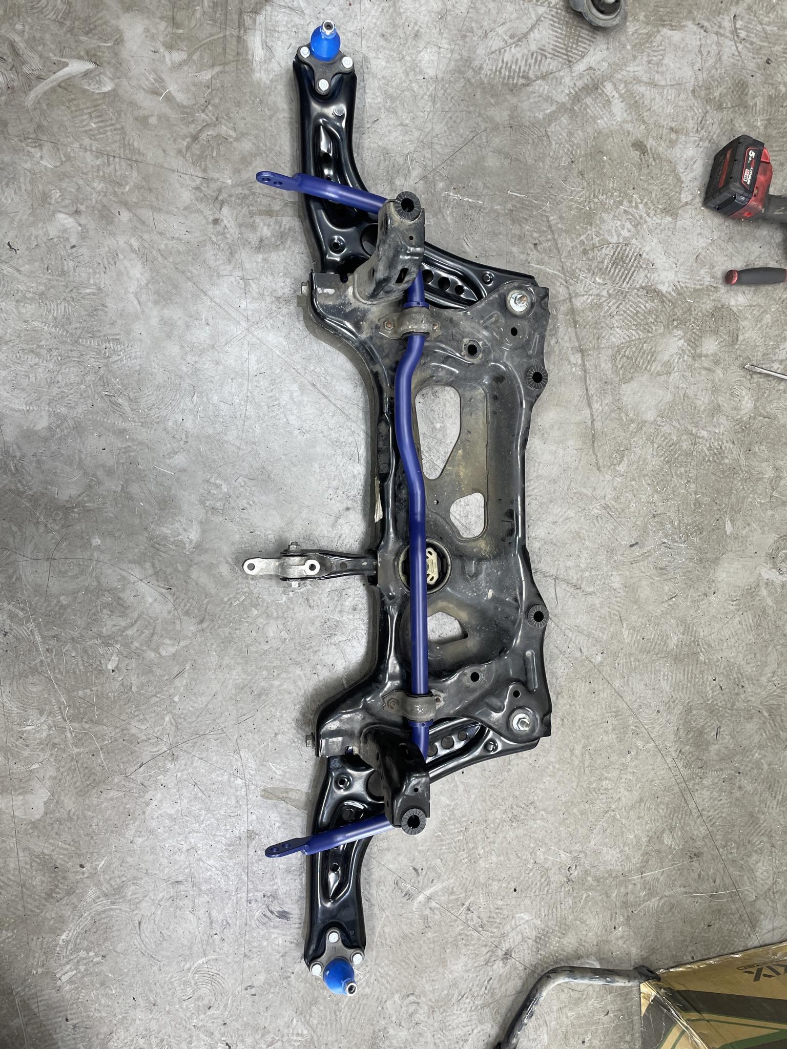

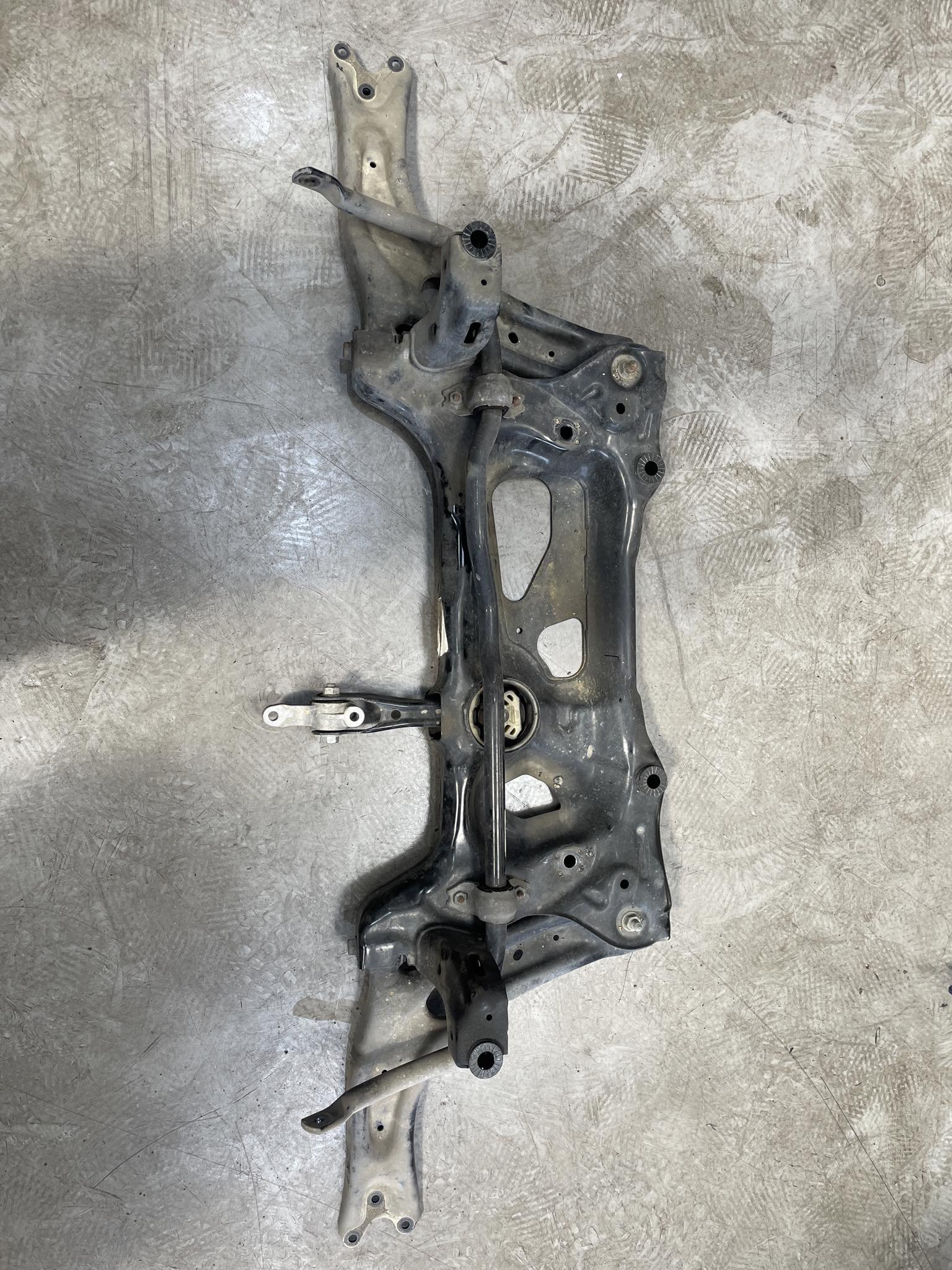

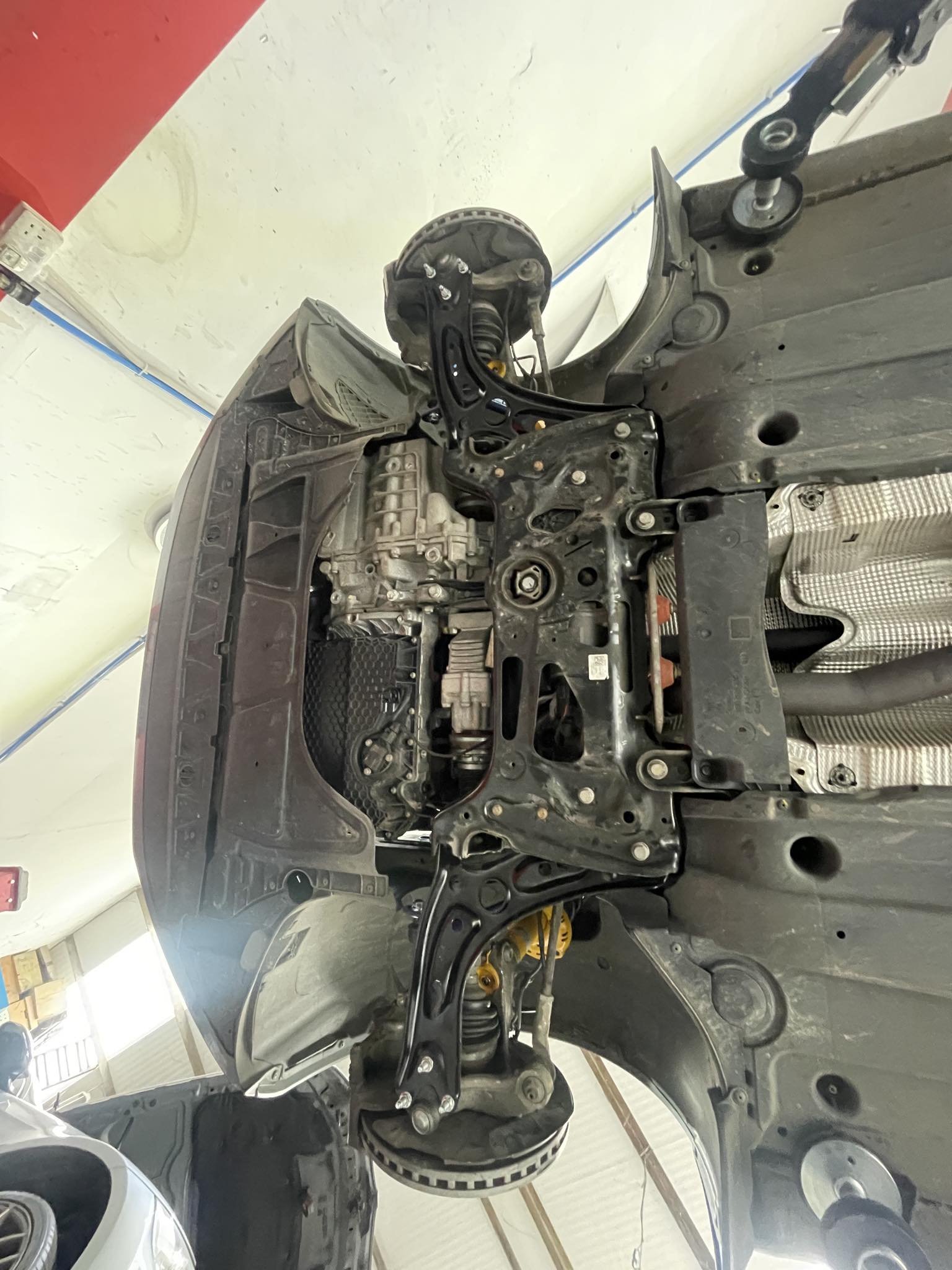

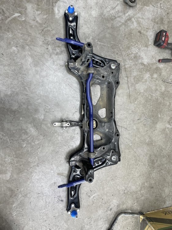

Yeah that's them...they are mainly for golf. I had them on car for 2.5 years, no issues until now. Just last week i started finding things that failed prematurely because of these arms. They are inch shorter on each side compared to Superb ones. My whiteline droplinks -split, ball joints -split. Got genuine ones fitted today and tomorrow it's going for wheel alignment, next week new droplinks getting fitted (Whiteline) again. I believe you can get Audi TTS bottom arms which are aluminium but I'm done with d*cking around. You can fit them and they work but they will make everything else wear lit quicker. They will also reduce your track width by an inch on each side
