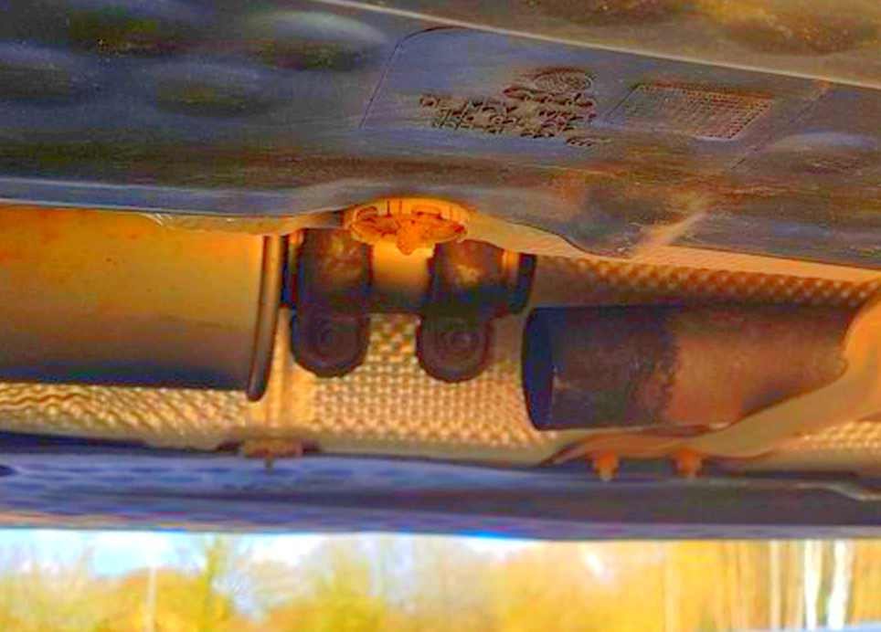

  8. Tweaked your pic a little, maybe what has happened is a little clearer ?
