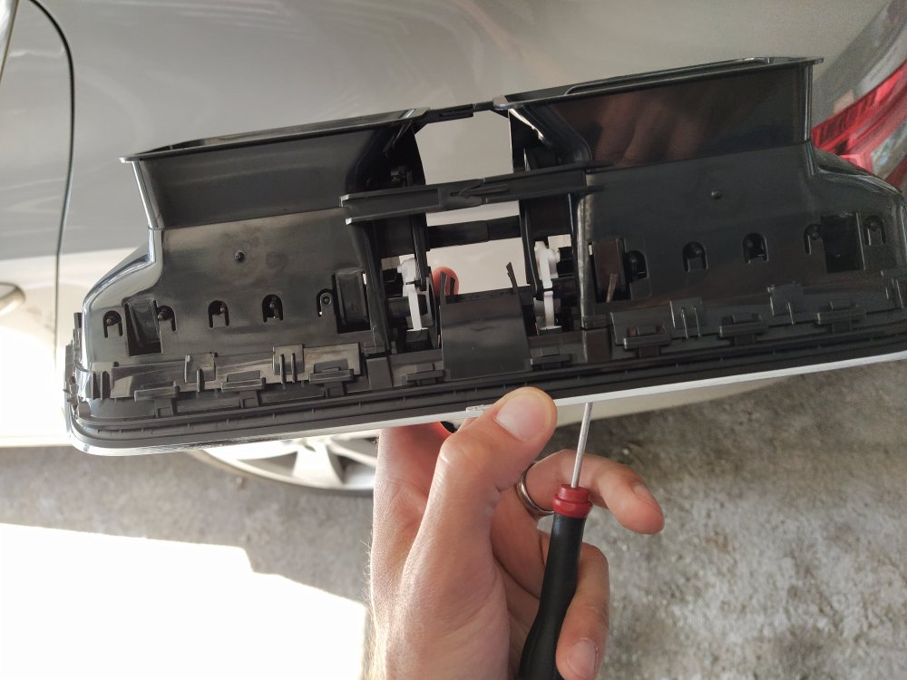

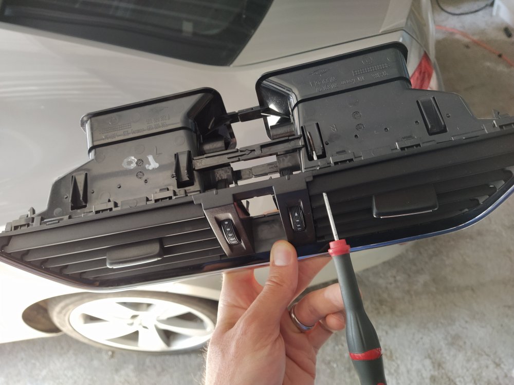

Centre Air Vent Trim
- Centre Air Vent Trim
The whole vent has to be removed. I did it. There are 8 tabs (4 top / 4 bottom) you have to pry from the vent and then just pull.- Engine, gearbox and suspensions retrofit
