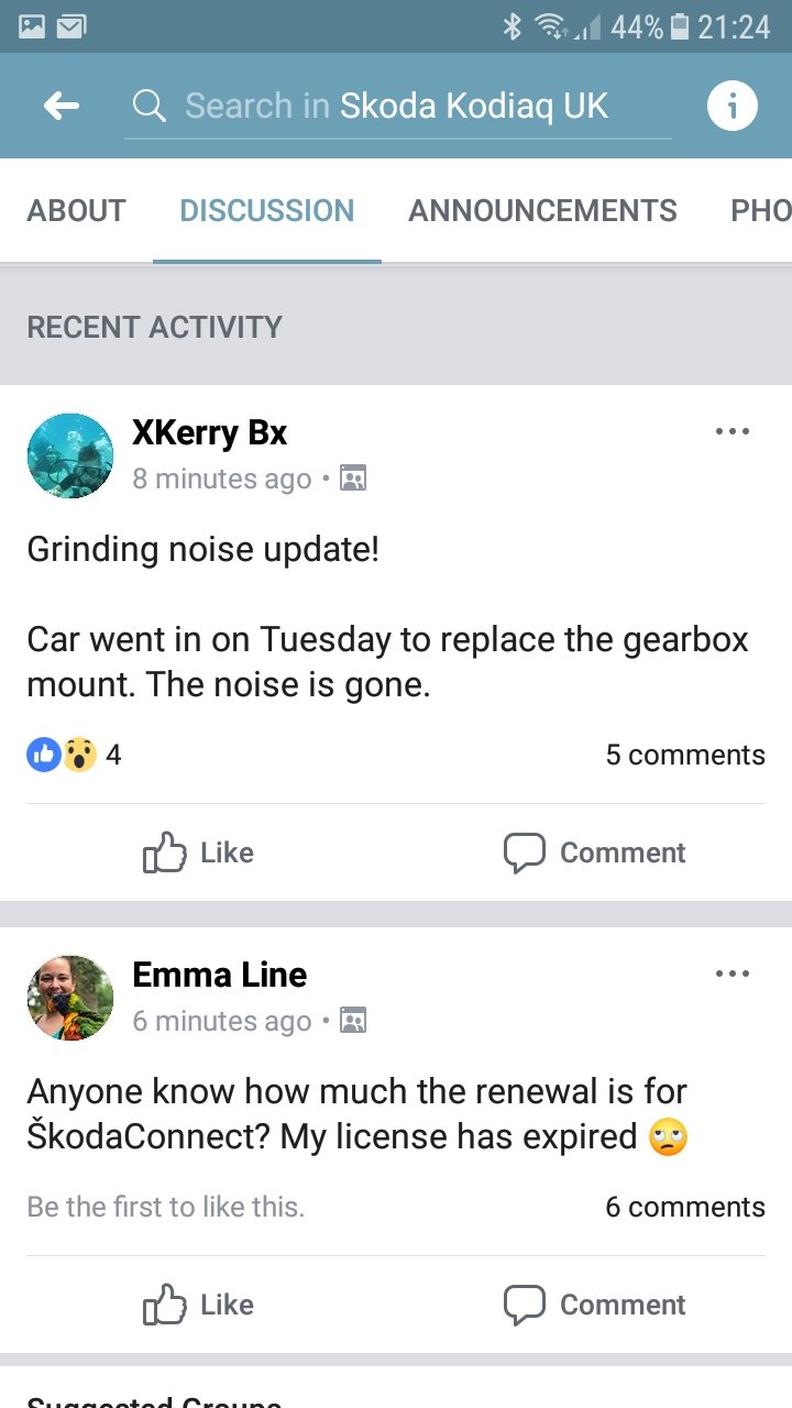

There is a Kodiaq owner over on Facebook who's dealer finally cured the noise.
Gearbox mount...
Yes that is my post lol I was ready to reject the car to be honest. The dealer had changed the bearing but noise was still there. They contacted Skoda UK who then sent a bulletin stating it is normal acoustic noise. My brother has the exact same car as mine so told the dealer I would be rejecting. They got back in touch with Skoda who asked them to try changing the gearbox mount and it has worked. Noise gone! Glad I didn't accept the acoustic rubbish!

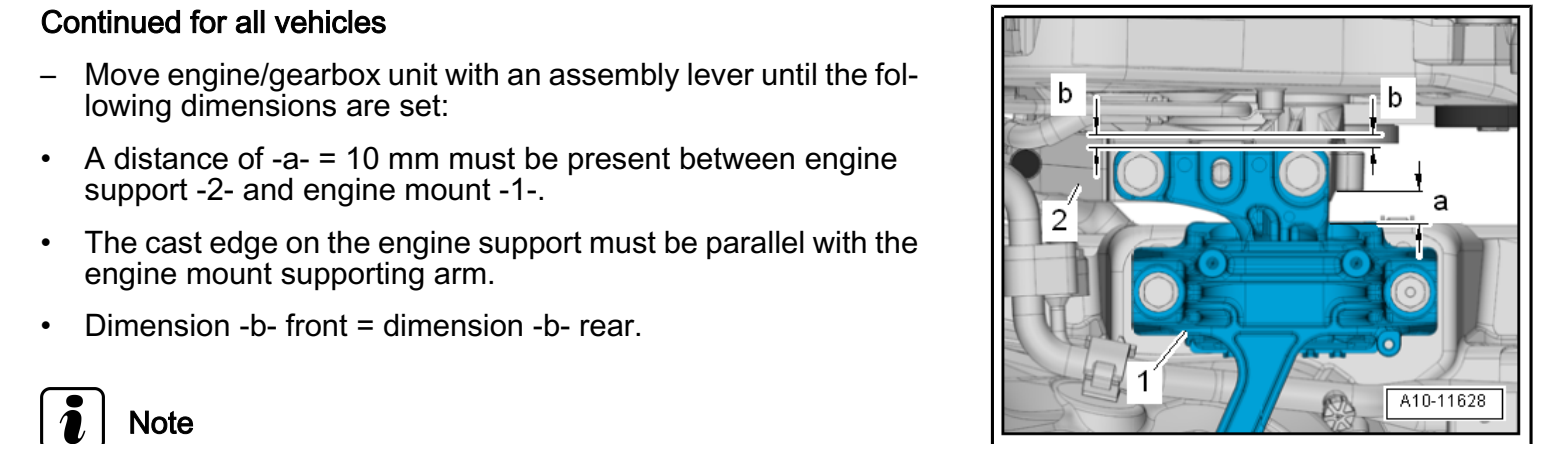

What also is needed to be controlled, is the "top motor mount". So, both of motor mounts must be adjusted or in position according Skoda workshop manual. It is especially important that the "-b-" is correct, that the motor is mounted in parallel with the mount.
Same story is with motor mount under the battery.
If this is not important, it won't be in the workshop manual :)
Top motor mount adjustment:

Yes i've saw it, but the question that I've brought up is, has the Service  followed instructions from the workshop manual about engine alignment?
Ussually it is not followed, just "engine up" -> "replace support" ->  "mount screws" -> "done"
If the engine is not aligned, the drive shaft is under constant lateral pressure. That is esspecially noticable in curves when some additional (centrifugal force coming from the engine weight and curving) force is producing even bigger pressure over bearing joint. This joints are not design to handle this lateral force.
My idea was that someone, who has this issue, can crosscheck the adjustment of the top engine mount, and give us some feedback.
I have some grinding noise, and engine alignment is not correct also.
Edited by ppejic
I must correct my self. Lateral pressure is not existing, because shaft has lateral movement of 2-3 cm by its design 😞
