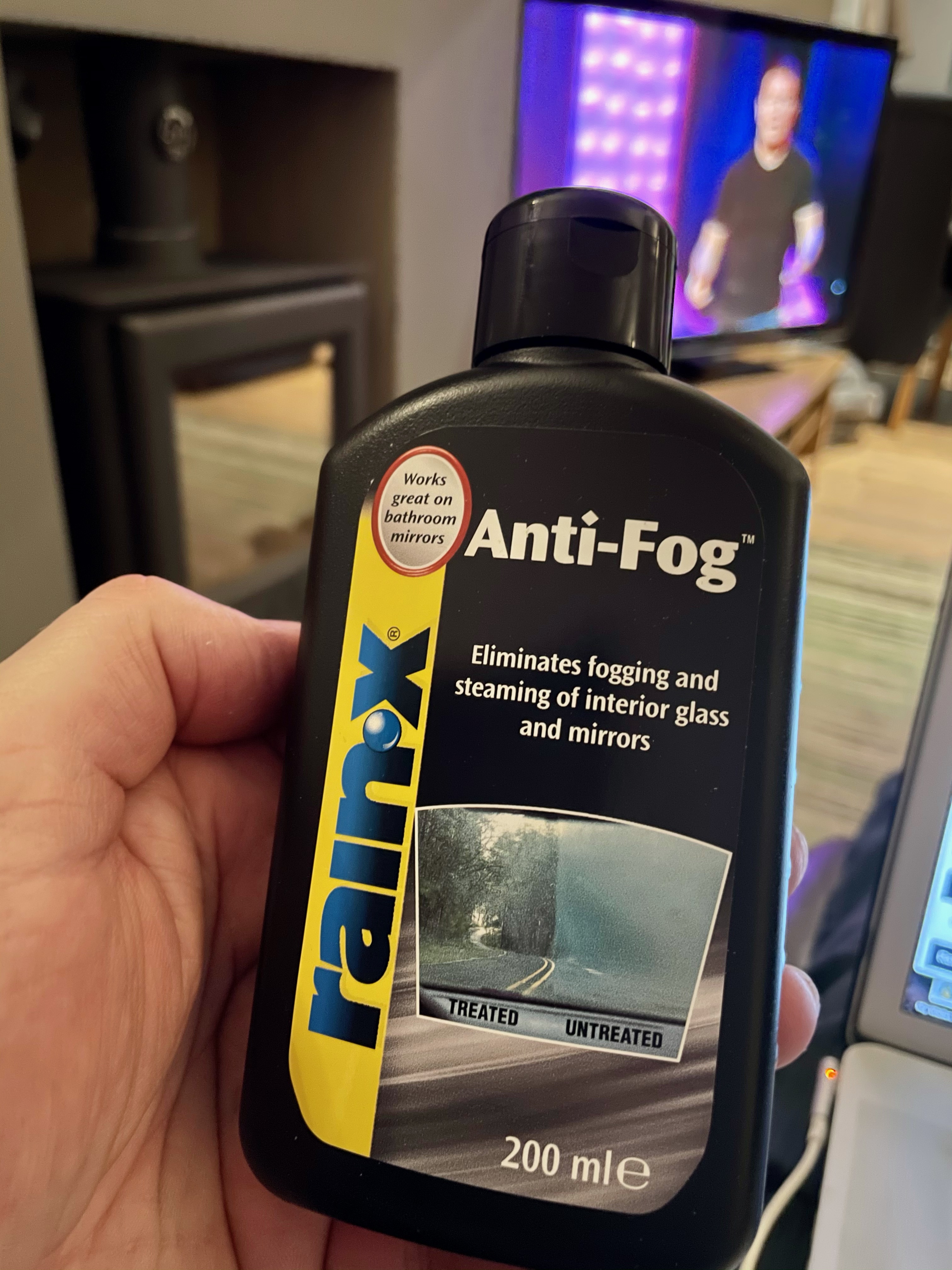

Aldi are currently selling RainX AntiFog for £3.99, no idea how good it is but I've bought a bottle.
I used this a couple of years ago and it was pretty good, but takes a lot of work to put on properly, first have to thoroughly clean the screen, degreaser and paper towel job, then apply and buff off - lengthy and physical job (if you're getting on).

Rain-X is a good product IMO, but a pain to apply properly. back to the OP ... if you have condensation in the car you either have water in the car or something in the car is holding water ... likely culprits are carpet mats if you are sure you dont have water ingress. In the current weather the mats will just soak up the damp and then you will have condensation issues, either that or you are not allowing the car to dry out properly (prob short journeys.)

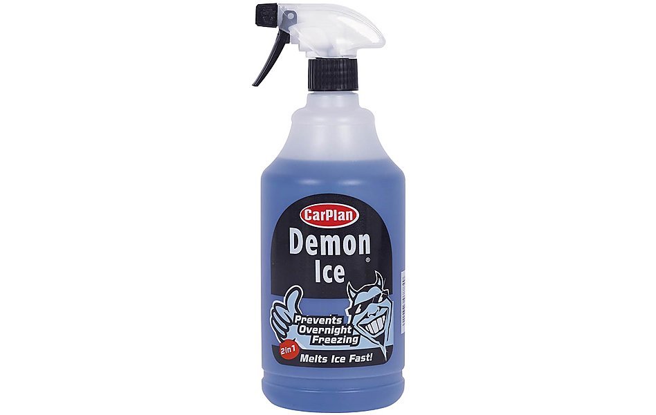

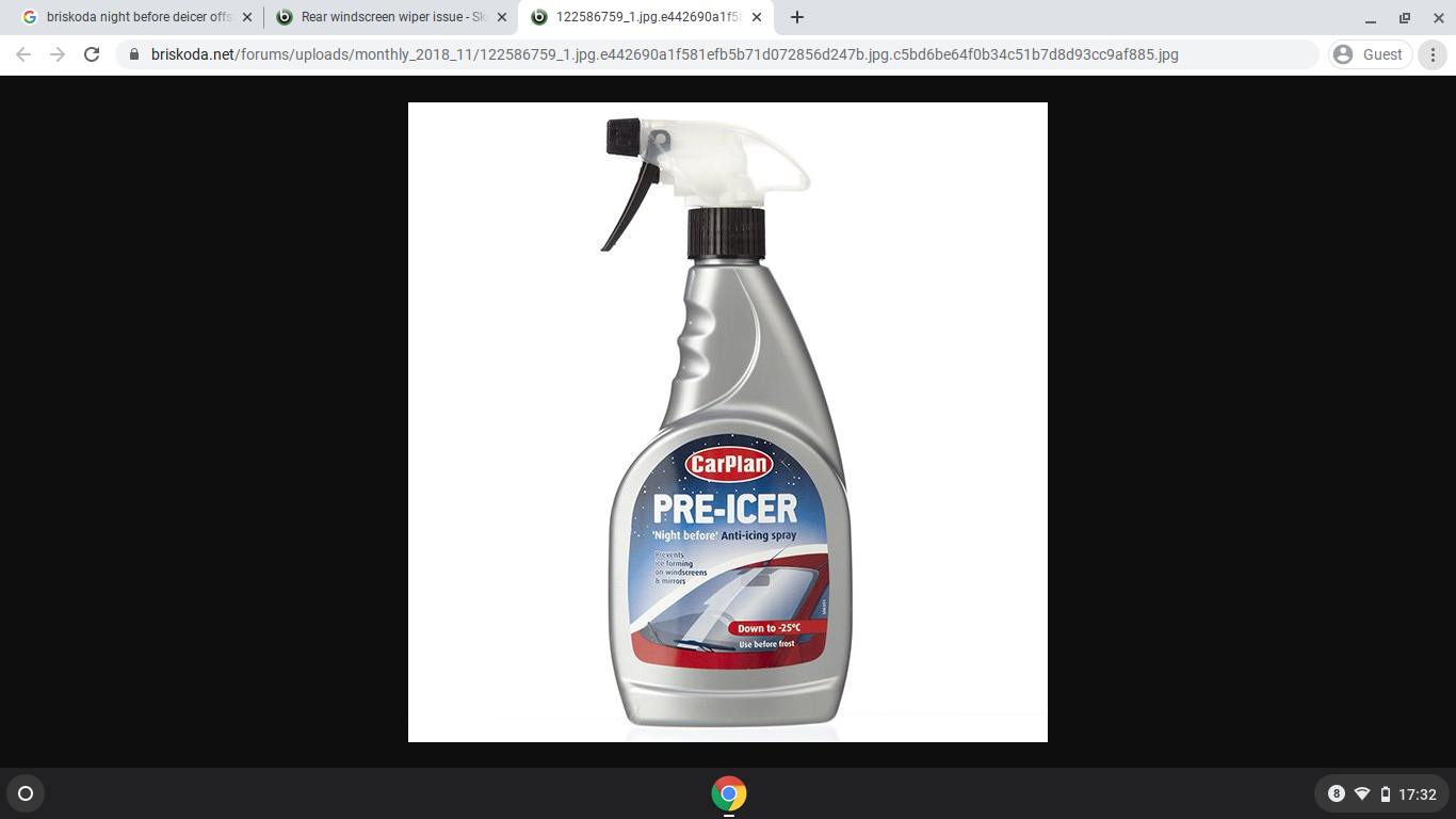

The Car Plan Pre-Icer i bought last year instead of Halford Pre-Icer was rubbish and left very greasy windows.
  Brilliant though for spraying on door and hatch seals.
As is other Pre Deicers, or Silicone Spray & even WD 40.  Just clean off after frosts are over.
Be sure to clean the fuel filler flap area and prepare for winter freezing with lubrication of the rubber or just paint to paint.
