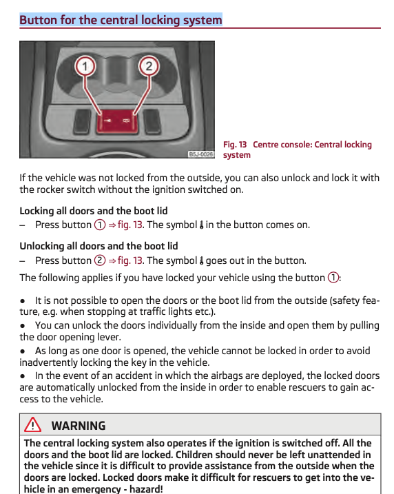

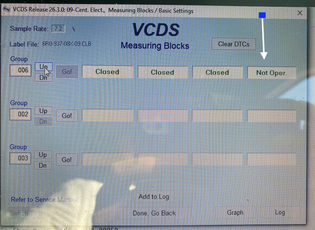

Button for the central locking system in Fabia Mk 2 13Plate

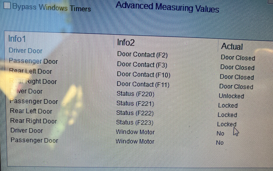

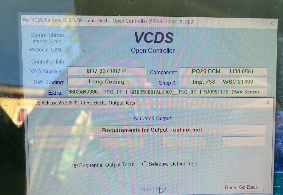

Analysed and found issue with resolution plan : This was achieved using VCDS in my case central locking button switch was not locking doors but unclock was working fine so I have tested live data of ECU and found that the button when clicked for locking is un-operational in VCDS status means button may have circuit/ mechanism issue or soldiering issue . please find attached screen shot it may help , the live option was inside under number 9 Cent Elect option I think. Thanks kind regards
