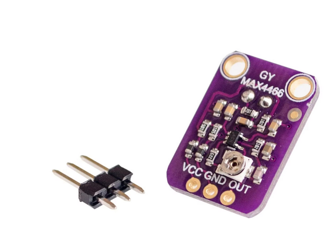

  6. Thank you, i read... I think can use for connect to actual microphone. remove microphone from this module and connect directly wire from mic from skoda. What do you think? on gnd and out connect mic + and mic - and vcc - 5 volt from adapter 12volt to 5 volt. Uploading Attachment...

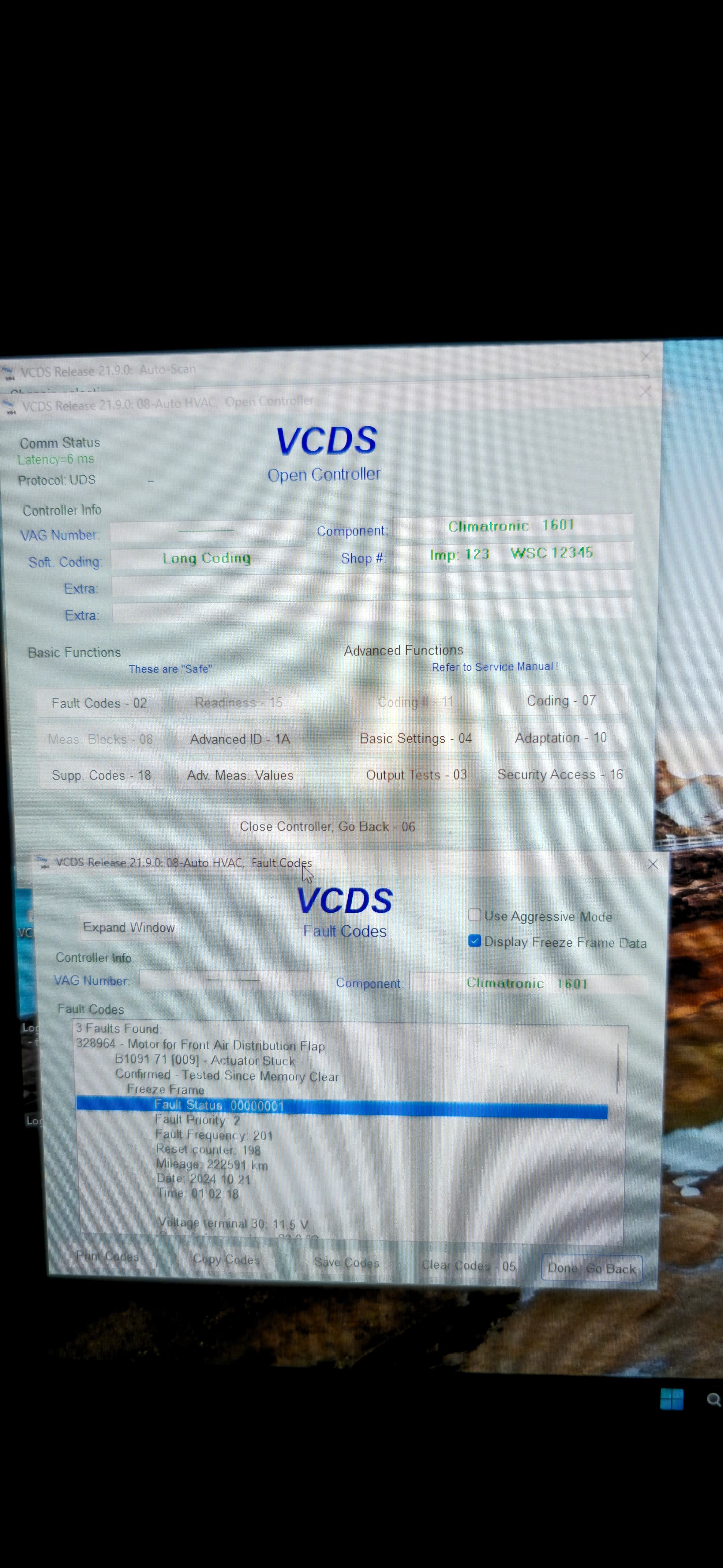

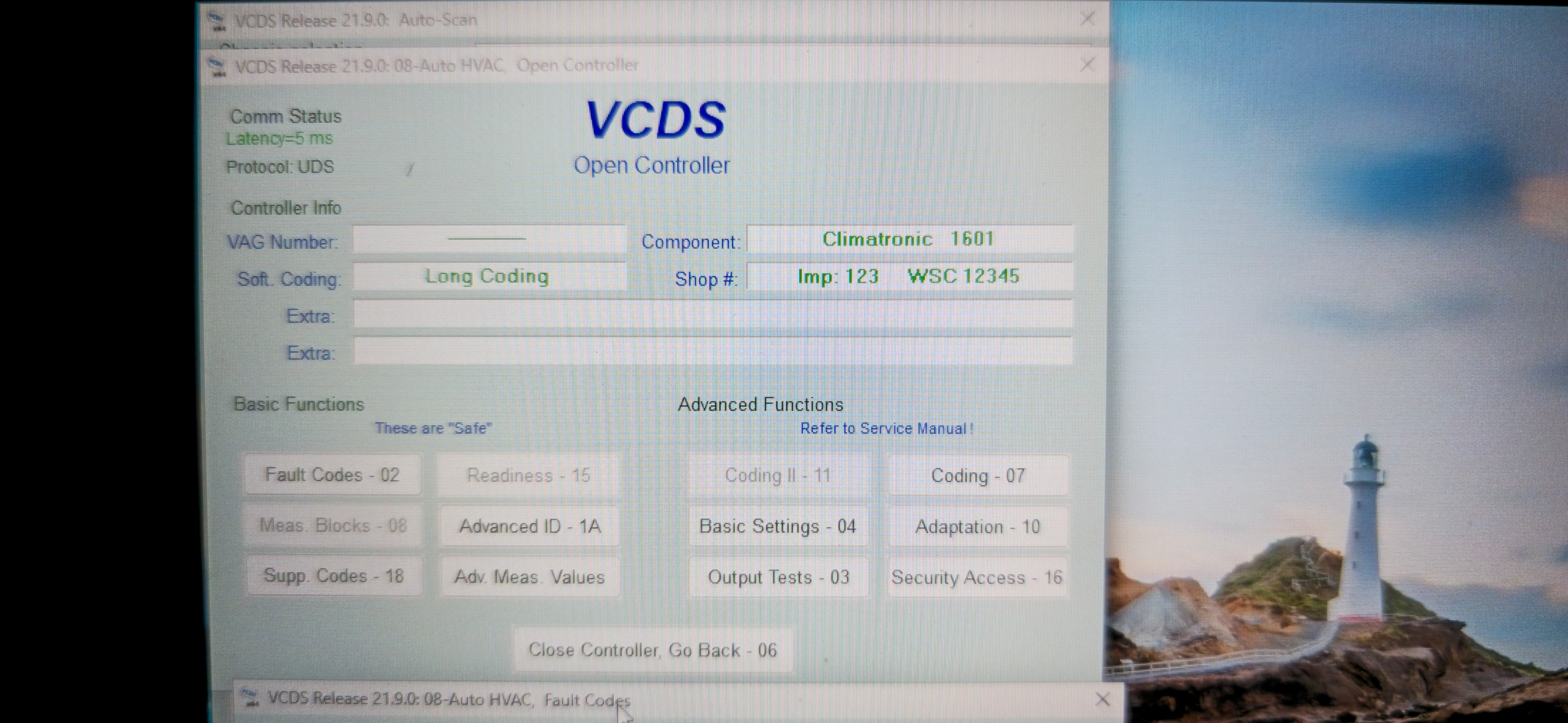

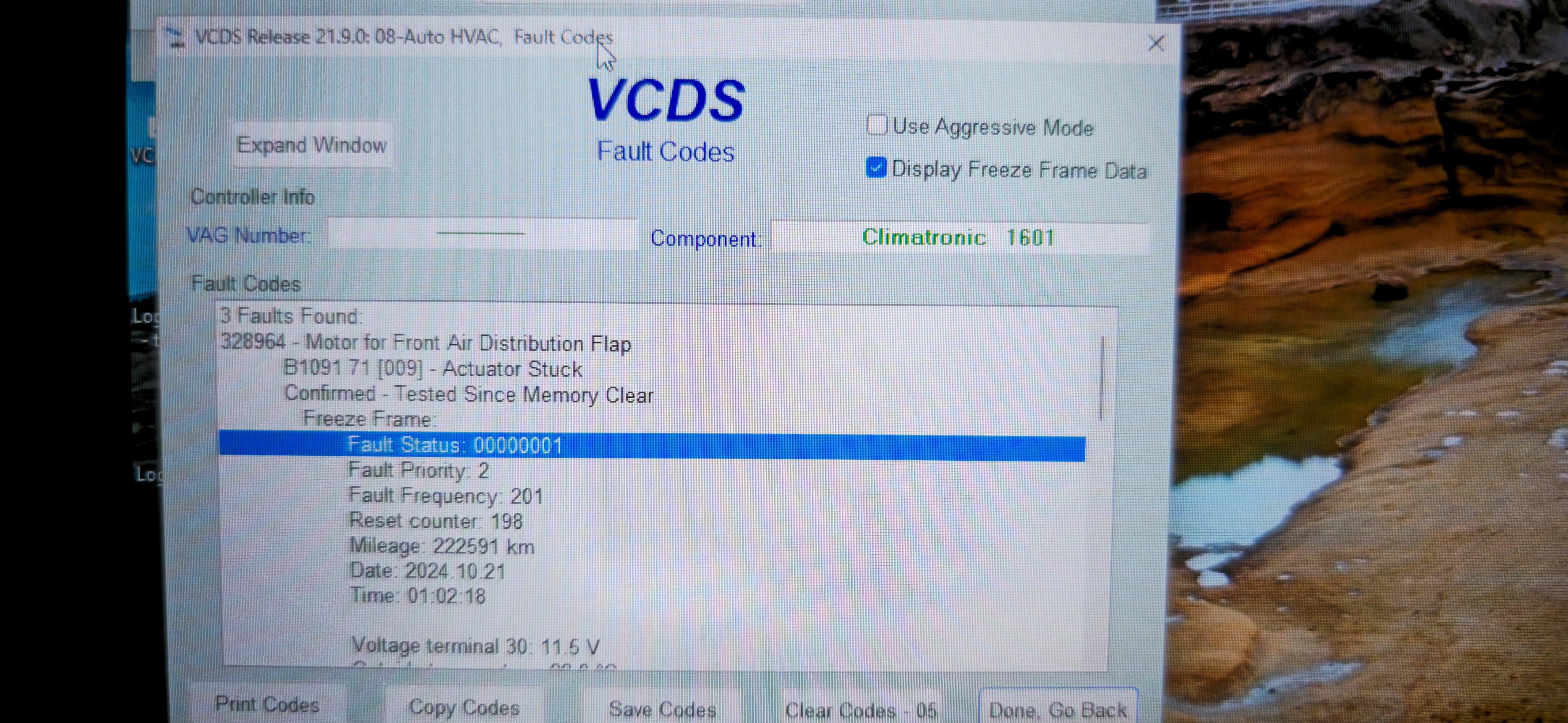

  10. hello, sorry for my poor English.... So, a few days ago my battery died suddenly and the alternator didn't work either....that's why some equipment shut down one by one...if we can say that...they were deactivated. The most difficult problem is with the Climatronic, which at the moment is no longer identified at all, it sees it, reads error codes but does not actually see it. To operate, it only goes on manual, when I set it on auto, it gives the fan speed to maximum, and enters the re-circulation and frontal air mode. I am attaching 3 images. How can I set their Vag Number? I accidentally saved older information about how... Address 08: Auto HVAC (J255) Labels:* Redir Fail! Part No SW: 5E0 907 044 AG HW: 5E0 907 044 AG Component: Climatronic H04 1601 Revision: 00001K07 Coding: 01010104002110011005000100101002 Shop #: WSC 73430 031 00063 ASAM Dataset: EV_ACClimaBHBVW37X 006142 ROD: EV_ACClimaBHBVW37X_006_SK37.rod VCID: 6A8DC2B52CFC178B195-803E thank you
