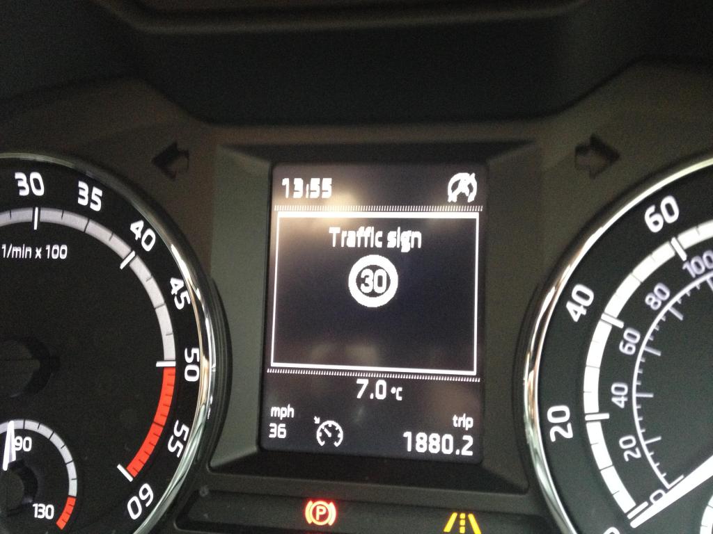

Enabling Traffic Sign Recognition on models with Lane Assist

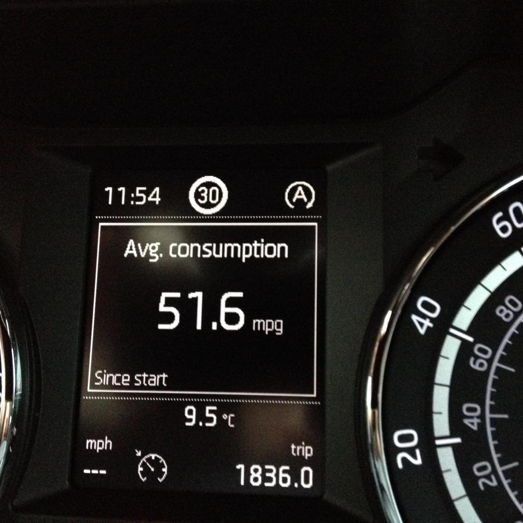

Thanks to ollybroad for the screenshots and colour maxidot piccies and trying this one out
Thanks to Neily03 for letting me try this on his car and standard maxidot piccies, and I can confirm it works with Bolero & Standard Maxidot - BUT on models without sat nav you get an error message pop up when you start the car that the traffic recognition has restricted functionality and an error on the car status on the Infotainment unit, basically because you don't have a sat nav. It is highly recommended NOT to enable this unless you have a MIB Columbus or Amundsen - you still get the restricted functionality warning though with those.

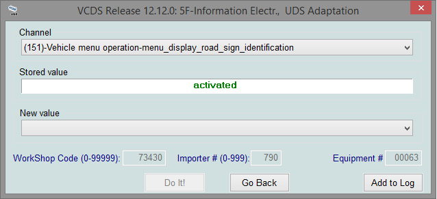

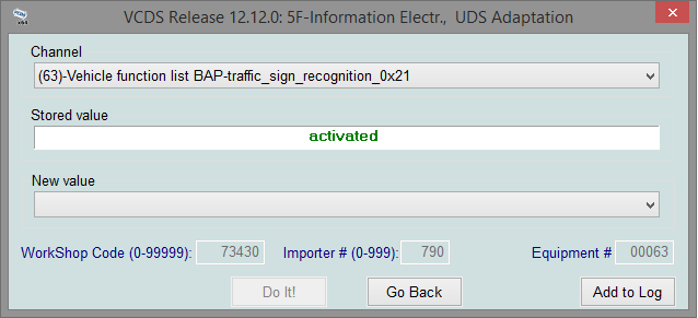

Controller 5F (Information Electrical)
10 - Adaptations
Select channel: (63) vehicle function list BAP traffic_sign_recognition_0x21
Adjust Value to activated
Channel: (151) vehicle menu select-service menu_display_road_sign_identification

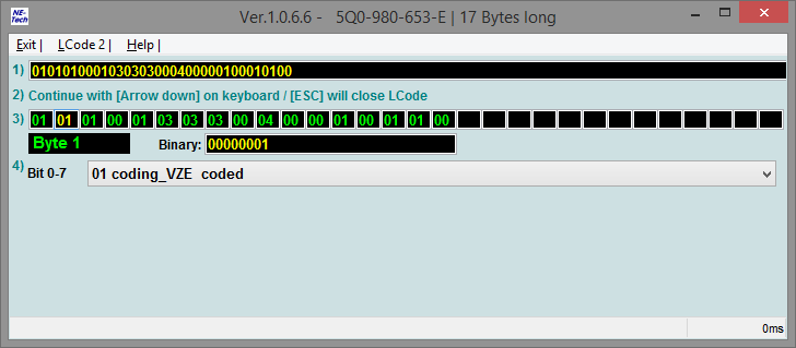

Controller A5 (Front / front view camera)
07 - Coding
Byte 1
Bit 0 Enable - "01 traffic sign recognition (FTE) active"

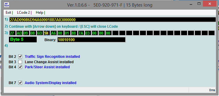

Controller 17 (Instruments)
07 Coding
Byte 5
Bit 2 Enable - "Traffic Sign Recognition installed"

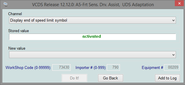

16 - Security Access - enter 20103
10 - Adaptations
Select channel Display end of speed limit symbol
Change to activated

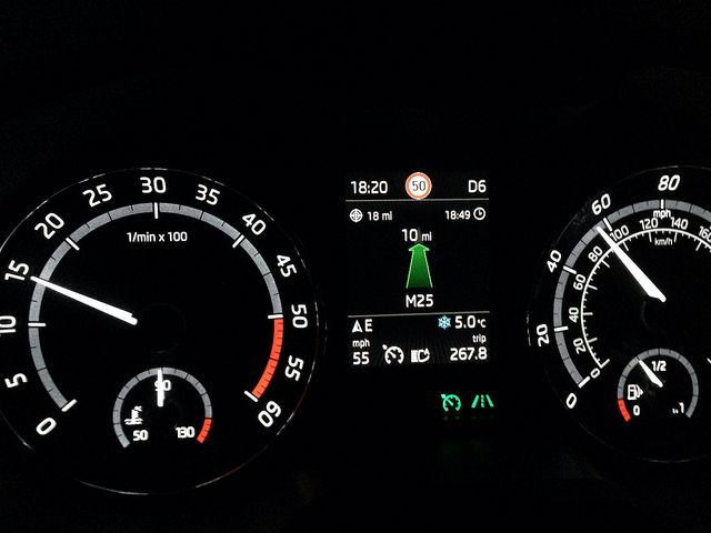

Some piccies from a Colour Maxidot with Columbus
Some piccies from a standard Maxidot with Bolero

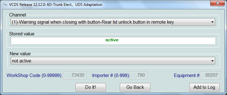

10 - Adaptations
(9)-Daytime running lights-Tagfahrlicht nur in Schalterstellung AUTO - change to active

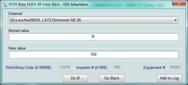

For maximum illumination change the following channels for the LED DRL strip to be 100% brightness for CH/LH only - it wont affect any of the other operations (side light, DRL etc).
(10)-Leuchte2SL VLB10-Dimmwert CD 2 from 35% to 100%
(10)-Leuchte3SL VRB21-Dimmwert CD 3 from 35% to 100%

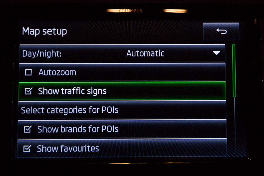

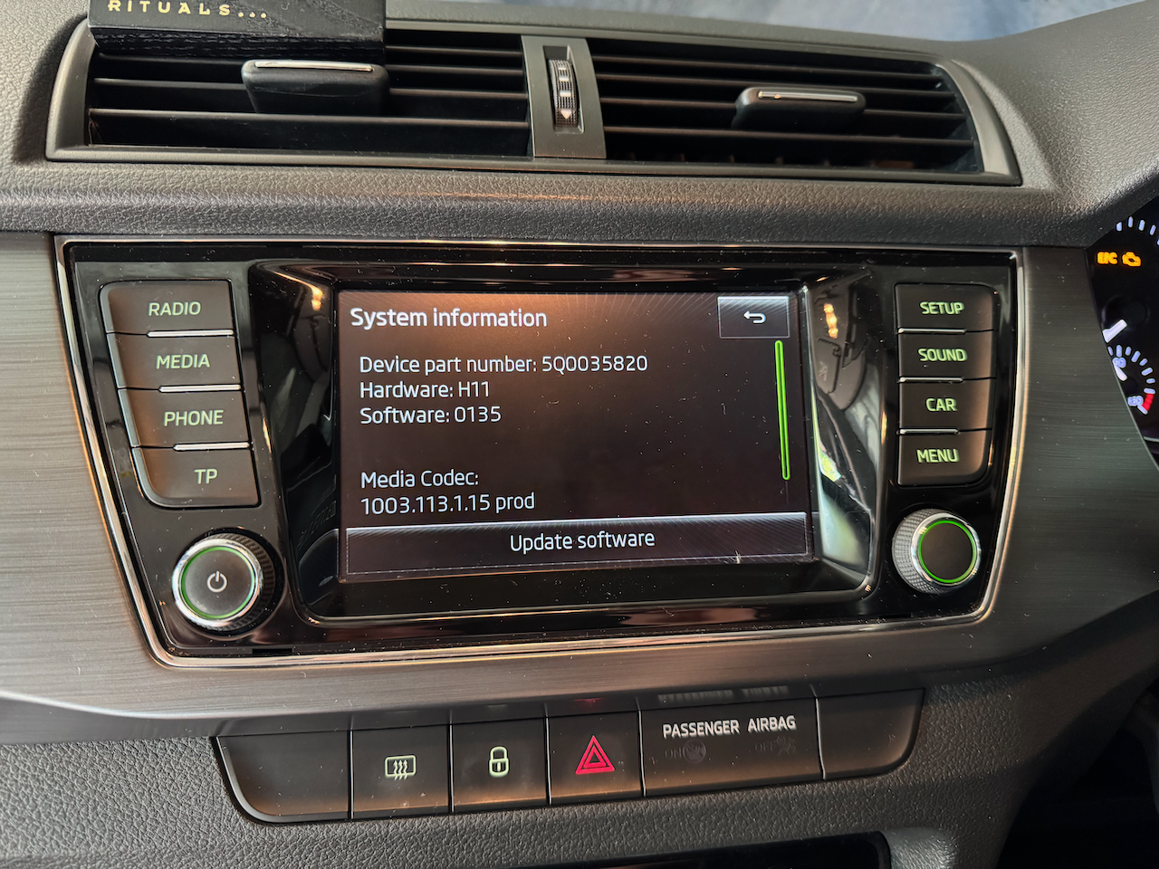

Enabling speed limit signs from the map data on a Columbus
Controller 5F - Infotainment
07 - Coding
Enable Byte 24 Bit 6
[screenshots to follow]
This is for cars WITHOUT Lane Assist and Traffic Sign Recognition. This will enable the option to display the speed limit data embedded in the map data on the Columbus screen. Some cars seem to have come from the factory without this enabled. You will now get an extra menu under the Map Menu as shown below. Thanks to spacenase for travelling all the way from the West Midlands and letting me scan his car so I could play 'spot the difference'.

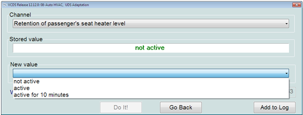

Heated seat level memory
Controller 08 - HVAC
10 - Adaptation
Choose 'Retention of passenger's seat heater level'
Change to 'active' (the setting it was on when the ignition was turned off will remain next time you start the car) or 'active for 10 minutes' (if you return to the car within 10 minutes the seat heater level will be retained).
Do the same for 'Retention of driver's seat heater level'
Thanks to antera for the screenshot
