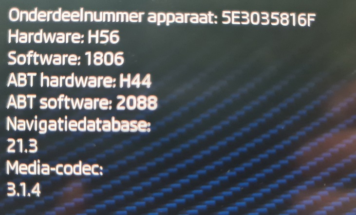

So, my car was a 2020 Octavia with headunit 5E3035816B, software 1664 updated to 1668.
With that headunit it was impossible to activate wireless Android auto.
Since last week there is an update available on the Skoda server, that will update the version to 5E3 035 816 F and SW version 1806.
And I can confirm that my wireless android auto is now working!
It should also fix some bluetooth, rear view camera and other issues.
The official update will be launched in one or two weeks!
That's an interesting curve ball!
So are you saying that the device part number 5E3035816B is now updated to 5E3035816F ?
My understanding was that 5E3035816B was linked to a hardware revision rather than a software one.
Is the Hardware still saying H56 or has it upgraded too?
Yes, still H56.  ;-)

Can you make picture of SW version of inf. system with version 1806..
