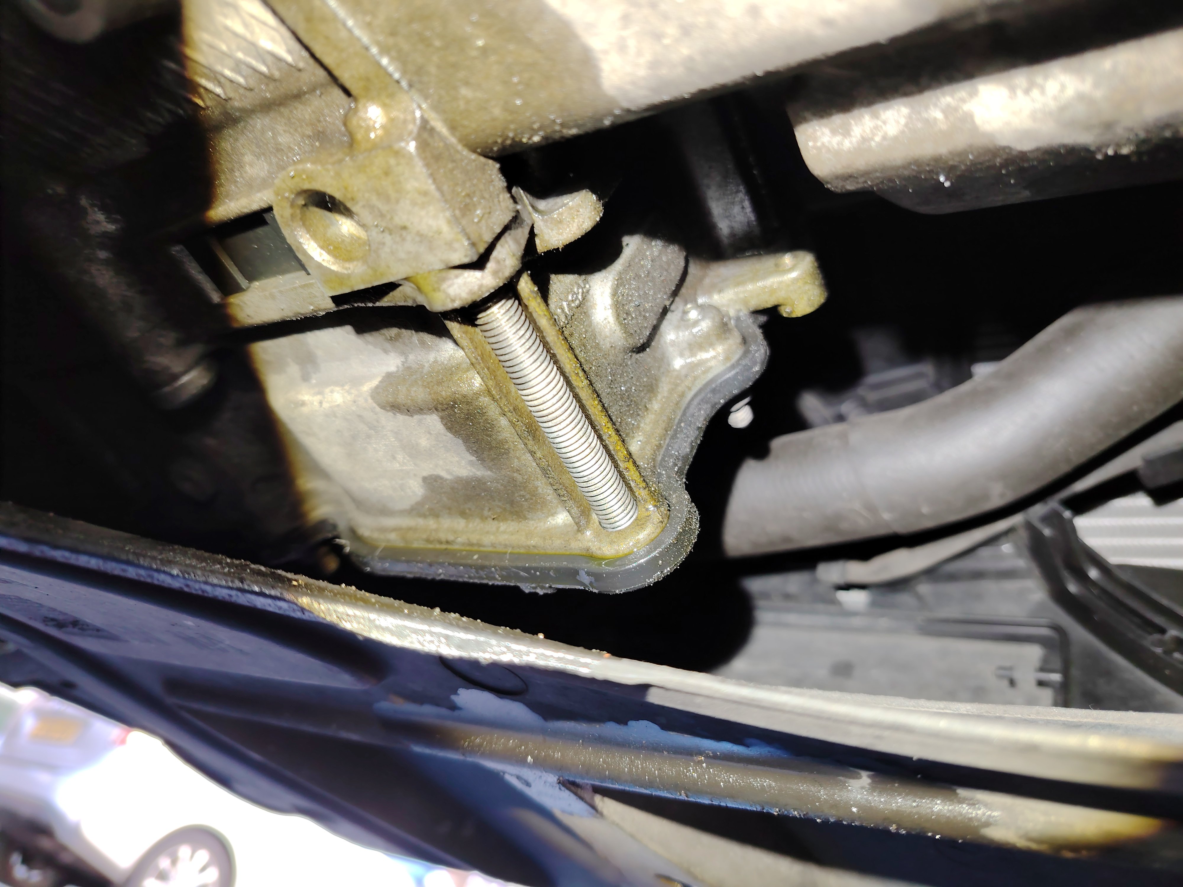

1st one is gear specialist shop... I had the car taken to the 2nd mechanic. After inspecting the car, he said that it was gearbox oil overflowing.. There is no leaking from the gasket he fixed. He said that he might have topped up with too much fluid while he did replace the gasket. Well, he gave it a good clean with spray and asked me to keep an eye.. If still there is oil leaking then he will do further investigation.

I'll get it checked out soon. But mechanic shouldn't be doing that silly mistake especially when it was leaking already. Anything else that anybody can think of? Do I need to consider replacing mechatrone to fix the problem?

The second mechanic has replaced dq200 with new gasket. What else could be done to fix the problem? There is no damage in the mechatrone.

Apparently, I had the mechatronic sealed in a professional gearbox repair shop almost 10months ago.. Then I realised that it didn't stop oil from leaking. So, few months ago I came across a mechanic who seems to be an expert in DSG gear. I showed him the car and he suggested resealling will cure it as the oil is not leaking from the breather. Well, once he took the mechatrone out we found out the previous guy used silicone to seal.. So this guy used proper rubber to seal and advised me that mechatrone sealling by the silicone wasn't good idea.. It has to be proper sealling rubber. Anyway, recently during seevice i saw a lot of oil leaking from all over the gear box. Could someone advise me, how can i fix it once and for good. Did anyone go through similar issue? Car is Octavia 2017 1.4tsi. N. B: There is no fault code or any problem with the gearbox. Mileage is 137k.
