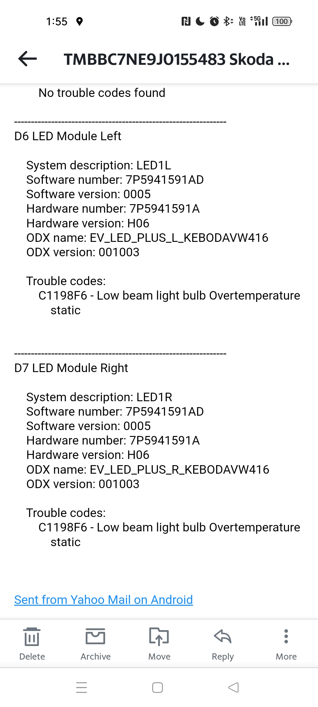

  2. What is Adaption map? Where can i find 4b? Following is the scan results of 09 09 Central Electrics System description: BCM MQBAB M+ Software number: 5Q0937084CP Software version: 0253 Hardware number: 5Q0937084CF Hardware version: H36 Serial number: 01001723702021 ODX name: EV_BCMMQB ODX version: 018001 Long coding: 000000000000000000000000000000000000000000000000000000000000 Subsystems: System description: WWS371 170628 Software version: 0915 Hardware version: 051 Serial number: 887253F0401717901087 Long coding: 164DDD System description: RLHS Software version: 0105 Hardware version: 047 Serial number: S9Y17M08D31H21M34S36 Long coding: 00885D System description: Sensor, DWA Software version: 0316 Hardware version: 005 Serial number: 000000000ZY171431WXQ System description: Sirene, DWA Software version: 0314 Hardware version: 005 Serial number: 00002856223971443259 Trouble codes: No trouble codes found

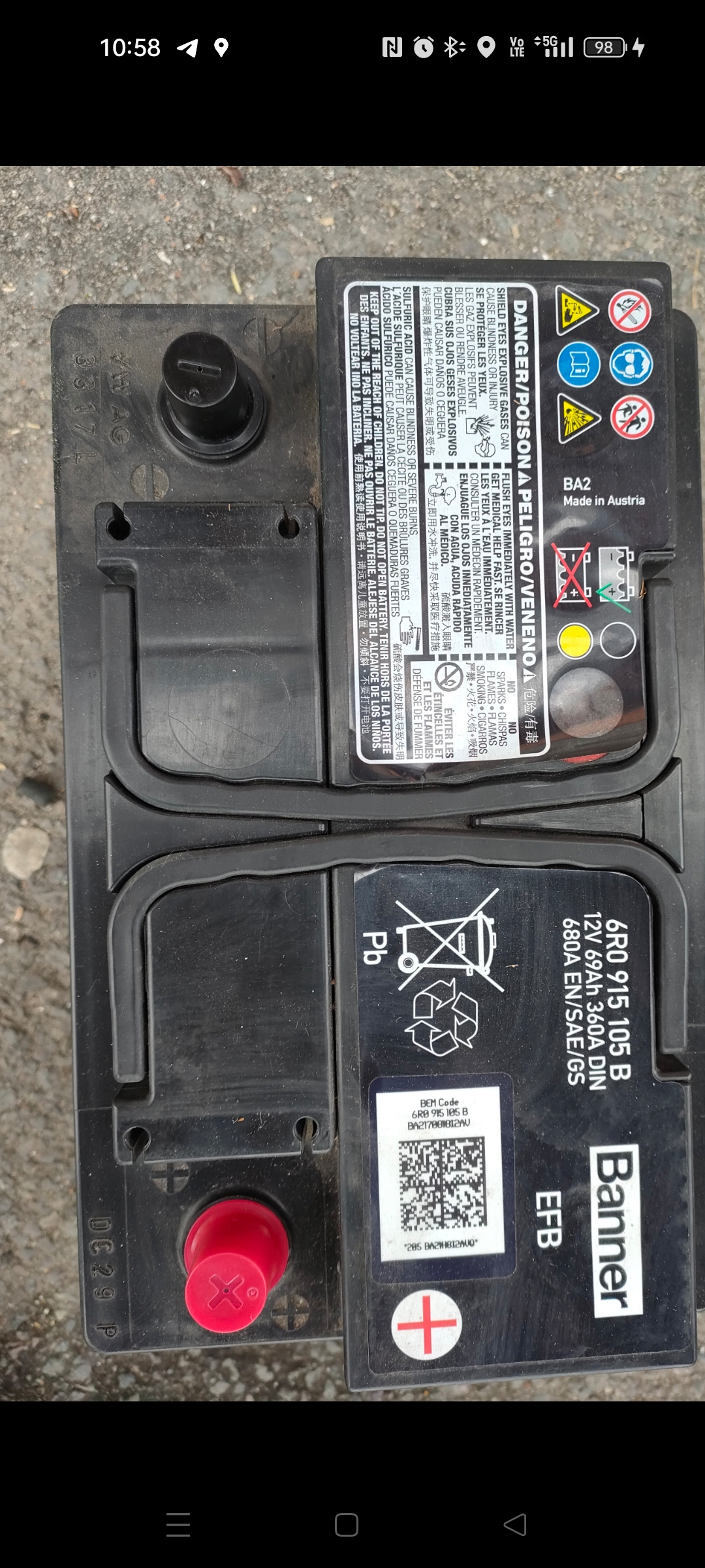

  7. This is the original battery.
  8. It was strange fault! As i said during start-stop dash cam didn't work and mobile used to reconnect for charging every time i had stop and starts.. Battery i have now is ok as per halfords website but it is just 65ah. If my car allows i would prefer to go more powerful one. Halfords guy said my car can not handle 75ah battery..that's what i need to find out whether 75ah is ok for my car or not.

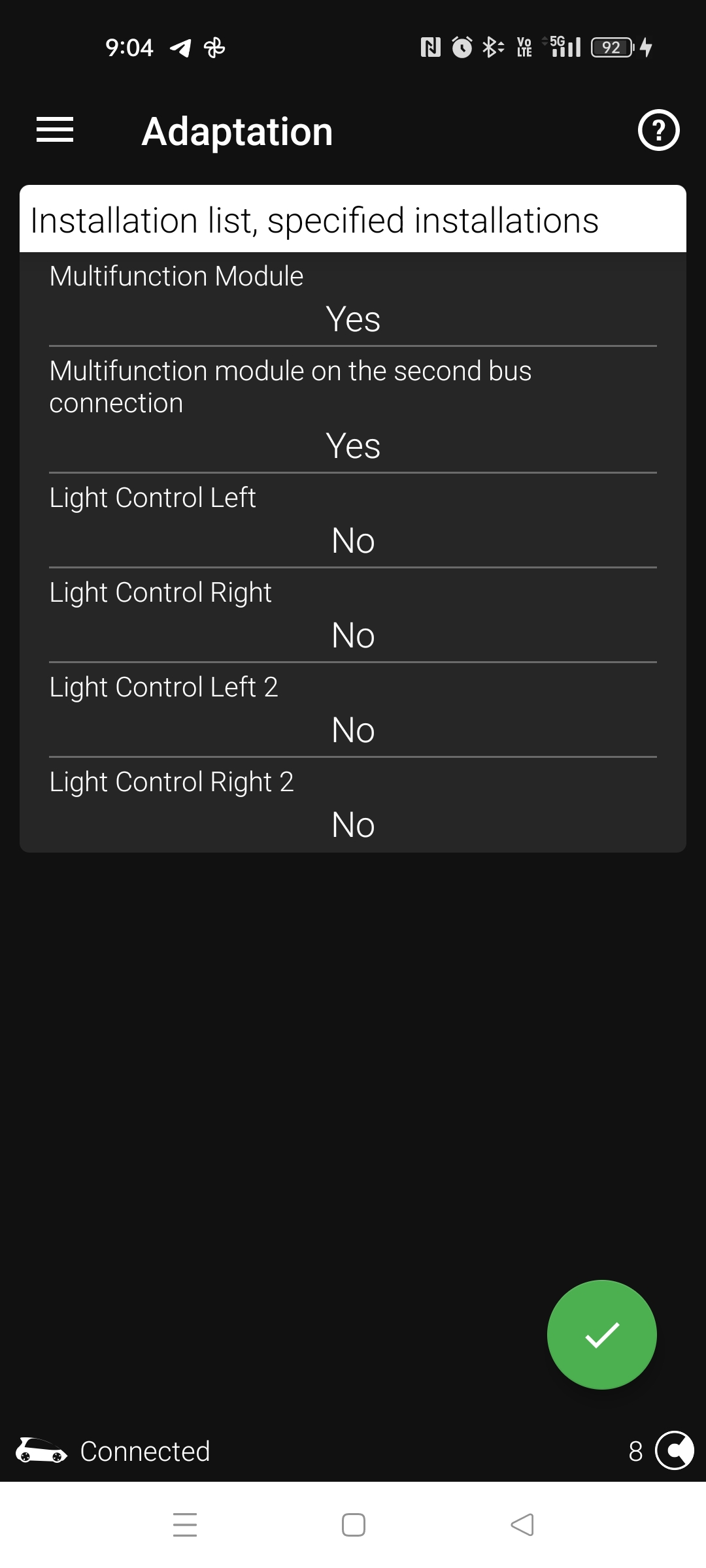

  9. @langers2kjust wondering what is Light Control Left Light Control Right for? I have changed light control left 2 and light control right 2 what are those other two for. Now back to the original post Battery has been stressed tested to check if alternator is working or not. Result came as Alternator works fine.. So there is no other problem in the car. It was the battery itself damaged by constant draining out by dash cam which was connected toa faulty USB charger..now my concern is this smaller battery..i really don't like it. even these garage people saying it is way too small for my car. So what can I do with this smaller battery from Halfords!

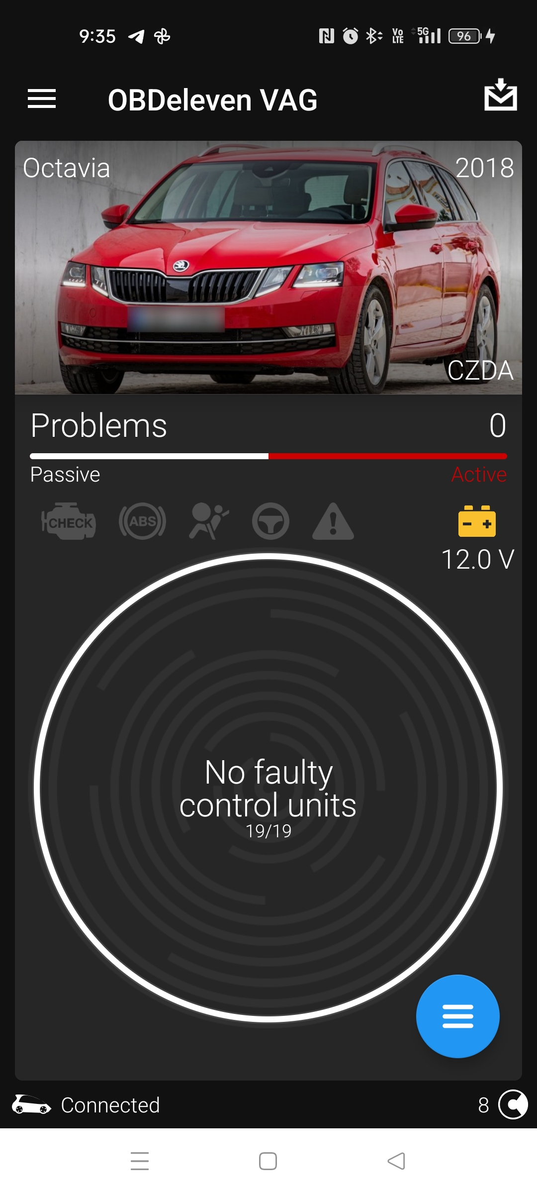

  10. wow..wow..this fault has gone away. Check the scan result..I am so thankful to you langers2k. I owe you drink...

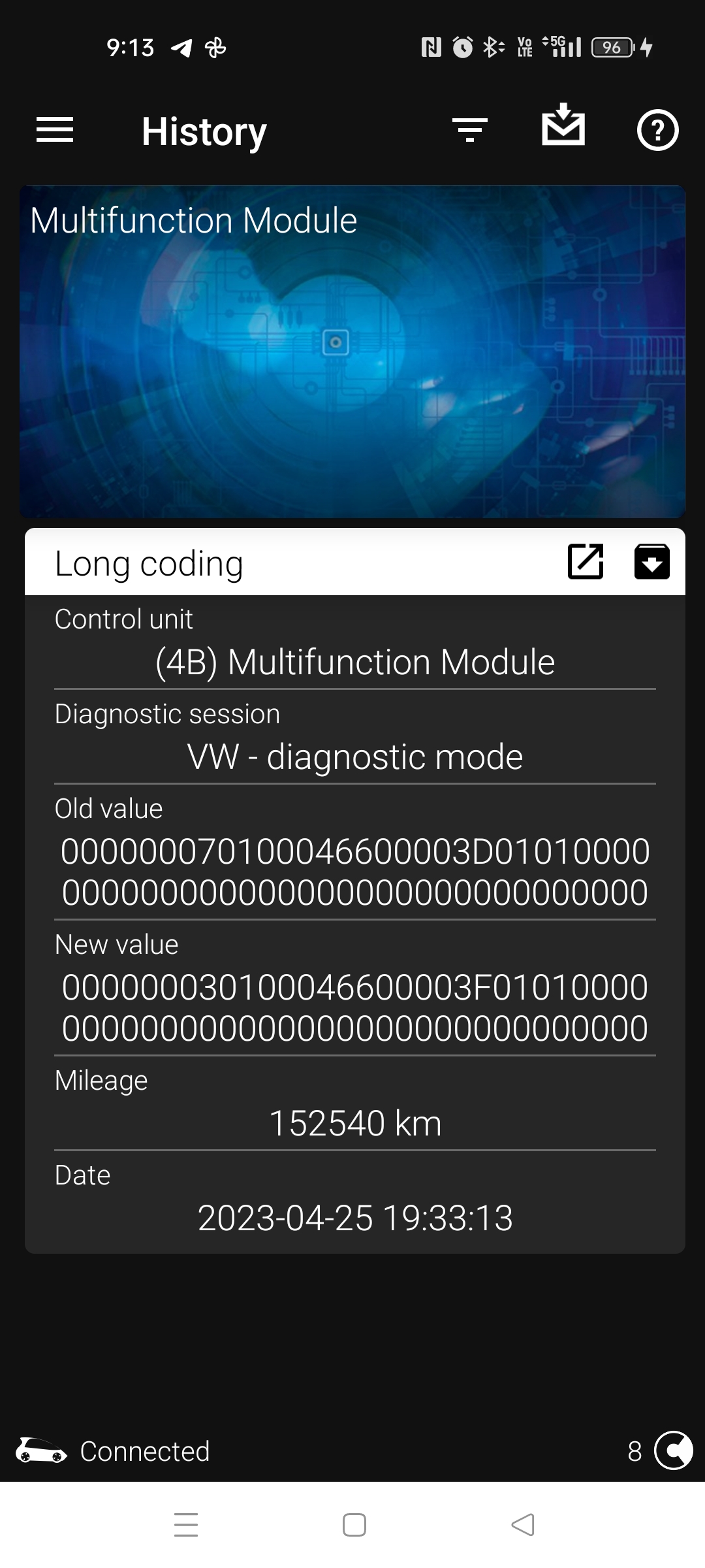

  11. Just want to share this history as well in case it helps.

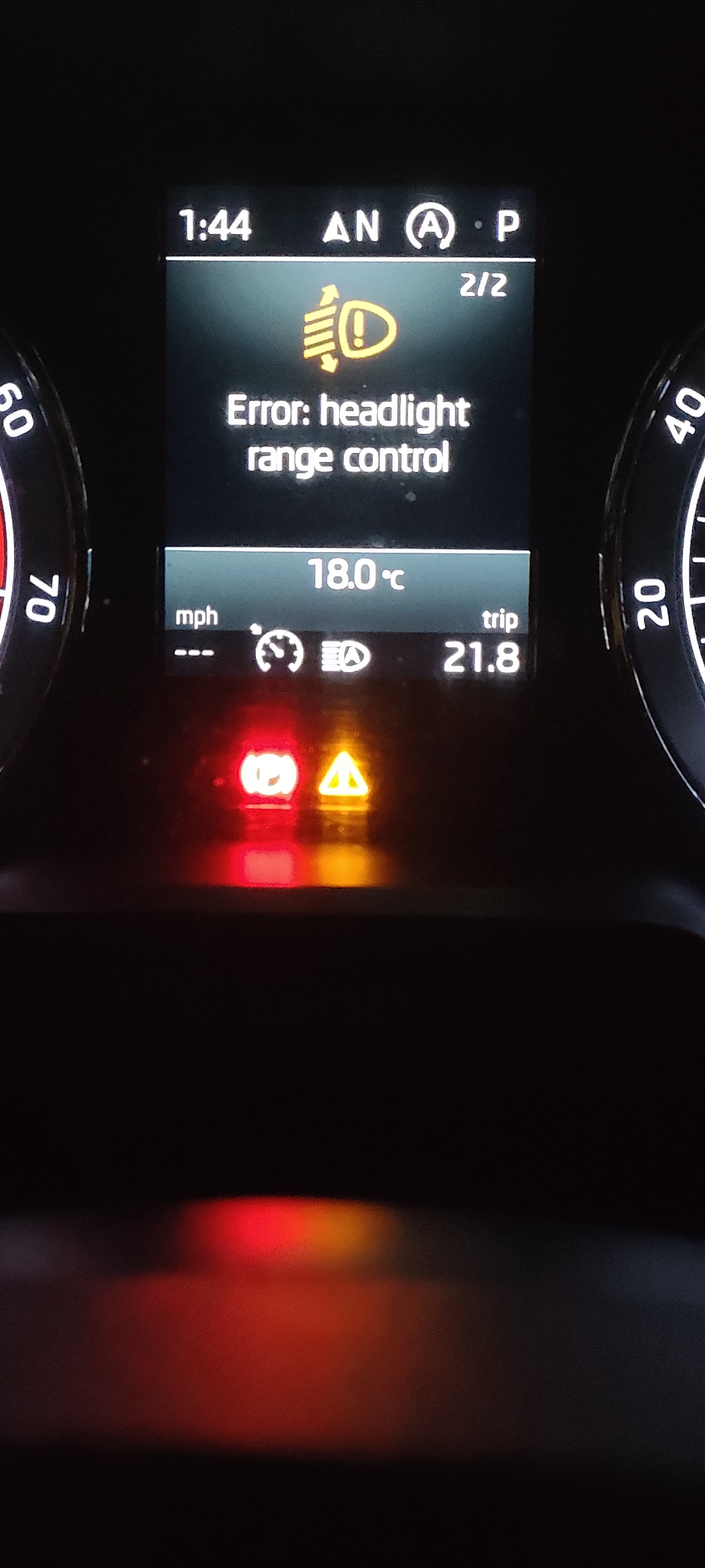

  12. Yes, "Additional installation detected" wasn't going away. Well, I changed the long code back to where it was. I can change the code again if you want me to as i know how to do basic setting to get rid of Error: headlight range control. See the pic of screenshot

  14. I have done it and code was accepted but no luck of getting rid off that fault code. Headlight range control warning popped up but I was able to sort it out by basic settings..I am at least happy for that.

  20. Graham, what information do you need for you to check that my car has LED front and back. When the car was advertised in carshop website it clearly stated about LED and then i cross checked before travelling to Manchester to buy it. I had 1.6tdi same car with halogen ..only reason to upgraded it was LEDs N.B: I might be ignorant about too details of technical information of a car but not that much who can not identify halogen and LED .

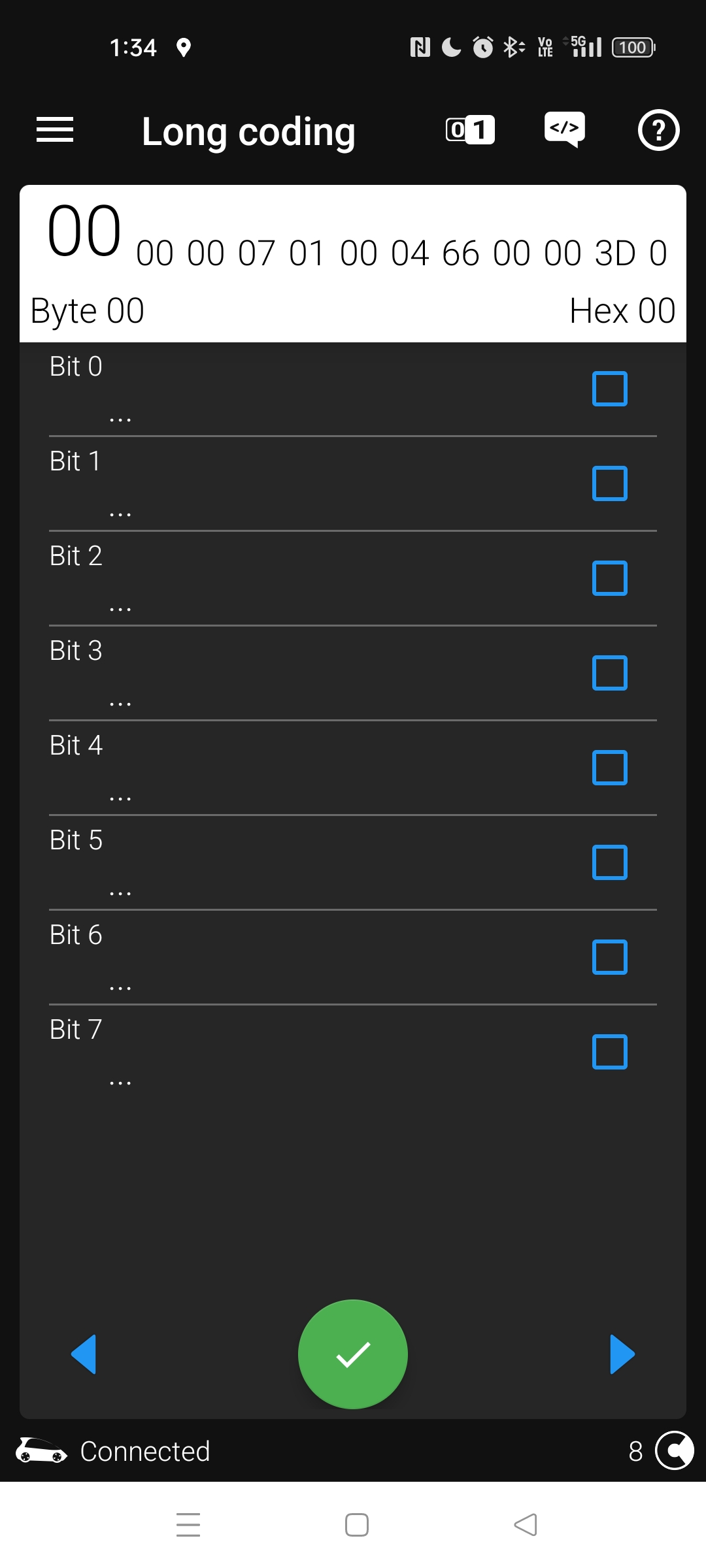

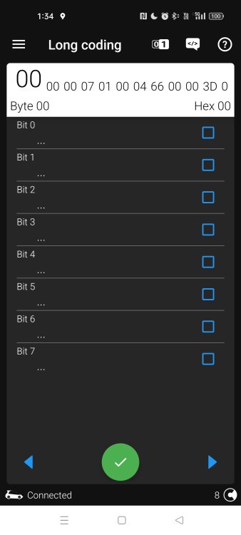

  21. I can copy and paste this long code.i tried to paste it and it works ..but I am scared to do it..previously i tried to fix this problem by changing/toggling options and it brought head light range fault on the maxidot display..
  22. I can see, it is same option like i mentioned..LED enabling and disabling..look at these screenshots.
  23. That's what i can see once i clicked on the top right as you highlighted.
  24. I wouldn't know where to input this code. Here in obd i just have toggling option. I wen to backup but it seems it will try to do back up once i click..but i didn't.
