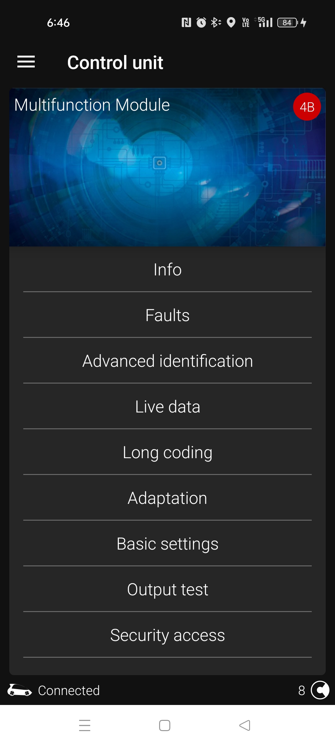

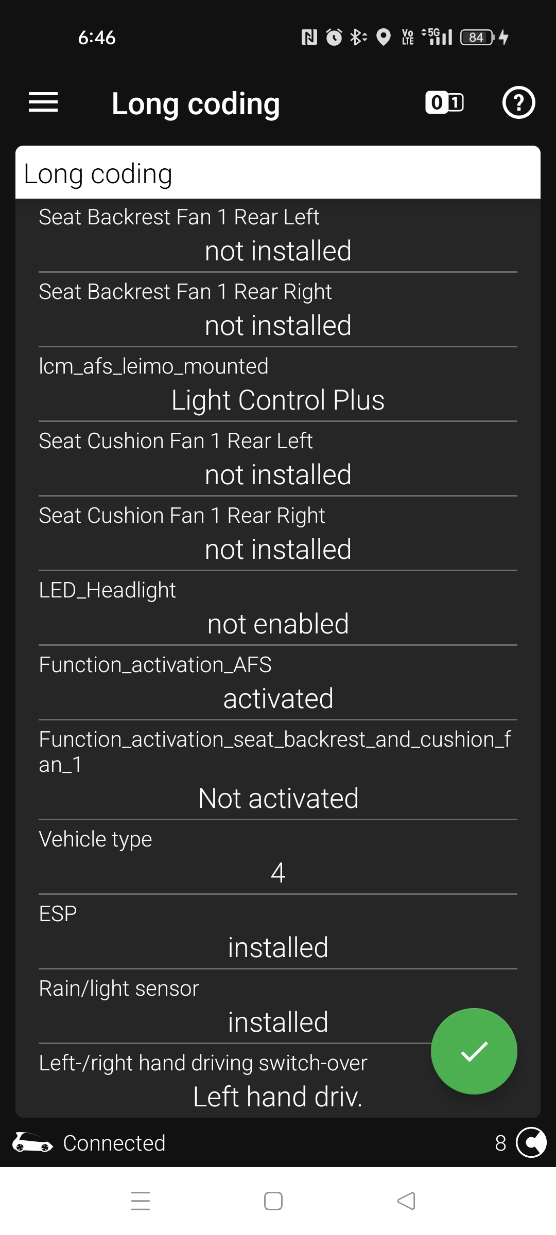

  1. I can see something incorrect to me here in long coding in Multicunction module LED Headlight: Not enabled. Just wondering if i change it to enable what may happen?
  2. The link i pasted on the post abobe, I think stephan did the setting unchecked from 19 gateway which cleared his faults. I did some changes in 19 Gateway as well while playing with headlight basic settings (someone recommended me here in this forum while i had headlight issue) , probably thats where I need to go back to change the settings or uncheck something which i don't know .

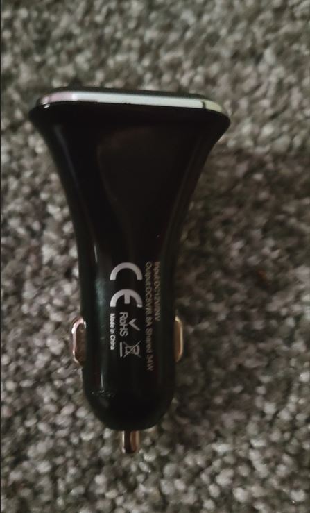

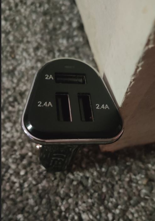

  9. Thanks everybody for trying to help me pin pointing the problem. guys, no body mentioned about the USB Charger. Can it not cause all the problems ( in case it has come in contact with liquid when dash cam and mobile charger cables were conneted). Today I used another spare USB charger after cleaning the 12v port with electrical contact cleaner spray and surprisingly noticed that my dash cam is not getting powered off with start-stop which was not the case with usual USB charger (which was always connected in the port). Now with this new battery, it is working fine with start-stop. but couple of times there were start-stop error occured. Diagnostic detected cyl3 and random misfire. I know already if there is start-stop error, there must be misfire detected which is always the case in my car. after restarting the car the problem goes away and start-stop works normal. Anyway, I think I'll have my car checked up with local electrician who is expert on battery, alternator, start-stop problem and so on. I know for sure there is no electrical problem in my car, but well, those two modules (accidently activated) were always bugging me. who knows if they were draining the battery as someone already suggested here. following are the dignostic result underneath if anyone knows how to disable those two modules. OBDeleven data log Date: 2023-09-03 12:36 VIN: TMBBC7NE9J0155483 Car: Skoda Octavia Year: 2018 Body type: Estate Engine: CZDA Mileage: 168519 KM --------------------------------------------------------------- 01 Engine System description: R4 1.4l TFS Software number: 04E906027HD Software version: 3742 Hardware number: 04E907309BH Hardware version: H26 ODX name: EV_ECM14TFS01104E906027HD ODX version: 001007 Long coding: 01250032232401080000 Trouble codes: P030000 - Random/Multiple Cylinder Misfire Detected static Date: 2023-09-03 12:22:24 Mileage: 168517 km Priority: 2 Malfunction frequency counter: 1 Unlearning counter: 255 Engine speed: 684.50 1/min Normed load value: 14.9 % Vehicle speed: 0 km/h Coolant temperature: 79 °C Intake air temperature: 60 °C Ambient air pressure: 1020 mbar Voltage terminal 30: 12.557 V Dynamic environmental data: 20965011BE001313F47D35F40685F4464610D3000114B409C4 P030300 - Cyl.3 Misfire Detected static Date: 2023-09-03 12:23:45 Mileage: 168517 km Priority: 2 Malfunction frequency counter: 1 Unlearning counter: 255 Engine speed: 684.50 1/min Normed load value: 14.9 % Vehicle speed: 0 km/h Coolant temperature: 79 °C Intake air temperature: 60 °C Ambient air pressure: 1020 mbar Voltage terminal 30: 12.557 V Dynamic environmental data: 209650F44643F40B571010039814B409C411990F3617460001432100 --------------------------------------------------------------- 02 Transmission System description: GSG DQ200G2_M Software number: 0CW300041B Software version: 1006 Hardware number: 0AM927769E Hardware version: H05 Serial number: CU501708186136 ODX name: EV_TCMDQ200021 ODX version: 001001 Long coding: 0014 Trouble codes: No trouble codes found --------------------------------------------------------------- 03 Brakes System description: ESC Software number: 5Q0614517AM Software version: 0312 Hardware number: 5Q0614517AB Hardware version: H25 Serial number: 62267000000730 ODX name: EV_Brake1UDSContiMK100ESP ODX version: 036010 Long coding: 24078A9124252171407B060840C6242451248402600224723021F070C002430000000012121212B8586C384E4484EE Trouble codes: No trouble codes found --------------------------------------------------------------- 08 Air Conditioning System description: Climatronic Software number: 5E0907044AP Software version: 2001 Hardware number: 5E0907044AP Hardware version: H04 ODX name: EV_ACClimaBHBVW37X ODX version: 006146 Long coding: 0111000400011001100500080010102A Trouble codes: No trouble codes found --------------------------------------------------------------- 09 Central Electrics System description: BCM MQBAB M+ Software number: 5Q0937084CP Software version: 0253 Hardware number: 5Q0937084CF Hardware version: H36 Serial number: 01001723702021 ODX name: EV_BCMMQB ODX version: 018001 Long coding: 000000000000000000000000000000000000000000000000000000000000 Subsystems: System description: WWS371 170628 Software version: 0915 Hardware version: 051 Serial number: 887253F0401717901087 Long coding: 164DDD System description: RLHS Software version: 0105 Hardware version: 047 Serial number: S9Y17M08D31H21M34S36 Long coding: 00885D System description: Sensor, DWA Software version: 0316 Hardware version: 005 Serial number: 000000000ZY171431WXQ System description: Sirene, DWA Software version: 0314 Hardware version: 005 Serial number: 00002856223971443259 Trouble codes: No trouble codes found --------------------------------------------------------------- 13 Adaptive Cruise Control System description: ACC BOSCH MQB Software number: 5Q0907572J Software version: 0654 Hardware number: 3QF907572 Hardware version: H10 ODX name: EV_ACCBOSCHVW416 ODX version: 002006 Long coding: 3300608141FFC728949C810500400600000000000000000000 Trouble codes: No trouble codes found --------------------------------------------------------------- 15 Airbag System description: Airbag VW21 Software number: 3Q0959655BH Software version: 0703 Hardware number: 3Q0959655BH Hardware version: 006 Serial number: 003W4PGL3JQK ODX name: EV_AirbaVW21TS6VW48X ODX version: 001014 Long coding: 98CCC000000000005C5400CC008800000065 Subsystems: System description: SideSensor_Df Software version: 0887 Hardware version: 008 Serial number: 3570000000055099982J Long coding: 2D2D2D System description: SideSensor_Pf Software version: 0887 Hardware version: 008 Serial number: 35800000000A7794082K Long coding: 2D2D2D System description: SideSensor_Dr Software version: 0148 Hardware version: 301 Serial number: 35100BEB2D610000000O Long coding: 2D2D2D System description: SideSensor_Pr Software version: 0148 Hardware version: 301 Serial number: 35200C5B70611000000A Long coding: 2D2D2D System description: FrontSensor_D Software version: 0149 Hardware version: 304 Serial number: 3550027C7C710000000I Long coding: 2D2D2D Trouble codes: No trouble codes found --------------------------------------------------------------- 16 Steering Column System description: Lenks.Modul Software number: 5Q0953521T Software version: 0235 Hardware number: 5Q0953569A Hardware version: 075 Serial number: 20170826500580 ODX name: EV_SMLSVALEOMQB ODX version: 001015 Long coding: 1410 Trouble codes: No trouble codes found --------------------------------------------------------------- 17 Dashboard System description: KOMBI Software number: 5E0920950F Software version: 0310 Hardware number: 5E0920950F Hardware version: 303 ODX name: EV_DashBoardVDDMQBAB ODX version: 009060 Long coding: 27AD02082980860001887B011001000000000000 Trouble codes: No trouble codes found --------------------------------------------------------------- 19 Gateway System description: GW MQB High Software number: 3Q0907530G Software version: 4303 Hardware number: 3Q0907530C Hardware version: 433 Serial number: 0006646371 ODX name: EV_GatewNF ODX version: 013023 Long coding: 030100047F085700EB00024A1C0F00010001070000000000000000000000 Subsystems: System description: J367-BDMConti Software version: 1050 Hardware version: H03 Serial number: 7588600000170828067D System description: E221__MFL-PR6 Software version: 0160 Hardware version: H02 Serial number: 000000000C1816180817 Trouble codes: No trouble codes found --------------------------------------------------------------- 20 High Beam Assistance System description: FLA Software number: 3G0857511G Software version: 0003 Hardware number: 3G0857511G Hardware version: H10 ODX name: EV_HighBeamAssisAU33X ODX version: 001017 Long coding: 0404010700000100000000 Trouble codes: No trouble codes found --------------------------------------------------------------- 42 Driver Door System description: TSG FS Software number: 5Q4959593E Software version: 0032 Hardware number: 5Q4959593B Hardware version: 011 Serial number: 0000274068925 ODX name: EV_DCUDriveSideEWMAXCONT ODX version: 006001 Long coding: 00110020D001040000001100 Subsystems: System description: FOND_FHSG_DRV Software version: 0007 Hardware version: 006 Serial number: 00000000000015935588 Long coding: 1D0200 Trouble codes: No trouble codes found --------------------------------------------------------------- 44 Steering Assistance System description: EPS_MQB_ZFLS Software number: 5Q0909144T Software version: 1072 Hardware number: 5Q0909144R Hardware version: 129 ODX name: EV_SteerAssisMQB ODX version: 013144 Long coding: 8107 Trouble codes: No trouble codes found --------------------------------------------------------------- 4B Multifunction Module System description: FCM MQB Low Software number: 3Q0907338 Software version: 0286 Hardware number: 3Q0907338 Hardware version: 002 Serial number: 29081710801494 ODX name: EV_MultiModulContiVW48X ODX version: 001010 Long coding: 000000030100046600003F01010000000000000000000000000000000000 Trouble codes: U12EB00 - Data bus front light Additional installations detected static Date: 2023-09-03 02:02:10 Mileage: 168493 km Priority: 2 Malfunction frequency counter: 34 Unlearning counter: 141 Unknown ambient data: 7C0000008000 --------------------------------------------------------------- 52 Passenger Door System description: TSG BFS Software number: 5Q4959592E Software version: 0032 Hardware number: 5Q4959592B Hardware version: 011 Serial number: 0000272554428 ODX name: EV_DCUPasseSideEWMAXCONT ODX version: 006001 Long coding: 00110020D001040000001100 Subsystems: System description: FOND_FHSG_PSG Software version: 0007 Hardware version: 006 Serial number: 00000000000015998943 Long coding: 050200 Trouble codes: No trouble codes found --------------------------------------------------------------- 5F Multimedia System description: MU-S-ND-ER Software number: 5Q0035874C Software version: 0480 Hardware number: 5Q0035874C Hardware version: H41 Serial number: SKZAZ2T5337681 ODX name: EV_MUStd4CTSAT ODX version: 001022 Long coding: 03730101FF00000051111201008800002F0208C601200500CF Subsystems: System description: ABT_Std-2_Nav Software version: 8130 Hardware version: H50 Serial number: SKZ6ZHT1871718 System description: ECE DL2 2023 Software version: 1910 Hardware version: --- Serial number: -------------------- Trouble codes: No trouble codes found --------------------------------------------------------------- 76 Parking Assistance System description: PDC 4 Kanal Software number: 5QA919283B Software version: 0044 Hardware number: 5QA919283 Hardware version: H07 Serial number: 00030841961722901935 ODX name: EV_EPHVA14AU3700000 ODX version: 009033 Long coding: 0601050011 Trouble codes: No trouble codes found --------------------------------------------------------------- D6 LED Module Left System description: LED1L Software number: 7P5941591AD Software version: 0005 Hardware number: 7P5941591A Hardware version: H06 ODX name: EV_LED_PLUS_L_KEBODAVW416 ODX version: 001003 Trouble codes: No trouble codes found --------------------------------------------------------------- D7 LED Module Right System description: LED1R Software number: 7P5941591AD Software version: 0005 Hardware number: 7P5941591A Hardware version: H06 ODX name: EV_LED_PLUS_R_KEBODAVW416 ODX version: 001003 Trouble codes: No trouble codes found

  23. I have found how to code battery by OBDeleven. Information there I can see, seems wrong to me. Especially Rated battery capacity..it says 69Ah, but my battery capacity is 75Ah, Serial number i managed to check from the side of the battery is 10528018, but in the coding is totally different. battery manufacturer i am not sure. Could someone check if the coding/info is right or wring. The battery i bought was EFB096 from halfords .
