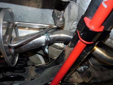

  2. πŸ‘ Appreciated This is the sequence that worked for me.......suspend the main box from the exhaust hangers (I used Jubilee clips / washers to hold it in place).......fit the front section with the re-usable red side supports on to the cross strut, seal with firegum and U bolt clamp fully tight........ fit the centre section, first fit one end into the main box inlet ( you will have to tilt the main box about to get the ends to line up, the other end will then slide easily onto the front section, secure, finally fit tail pipe and enjoy.

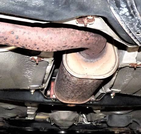

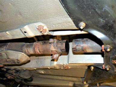

  4. Well finally got round to fitting the new exhaust. Before cutting through the inline exhaust clamp I supported the CAT with a axle stand to minimize moving the flexable section post turbo. I cut through the clamps with my Dremel fitted with a cutting disc. When the wrap round ajustable sleeve was slid along towards the front of car it exposed a gap between pipe ends of about 25mm. Using the exhaust pipe cutter (looks like a mole wrench with a short chain that has hardened cutting wheels mounted in the chain), I cut through the exhaust pipe close to the main box. This enabled me to remove both sections of the old system. I then used some emery paper and removed sharp edges on the ends of the new system, degreased it using brake and clutch cleaner, fitted it togerther together to check for fit, all ok. Took it apart and using Firegum to coat the ends, fitted it together using supplied chrome plated U bolts, nuts and washers. Left it overnight for the firegum to harden and this morning started car and left it running on tickover to warm up. Then took it for a slow drive, its a bit louder than than std with a slightly deeper sound. Dean before you say anything πŸ˜„ I think I prefer the subtle sound, its a old boy thing πŸ˜‰

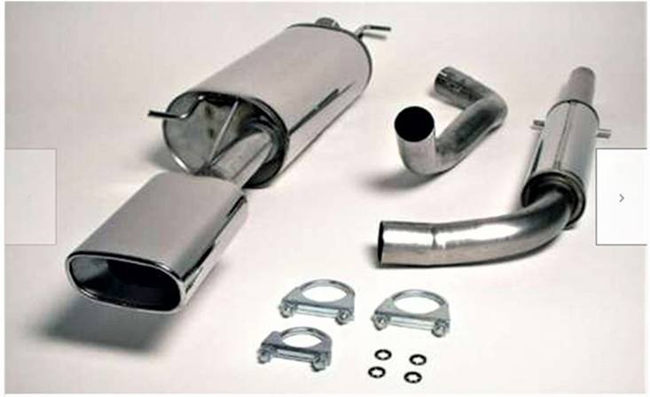

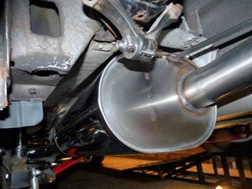

  7. The other day after taking some rubbish to the tip. On the return journey gave it the beans on the duel carriageway to clear out the cobwebs and noticed it sounded a bit more raspy than normal. Put it up on the ramps and had a poke around then noticed the split on the right side of the pipe exiting the centre box, (the system is original not bad for 17 years old!!!). So bit the bullet and ordered a shiny Jetex S/Steel Resonated Cat-Back System. just waiting for the weather to cool down so I can fit it. Also got a exhaust pipe cutter just incase of any problems when removing the old exhaust, plus a new tube of solvol autosol 😁

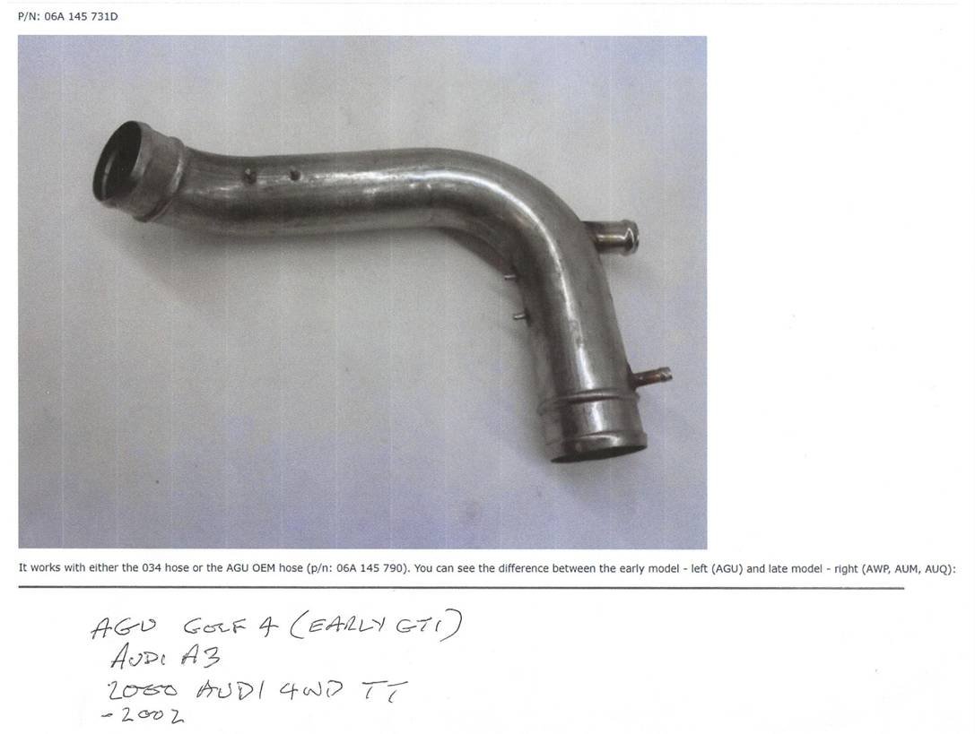

  13. Hi, Yes having got fed up with constant pressure loss and once even having the pipe join parting company resulting in total power loss. I went on e-bay and sourced (06A 145 731D). It is used on the early models of the following :- AGU Golf MK4 , Audi A3 and 2000 Audi 4wd TT It is identical to the existing one except instead of having that stupid join has a normal bead that a silicone hose clamps over. Sadly they are quite rare to find now, I ended up buying mine from someone in Germany. I also bought a new silicone hose to link it to the pancake pipe from Creation Motorsport (part No: AGU ARZ H188). You have to reduce the hose length slightly when fitting, it is a bit of a struggle but can be done (the car front needs to be on ramps or a lift to enable access from underneath). NB: After swapping the pipe over I did notice it did seem a bit more lively, maybe my imagination??.

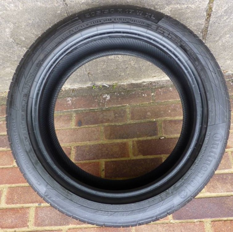

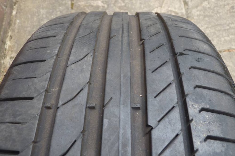

  15. FREE One used Contisport Contact 5 tyre (205/50 R17 93W XL . No punctures, tyre wall never scrubbed, has about 5.2 -5.5mm tread left. Collection only from Welwyn Garden City Hertfordshire

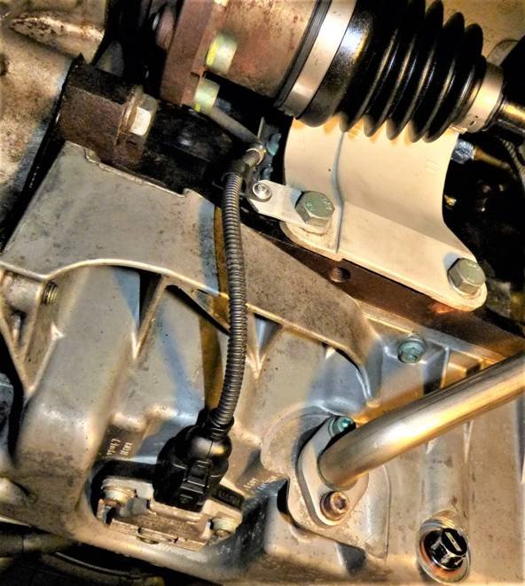

  17. When I was under the car the other day I noticed that the corrigated harness sleeve from the engine oil level / temp sensor ( 1J0 907660 C ) was breaking up and the retaining harness clip had also broken. I bought some new split sleeving from the Bay of E for about Β£3 (1 metre ). You need a I/D of 5mm with a O/D of 7.1mm. I also made up a small bracket and used a P clip to secure the harness in position (see pics). The length of the fitted sleeve is about 200mm. I also checked with my Multi meter that the current was getting through to the sensor. The corrigated sleeve end slids into some existing heat resistant sleeving further along then a tye-wrap to hold the two together.
  18. "tie-wraps or zip-ties. Most people understand both names". How very informative, you know what they say about a picture ? or maybe not πŸ˜‚

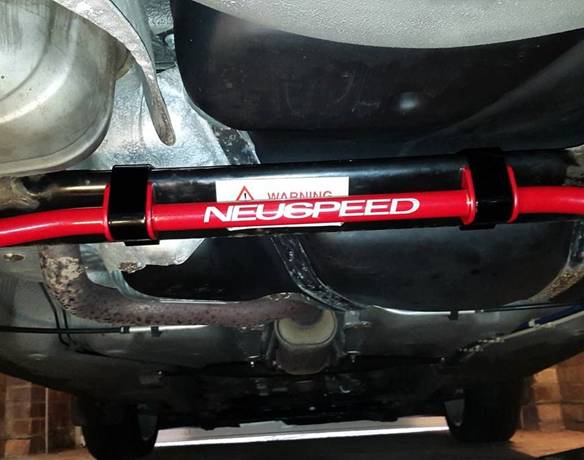

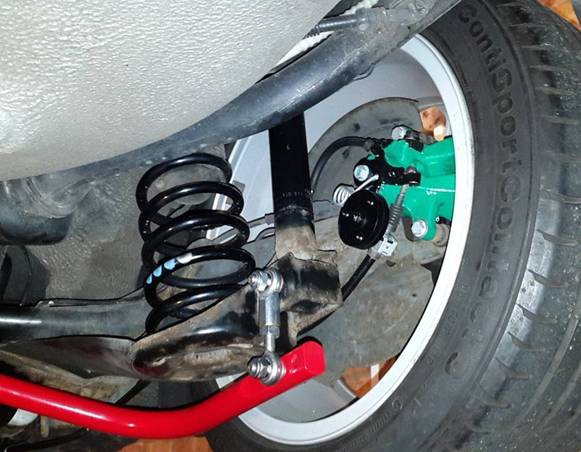

  19. Yes, the one you indicated will fit, the vrs shares a lot of golf mk4 parts and add on goodies from 3rd parties. The rear one is fairly easy to fit. When I got my vrs I bought and fitted a Whiteline 22mm on my own. They are quite heavy and a awkward shape to position. I got 2 Ty-wraps and propped the ARB against the cars rear suspension beam, secured it with the ty-wraps (not sure what you call them, see pic below), far apart on the rear beam. Then using supplied brackets secured it to the suspension beam, centralised its position, pivoted it upwards secured it using supplied bolts and link arms to the car suspension. You will get a fitting sheet when you get a new one. The improvement to body roll is like night and day. I recently swapped my Whiteline one out for a Newspeed one this year.

  24. Hi Andy, its a 28mm one, still have the front to do, i'm looking at a 23mm R32 one for the front.
  25. Just a couple of pics of my (finally fitted) new ARB. I have changed the fixing to the softest position (towards rear of car).
