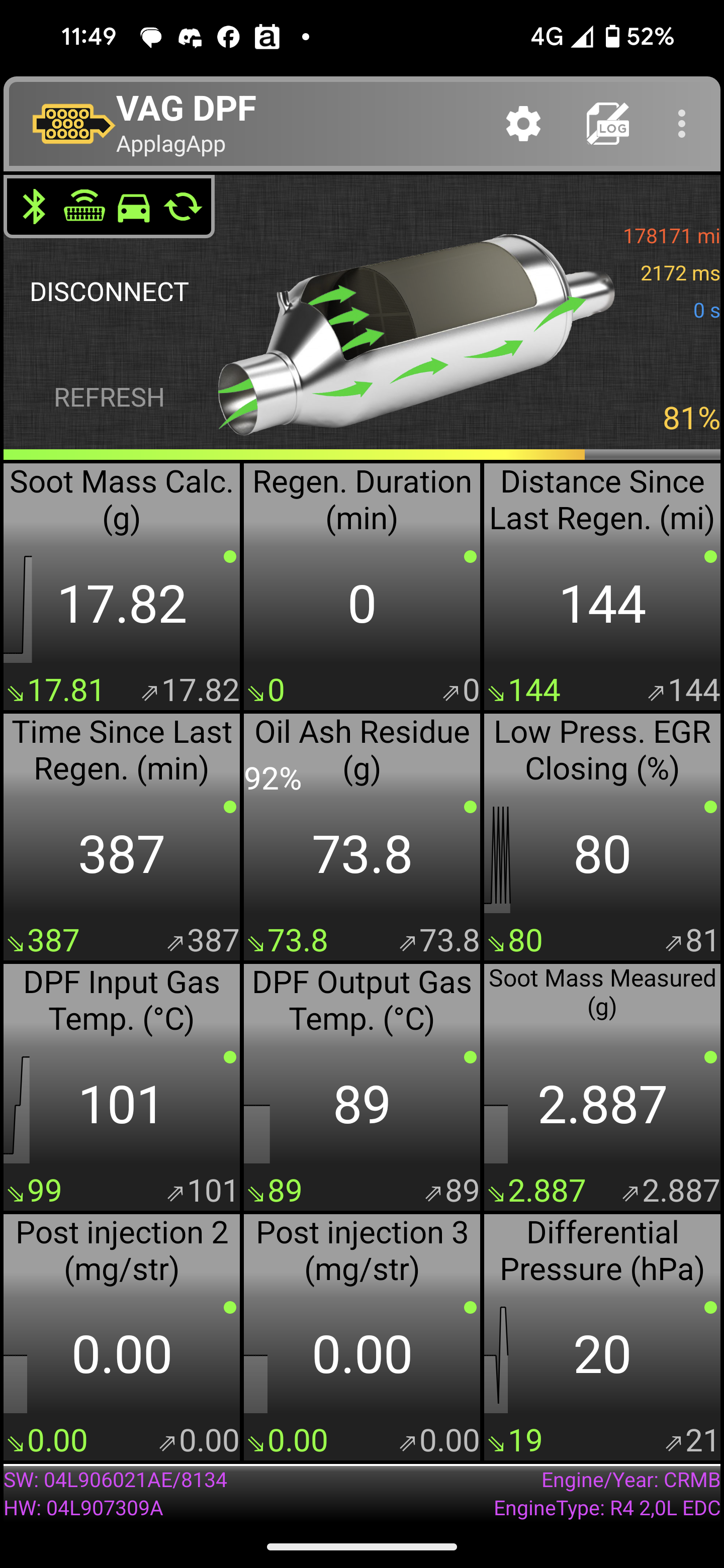

  9. OK I totally under estimated the mileage. 178k Also just bought the DPF app and it's showing 73.8g of ash and 92% full. Could this be causing the issues I've described?

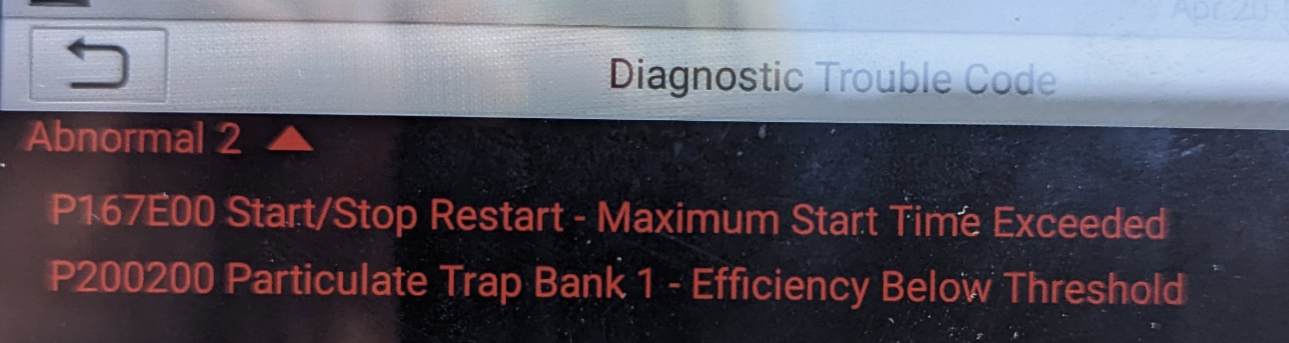

  11. Hi, I've have this Octavia for the last 6 or so years. Current mileage: 170k+ (might be 172 or 175 I can't remember lol) Have had the alternator refurbished and battery replaced in the last few years. Serviced every year with oil, oil filter, and fuel filter always changed. For the last year or so it's had random starting problems (a hard start every few weeks), it's always started but sometimes it will turn over a few too many times and seem like it won't start, and then it does. More recently it's happening now (like once a week, instead of every few weeks). On the most recent occurance it turned over maybe 10 plus times, then started and a small amount of smoke came from the exhaust. The dash also displays "start stop system unavailable" or "lane guidence unavailable". I read about dashcams causing battery problems and I installed one a few months ago, it's not hardwired, but stays constantly plugged into the USB port and only powers up when the car is switched on. I wondering if there's anything I can do / try / test before going to my mechanic. I've also attached a read out from car diagnostics that I had a friend just do. Thanks.

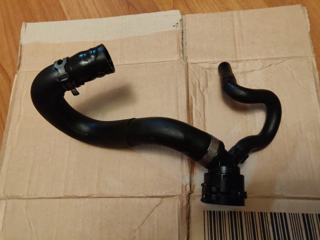

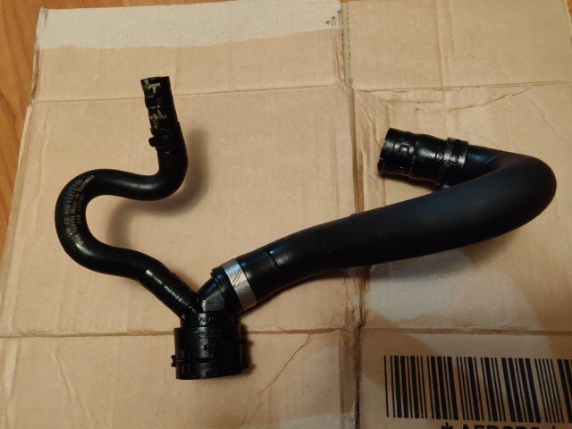

  14. Hey Stuart, All sorted now, had just bought the new matrix to fit myself (following the video of the guy fitting wrong first time lol) when the same pipe went again! Had to get recovered and brought to mechanic, so he fitted the new matrix, expansion tank and coolant pipe when they all arrived. The heat in the car is now warm within about 3-4 minutes of running vs when I bought the car I always thought it was slow to warm up the air. The silica bag has probably been leaking slowly for 3-4 years as this is a night and day improvement on heater warm up time.
