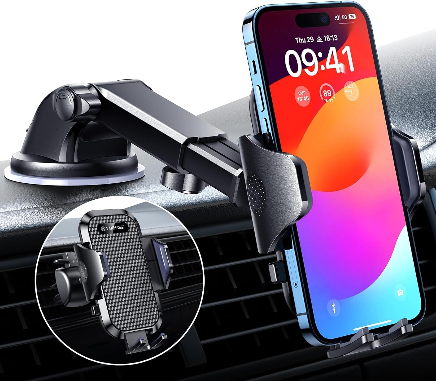

    I use one of these suction fitting on the dash-box lid, adds a little weight but still operable. Phone holder sits just over the top right corner of the RH vent. Been there for 2 months and hasn't come loose yet
