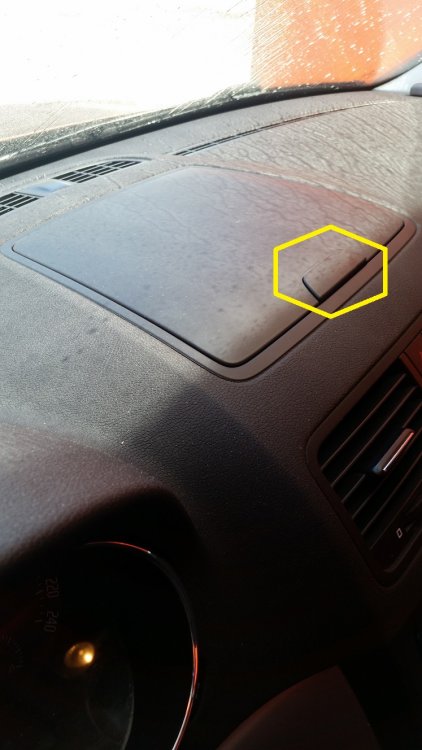

Hello,
on the dashboard there is storagebox which has button to open it.
sadly for some reason and some how, the button broke and i need to buy new button.
i searched the web and saw that i can't buy only the button but the whole storagebox.
the only places i found the storage box, are over at Russian sites (Which i don't speak, even though i used translator).
Can anybody help me with that?.
I'm looking for storagebox to replace the one in my car.
i don't care whether it's new or 2nd hand use.
It's Skoda Yeti 2012.

You should easily find a suitable car being broken on ebay. If they are advertising other parts worth an email to ask if they have a dash box available.
Its easily removed. Two screws at the front under the rubber mat. Lift the front and it just hooks in at the back.
I have had mine in and out several times as the TomTom is fitted into the box, so hidden when not in use.
