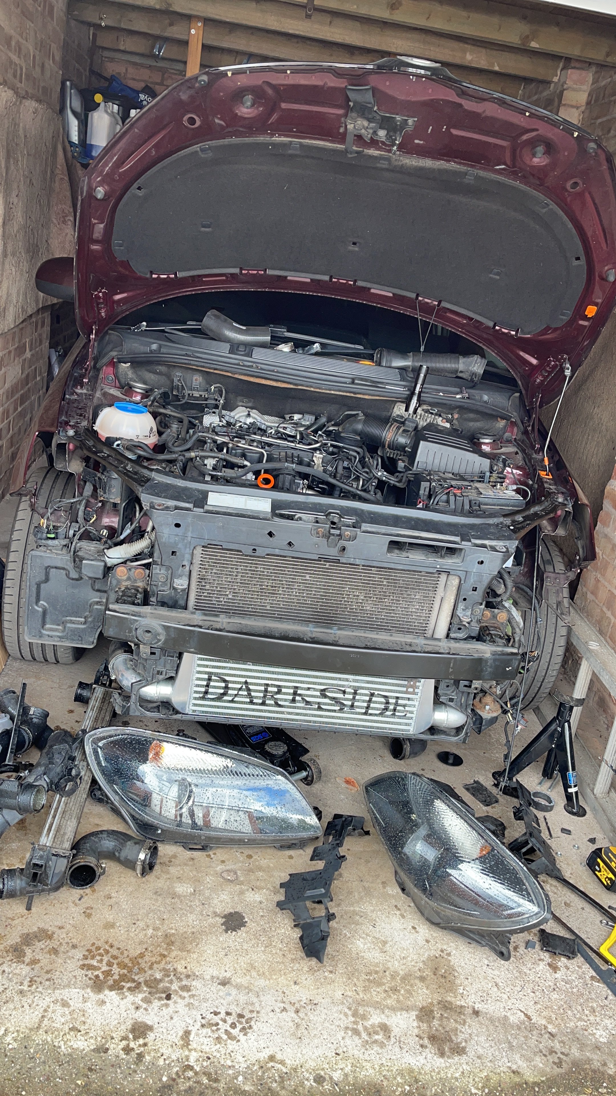

  9. I was like “huh” haha Yeah I am because I took it off to see if it sounded any better in the past and lost a few in the process of putting it back, no problem though

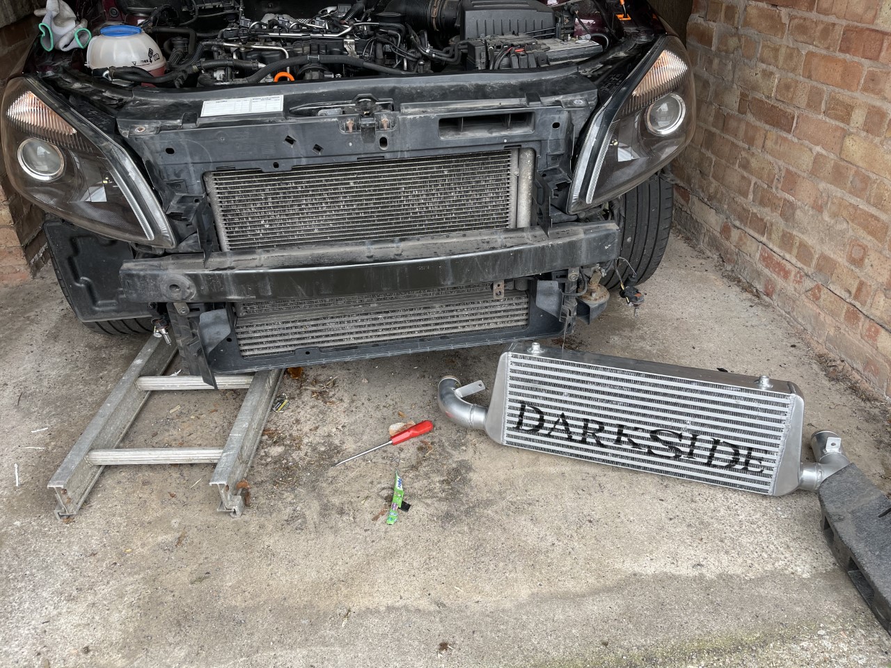

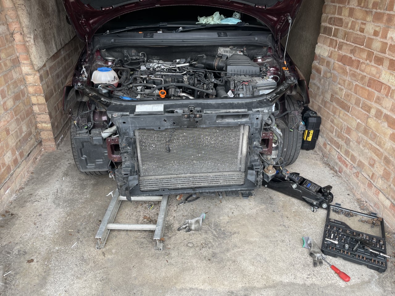

  12. Ahh, I should’ve pulled the whole radiator assembly up then. It’s the only thing missing from every fitting guide. Will have to give it a try

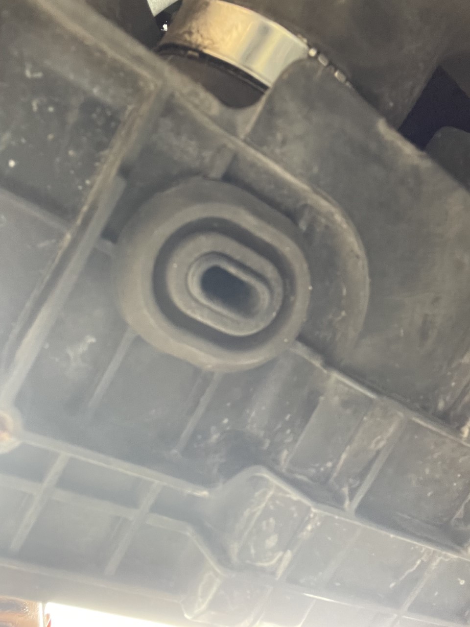

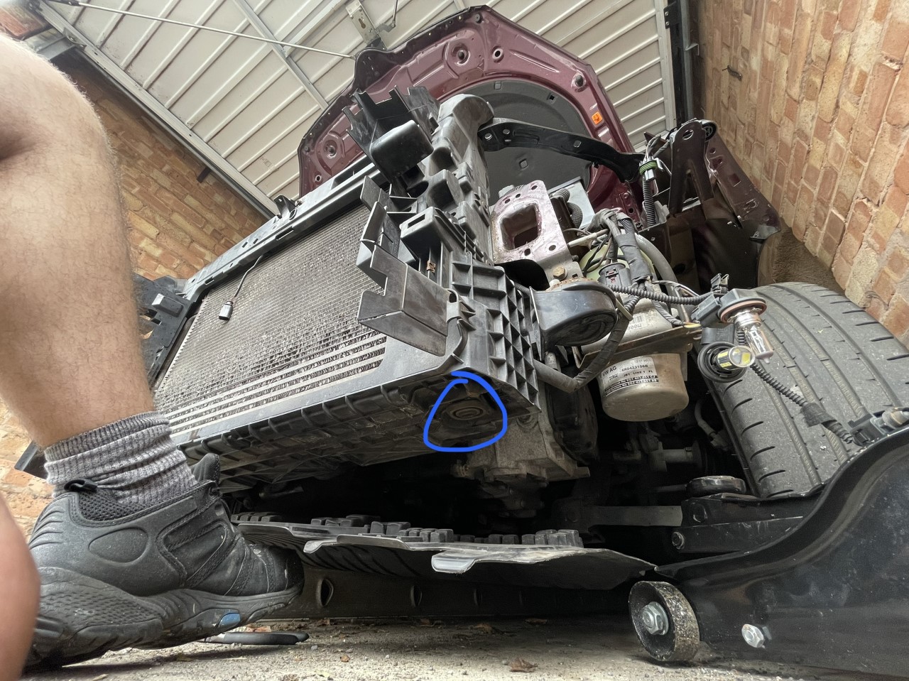

  13. Hi everyone, Over the weekend I attempted to fit my new Darkside intercooler but had to giveup ebcause I simply could not figure out how to remove the old one (Without removing radiator too) It seems as though the intercooler itself was still attached to the bottom of the plastic surroung/cross member whatever it's called and I can't see anything that could be causing that other than the grommet under it circled blue. You can see that I took the crash bar off and lossened the screws on either side that secure the radiator and intercooler to the surround but I couldn't remove it as it was still somehow attached to the intercooler somewhere towards the bottom. I've had a look at the step by step guide from Forge to fit it in the MK2 but they don't show them gommets at the bottom Any help would be greatly appreciated. Thanks

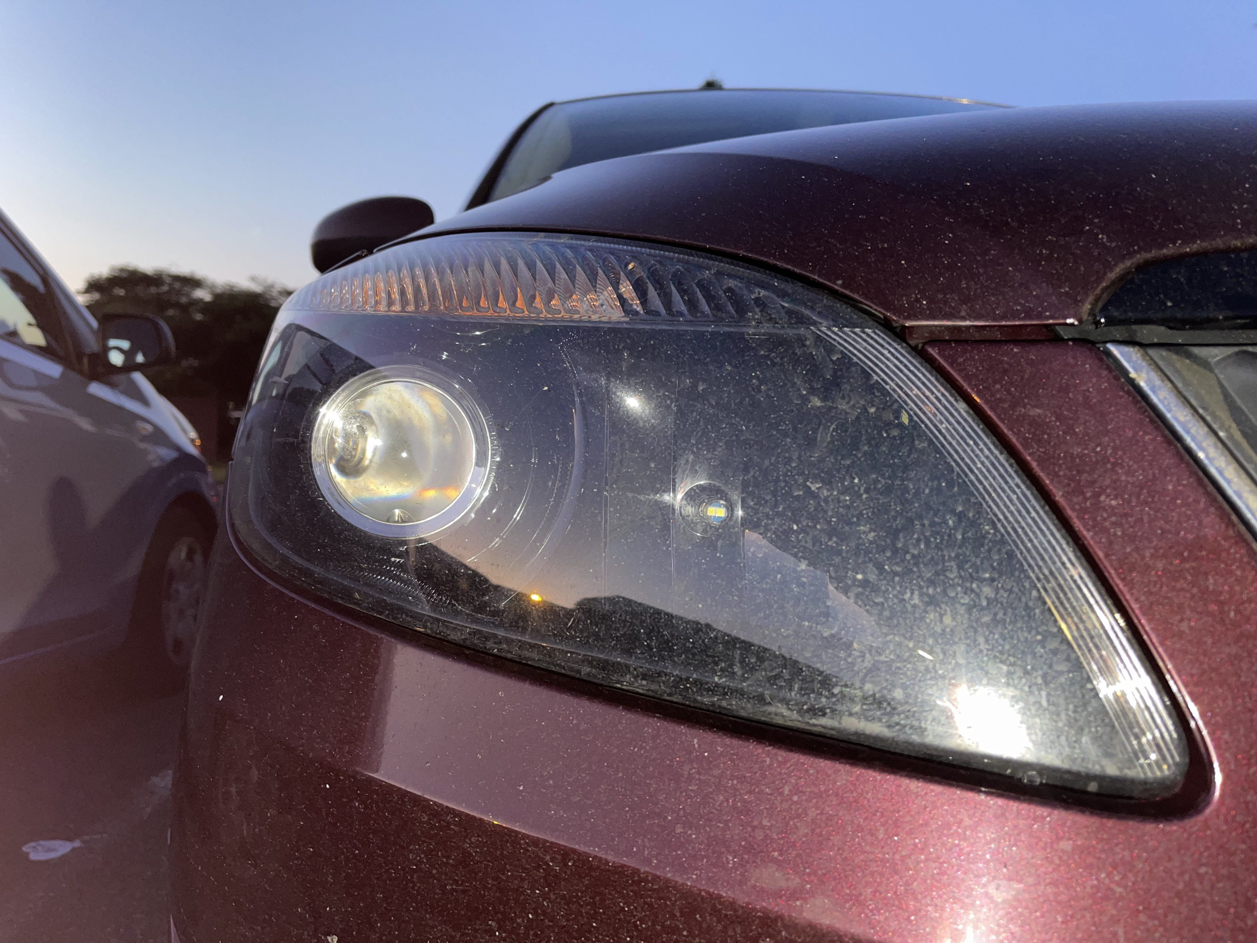

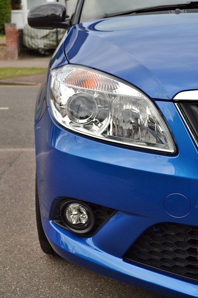

  17. Here’s a picture of my headlights now. It’s dark so I apologise. You can see the projector and next to is is my LED sidelight bulb where the full beam bulb normally is on the other headlight
  18. That’s it mate, in the Monte Carlo, the sidelight hole is none existent and instead the sidelight goes where the full beam bulb is in that headlight.
  19. Those are just poverty spec ones, no projector. Zoom into the headlight I’ve just commented. There’s the projector, then next to it on the right is the full beam bulb and in the top right corner is the side light.
  20. Correct, it does share the same reflector area but the full beam bulb is more in the middle of that section so it reflects better. I can take photos close up in case it’s confusing. No I haven’t sorted the flashing yet. I’m gonna see an auto electrician towards the end of the month and then I’ll post an update
  21. It’s sidelight towards the top and in the middle which is just hidden by the projector is the full beam. I know because when I switched the bulbs over I was confused, the regular headlights have an extra bulb which is the full beam where the montes are just the regular dipped beam with a shutter which isn’t good but whatever
  22. Mine had projector dipped beam and a reflector full beam, not sure how 32k has done his but if he sprays that reflector black then the full beam won’t really work Yeah but can you see where your mouse is? That’s the bit for the full beam
