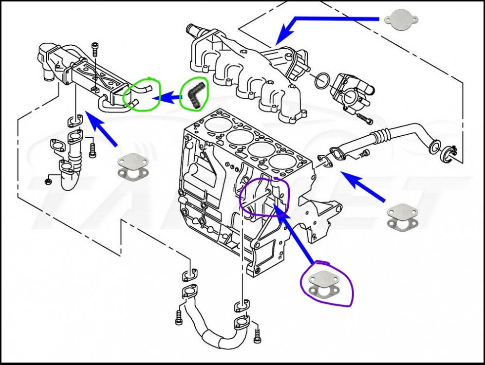

I've been actively looking at EGR delete kits and I just cannot figure it out for the life of me where they all fit around the back of the engine.
Darkside says one of their plates has to be fitted to the turbo and then the pipe or whatever can be left removed? But I can't see any port where that plate will go which has studs exept from the exhaust manifold (circled RED). In order places they say one of the plates goes on the exhaust manifold (circled RED) which makes sense but then what about the other end of that pipe (circled BLUE)? Do I keep the pipe fitted to both the block and manifold but sandwich the blaking plate on the manifold side?
What about the water circuit on the EGR cooler ? One advert gives me a part to connect the circuit to itself but on the diagram looks as though those water circuit pipes are at weird angles and theres no way the 90 degree connector will fit.
Lastly, where in the hell does that gasket circled PURPLE go? It's in none of the first 2 diagrams.
It's making me lose my head lol. Only reason I want to fit it is because it saves on labour and the kit on ebay is cheap and I don't know if the garage I'm gonna choose to gut my DPF and remap knows how to block everything instead of just the pipe at the front of the engine. I want as many pipes/ports blocked without removing the cooler as that would be extra work/cost.

Why not just leave it as it is and have it tuned with everything in place. ?
If its easy to spot the fitted EGR delete kit, it will fail an MOT if the tester has anything about him.
The purple gasket and blanking plate is to block the coolant flow to the deleted EGR valve.
You have the rest of it right.

That’s great thank you
