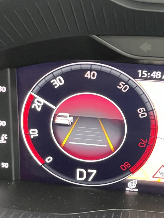

Car thinks it is driving on the right hand, not left hand side of the road in the UK
Has anyone had the car think it is driving on the other side of the road. Yesterday while driving it reset the headlights to driving on the right and would not let me set them back, maybe not letting me as I was driving at the time, and also the road signs were displaying in KPH a few times. On the return journey I checked the lights were set for left hand driving but on the motorway, with the ACC on, it was slowing me down when I was trying to pass cars, as if it thought I was undertaking not overtaking, see photo. I have had it slow me down when I was coming up to a car and it was like I was going to undertake but the car image was on the other side of the display. I need to take the car into the dealers so will let them know and see if there is a fix but wondered if anyone had the same issue and had sorted it so I could inform the dealer.
