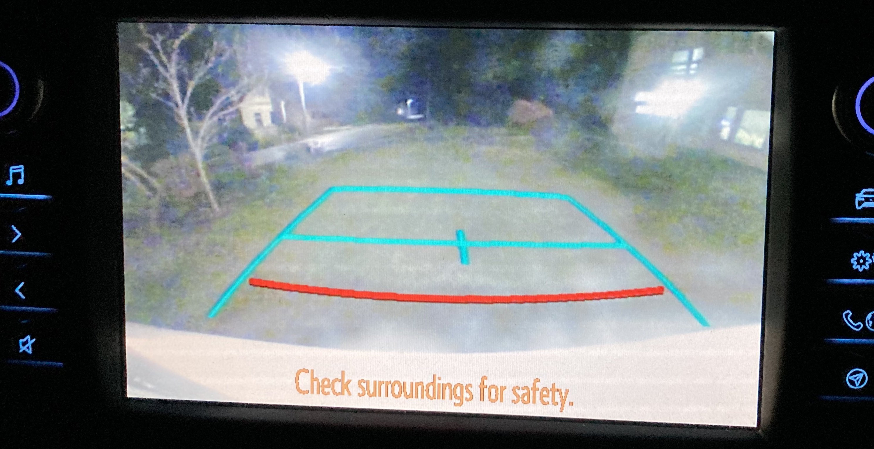

  9. And here is a Toyota Yaris 2019 on the same spot. A bit blurry (camera was probably dirty), but not dark like Octavia.
