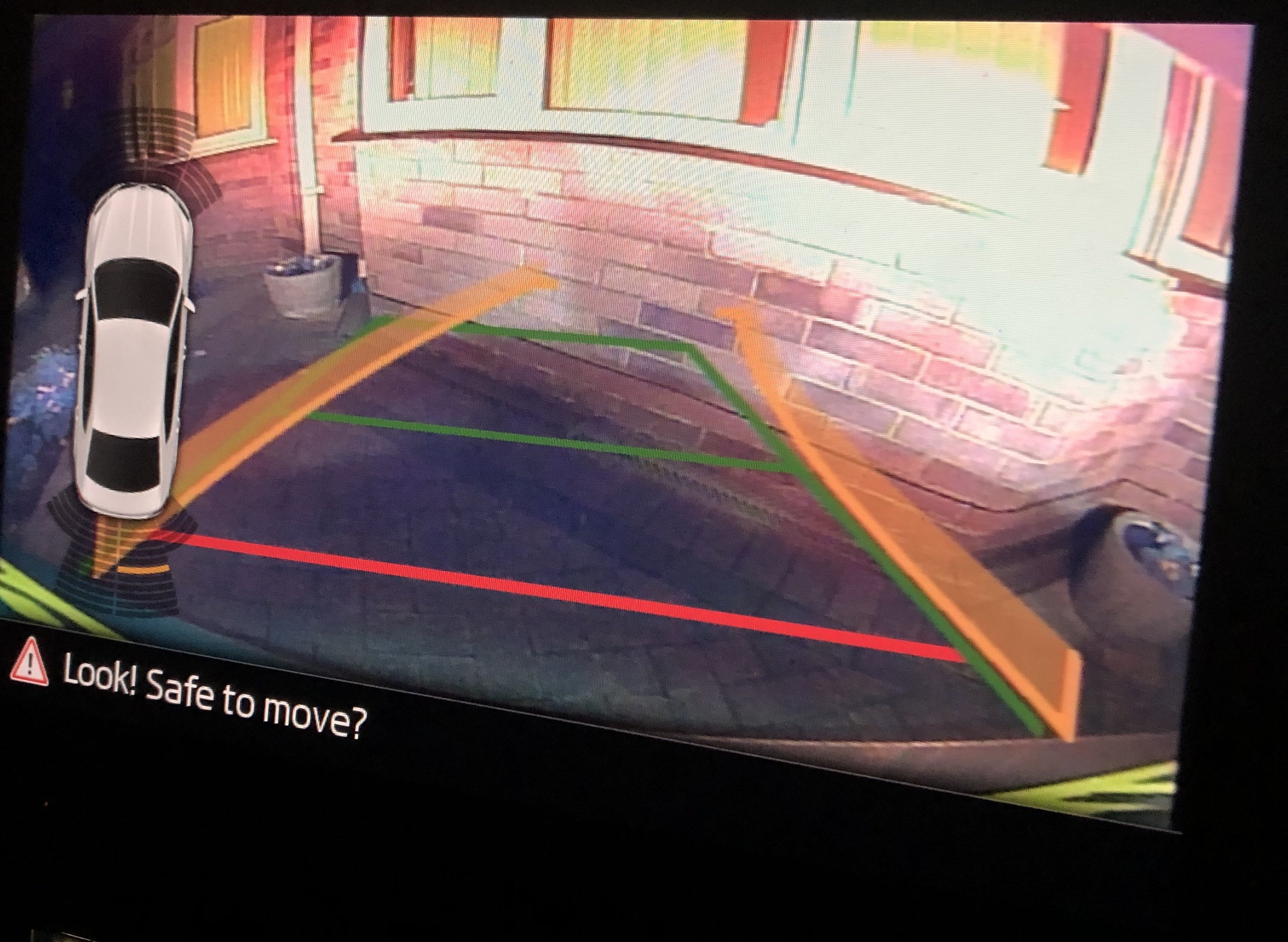

Just came back from a short trip in the dark and rain and this is how it looks on my camera. It's even a bit better in real life.
Turn off the (front) lights next time, to see how it works.

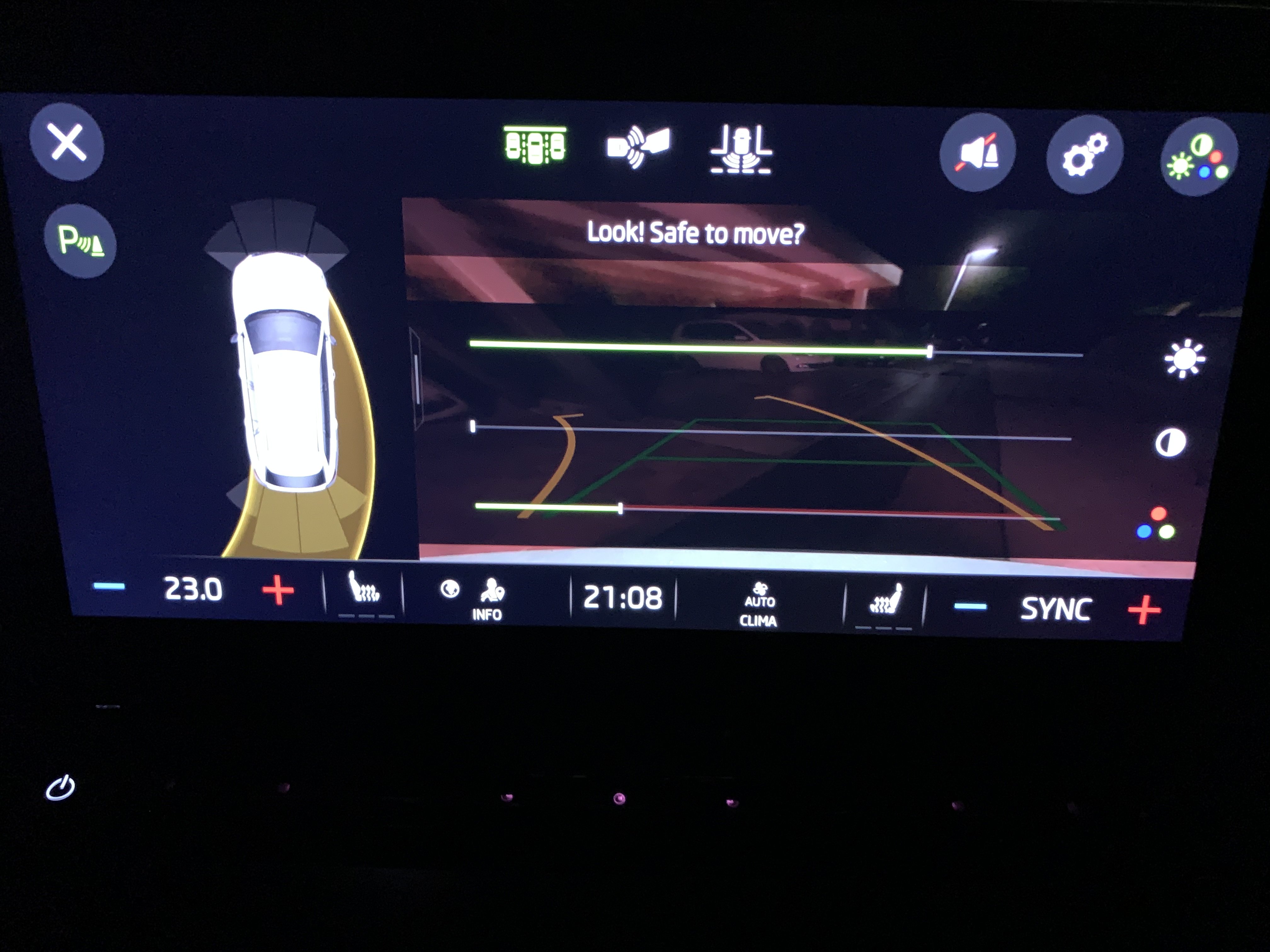

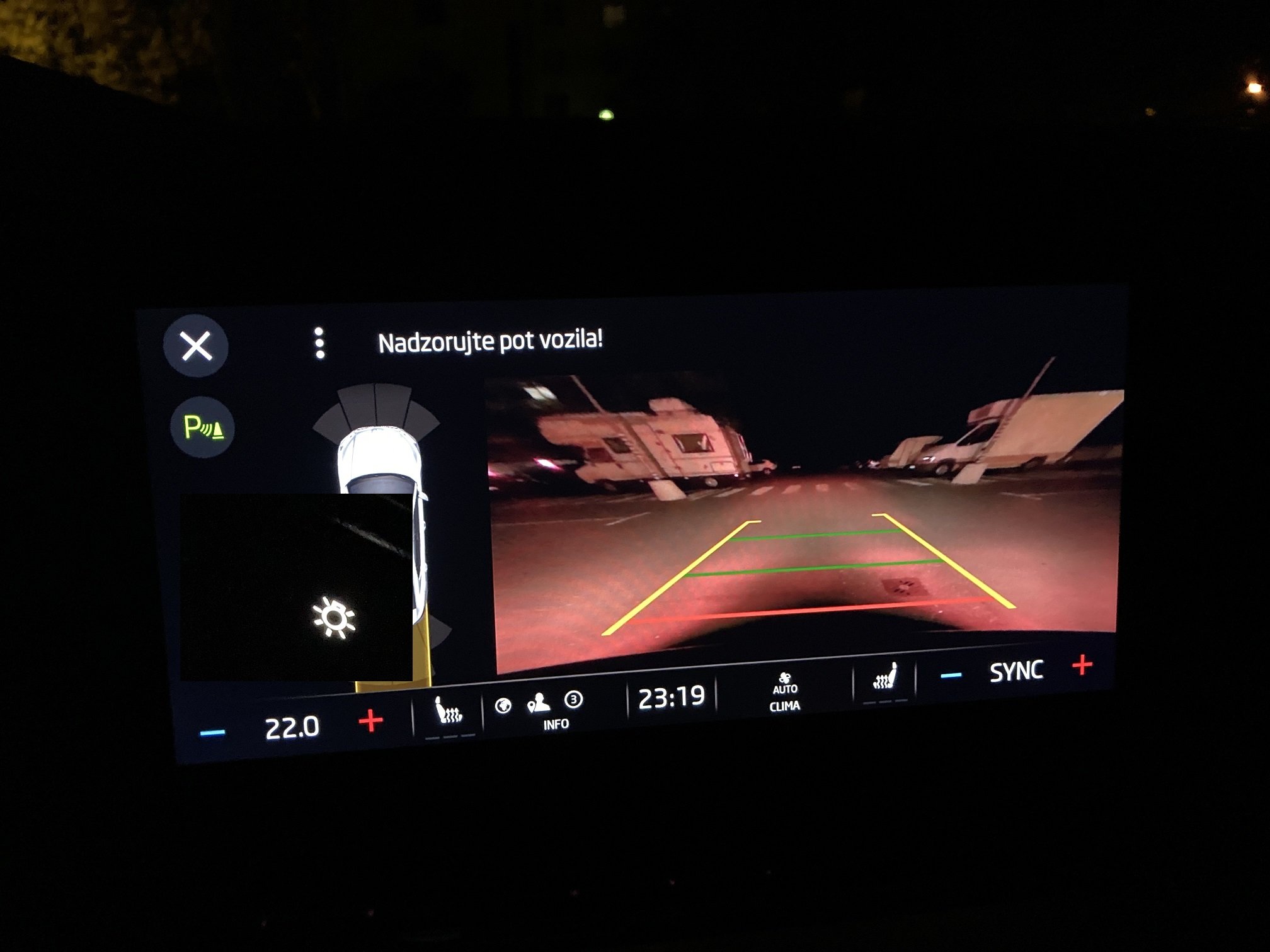

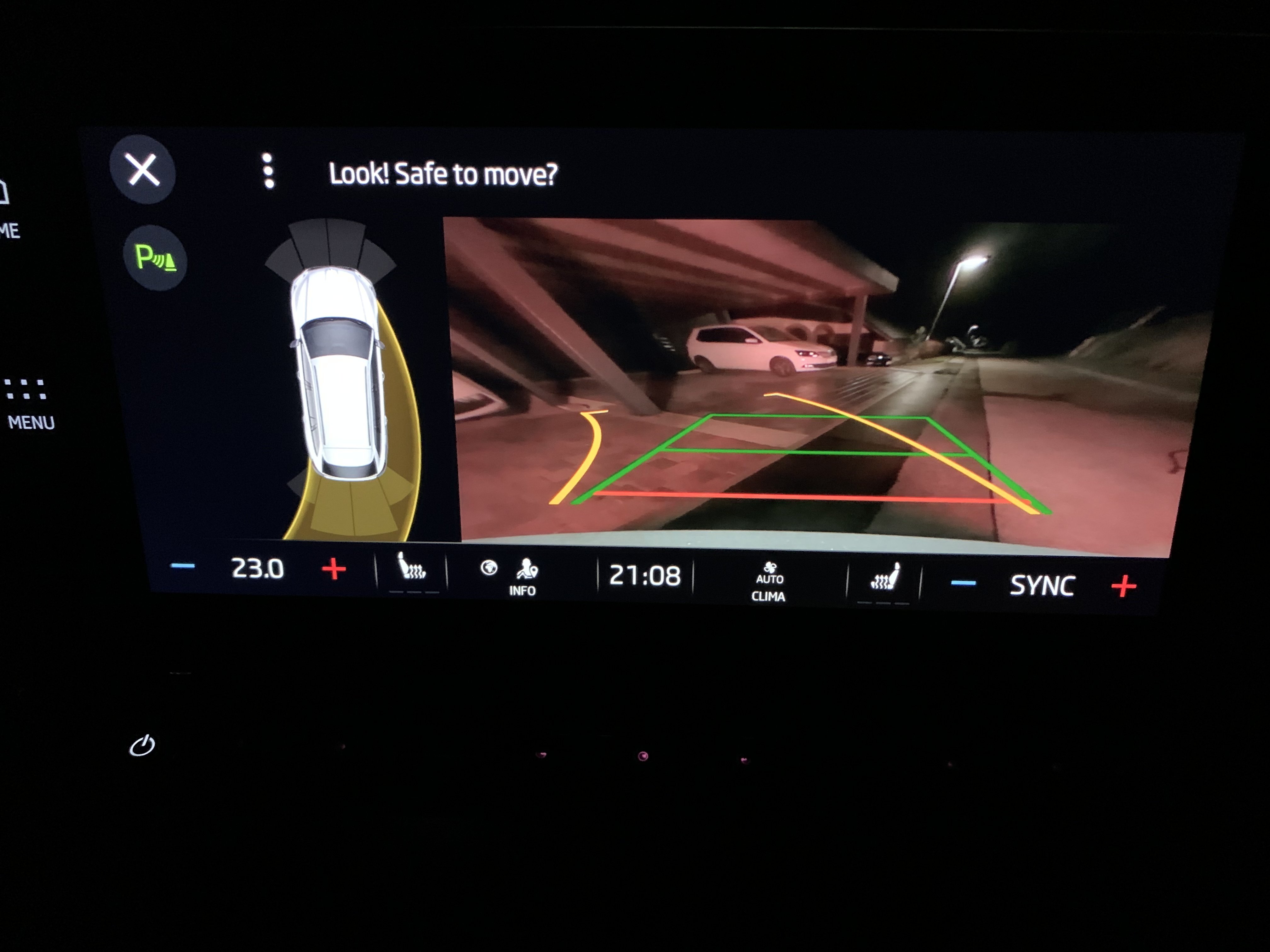

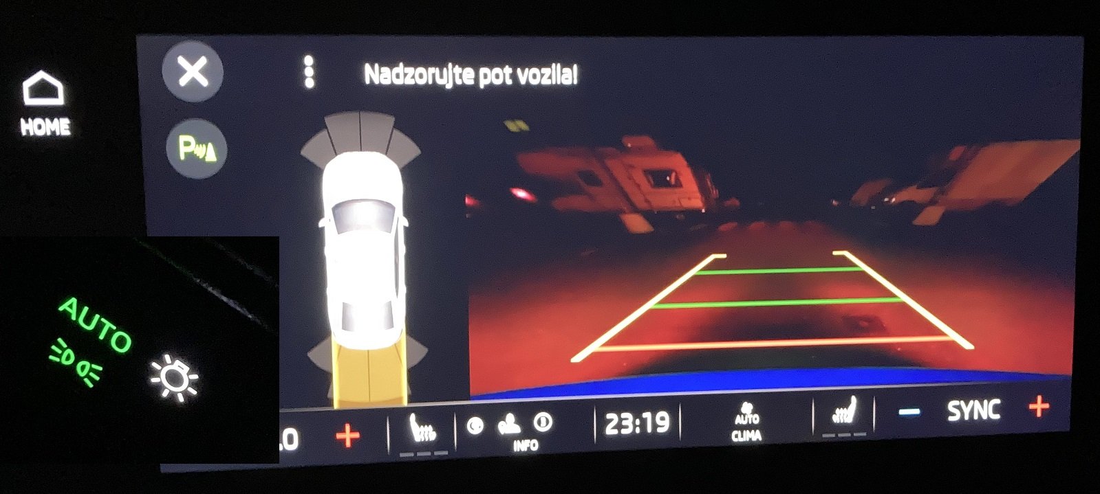

For me it is almost a day and night difference. See photos. (first is with lights on, second lights off)
For example the parking space markers  are almost completely invisible on the first, while clearly present on the second. Also the drain opening on the floor has much more details visible. This is not the best example, since most objects in the picture are far away, but it shows the difference.
