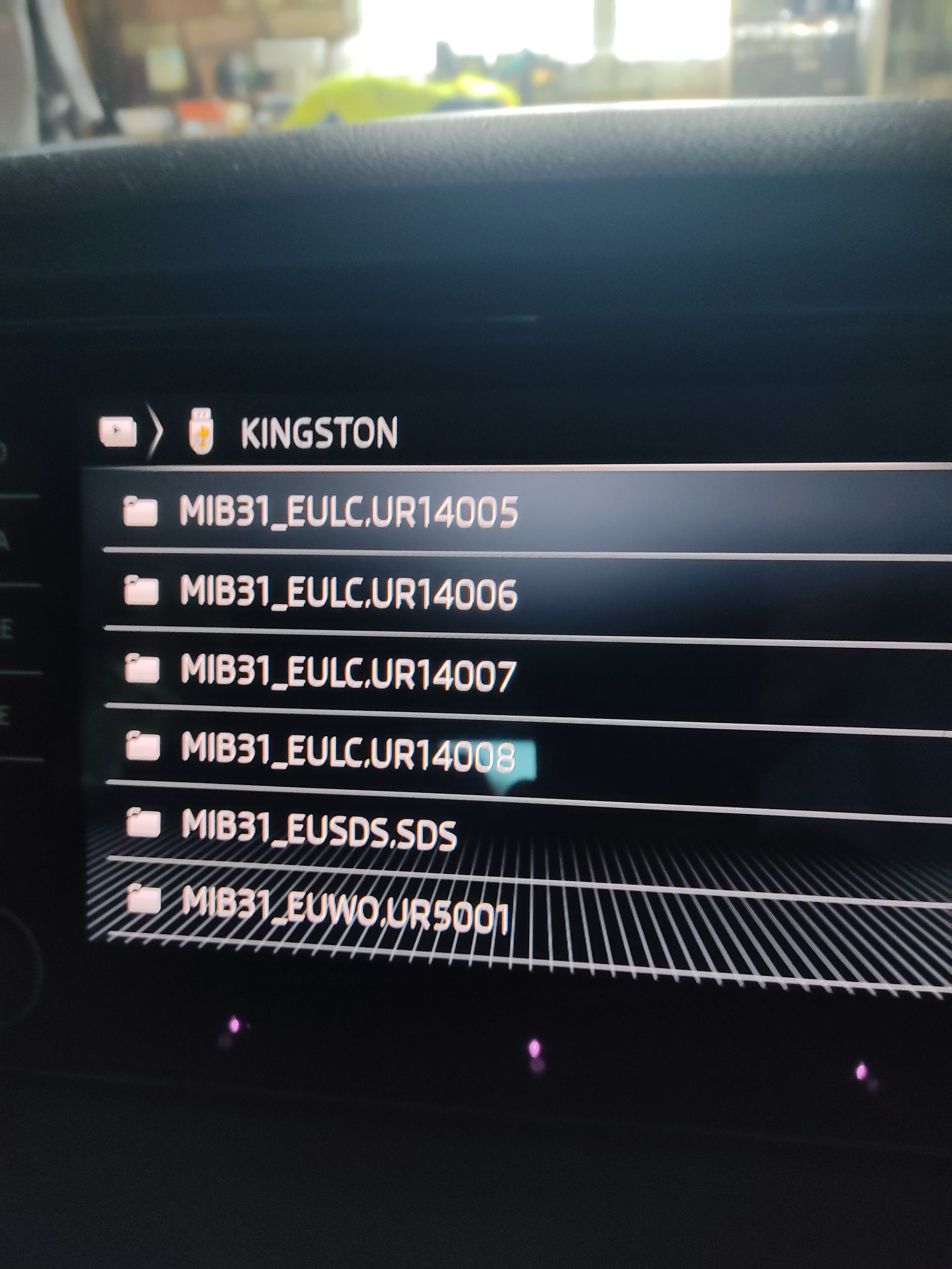

  12. Hi, just put my usb into my car and checked and the files show up under media, as per pics below, I'm at a bit of a loss as to why it will not update in your vehicle, I guess you formatted usb key with exFAT first...

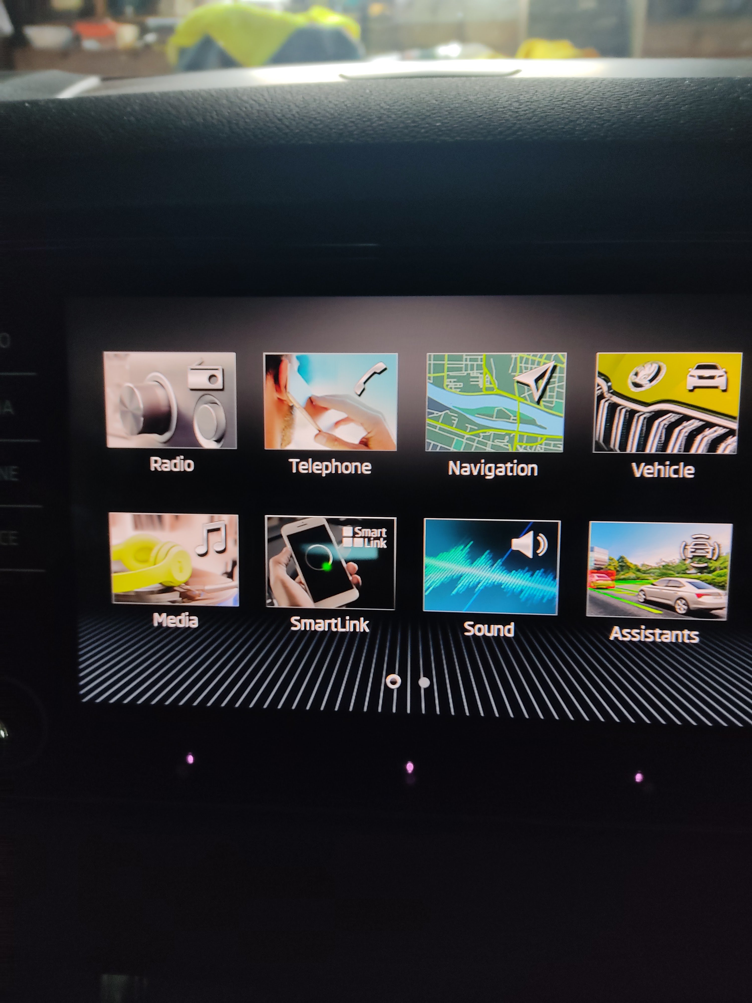

  22. On my Karoq. On infotainment screen go to main settings, assistants, assistant settings, Front assist, change setting to one of three
