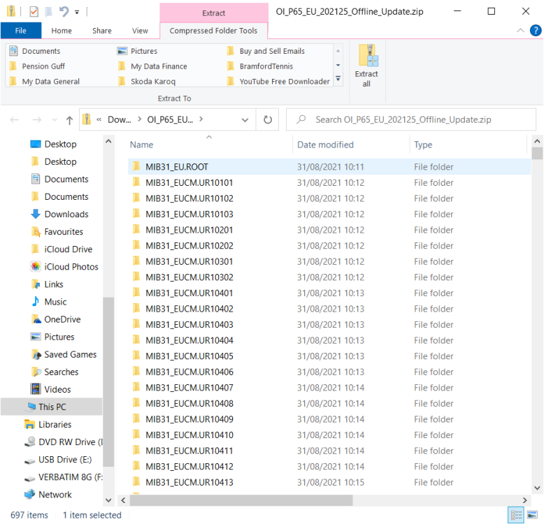

OK, so trying to download the zipped file with MS Edge brought up a security check saying the file was unsafe! Was this the empty file you found? Bypassing the security warning by telling it to 'keep' the file downloaded the zipped file OK (In about 20 minutes for my home broadband connection).
It then extracted to a myriad of folders (in about 40 minutes on my PC).
The manual then says to copy the contents of the already unpacked file (not the entire folder) to a USB Memory stick which has been formatted as Ex-FAT and is at least 64GB in size. (I used one with USB and USB-C connectors at each end to avoid needing a USB-C adaptor.) Now the illustration shows just one sub-folder selected, but I'm sure you need more than just the one sub-folder! So I'm assuming that what they meant to say was to copy the unpacked contents excluding the PACKAGE.SLIST file. So this is what I copied.
Now I'll plug it into the car for a while and see if my map version number changes!

Hi .. Can confirm I did the procedure above and drove for around 45 mins and my maps updated, even though there was nothing in the display to say anything was going on, I have software version 0270 in my car..
Thanks Bryfly,
Did you copy the PACKAGE.SLIST file onto the USB stick as well? My maps are still back at 21.2 at the moment, so it'll be good if this will update them. And even better if software version 0270 will accept the updates :)
Chris
Hi Chris , I copied everything that was there after I unzipped it, using "7 Zip", just checked and yes "Package.SList" is there..
I went from 19.11 to 21.7 on mapping

So when you did all that and drove locally to update, have you any idea how long it took to upload into the sat nav to get your new maps?
And just to be certain, after you unzip the main file and get loads of sub folders, it is the contents of EACH of these sub folders that has to be tranferred to the stick? I would appreciate your confirmation on that too!
Very many thanks for helping with my update

After driving for 45 minutes I'm not sure how long it took to get onto the sat nav, but it had updated next time I started car, one member here has had no luck updating by the same method though.
Unfortunately I cannot check what was unzipped as I deleted the files after I installed but from memory I just unzipped the download with zip7 and copied all those files to my key....good luck

Just found the key I used for my update, the first file listed is MIB31_EU.ROOT and the last is MIB31_EUWO.UR5001
Thats great those are the files that I have used, plus the package file.Not sure if the last one is needed but its gone on anyway. I have just to go out soon and have a decent drive to see what happens then. Thanks a lot

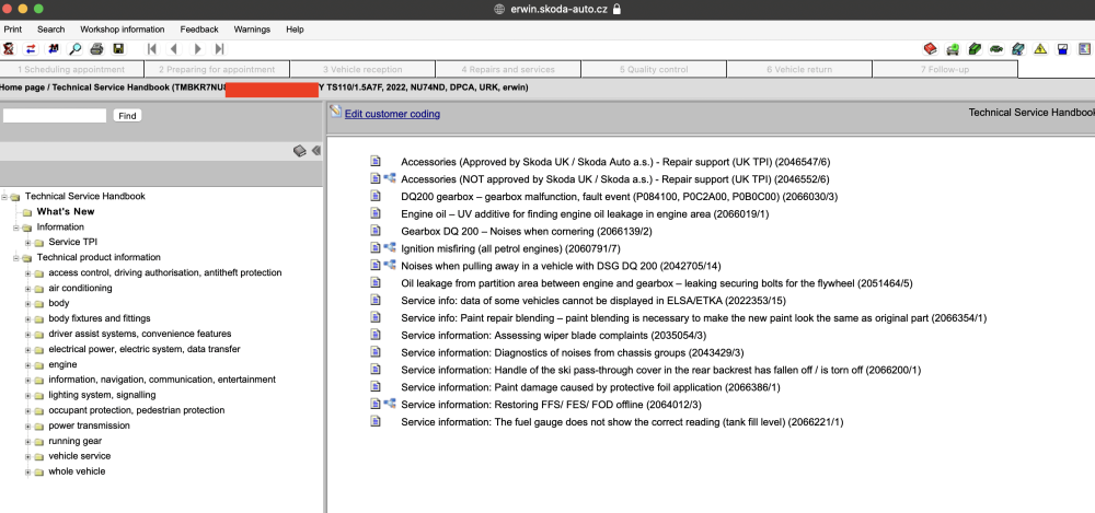

I've read that VW will be making major changes to the MIB3 systems in their cars this spring, with new processing hardware for new cars. The software updates will be reportedly be offered to existing VWs, Skodas, and SEATs later in the year.
As the system is designed by VAG, Skoda can only fit what they are given - although this doesn't excuse their refusal to accept and handle customer complaints better!
