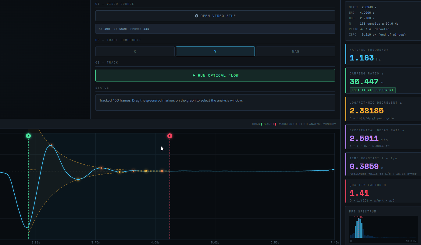

  1. Style trim, 2.0 tdi dsg. One mechanic said shocks are bad and suggested to replace them other says it's ok... Did another one press down test and results are below.
  2. It's 130k km.
  3. Can anyone take a look and tell if this is normal for the Octavia y2020? It was very soft from the beginning already and it bounces exactly the same on left and right. Video
