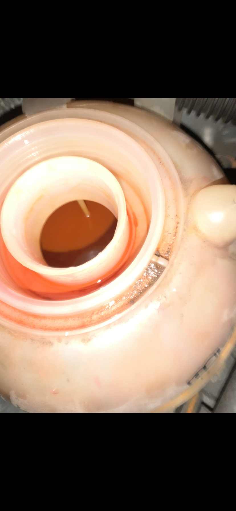

this is the coolant level now it’s actually lower than usual ??? It normally sit around the neck since noticing this issue but does sometimes go back to normal level ,, I never top up the coolant it loses nothing only if I open and it spits out do put a tad bit in 🤣,, this is or seems like it’s very intermittent?? As the past 3 days it’s been super high and today it’s back to been normal still had some pressure in system but not what I’d call excessive?? going try and book it in on Saturday for a sniff test for head gasket and get the thermostat and coolant changed plus a flush out of engine and radiator to see if there is a blockage?? obviously if sniff test comes back positive then I don’t know what to do,, 😢 either buy a new car or spend god knows how much doing head gasket belt and water pump ££££££££ 🤣 only noticed it 2 week ago as we went for a day out and I thought just check oil and coolant level this opening cap it spat some out 🤣🤣 and I thought ehh that’s not right

Good afternoon peeps,, long time away but if possible could I ask a question regarding pressure in coolant system??? mine seems awfully firm to press hahaha the coolant level is always near the top of the tank but I can’t squeeze the pipes they really firm,, if I leave over night and try they still firm and when I remove the cap all the coolant spits out,, I’ve replaced cap with a new one,, she doesn’t over heat can go up to 100 but she’ll drop down when driving I get the occasional temp light on but when I check it’s full,, any ideas why it’s like this could thermostat be fooked,,, it also warms up pretty quick and get to 60 degrees in about a mile or so thanks peeps.

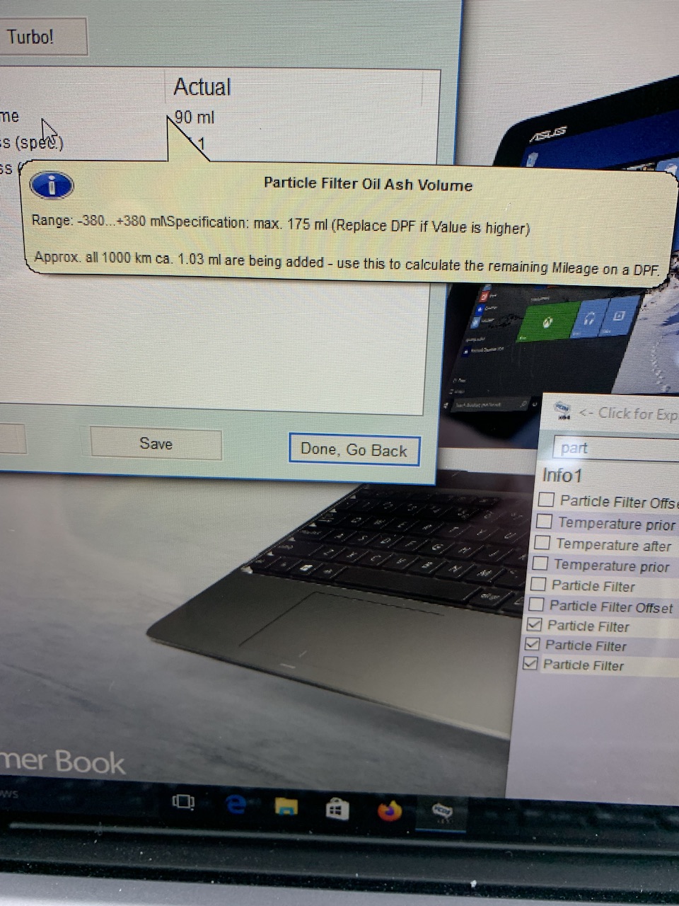

VCDS forced regeneration help/advice ??
I’m even more confused so is that good or bad,, just can’t understand why my revs hold at 1000rpm every 2 weeks,, gunna change me EGR valve and take me inlet off coz I’m now get flap stuck open on cylinder 1 ,,, 🤣🤣,, but I still love the car even though it’s throwing Wobblies. 🤣
I had to hover over and click on it to bring it up. Some that I clicked on did nothing

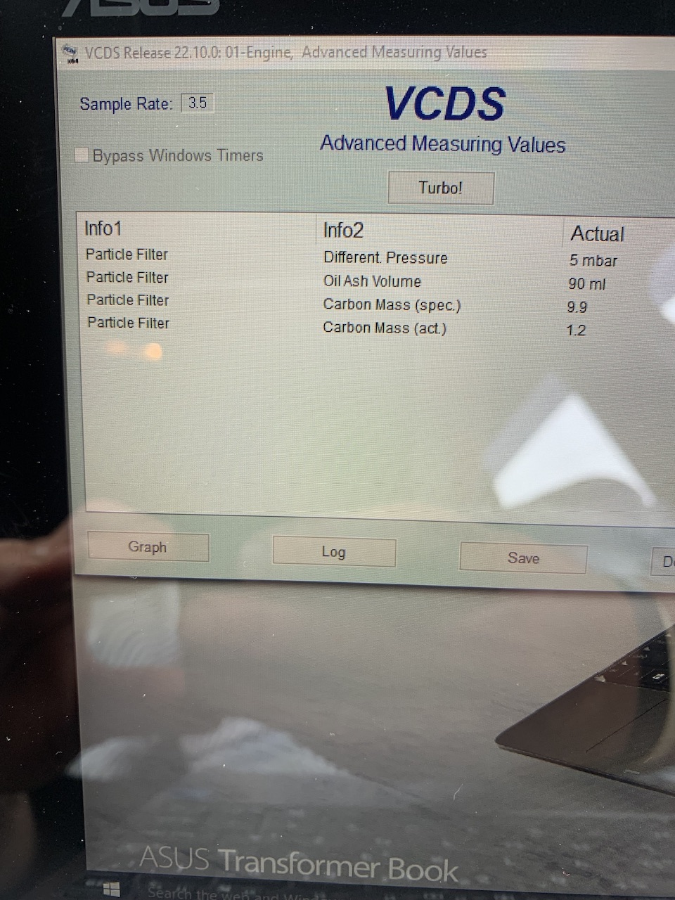

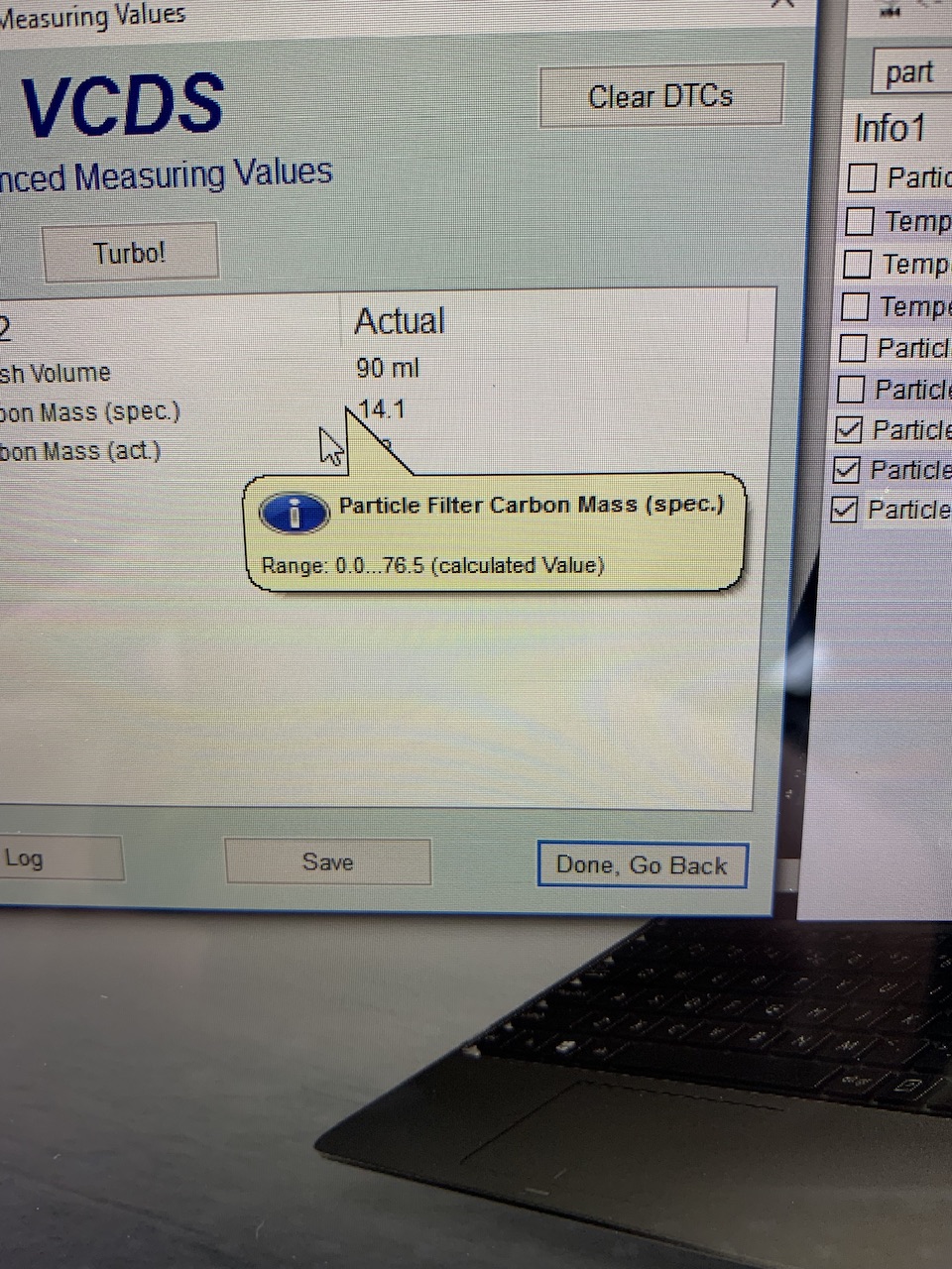

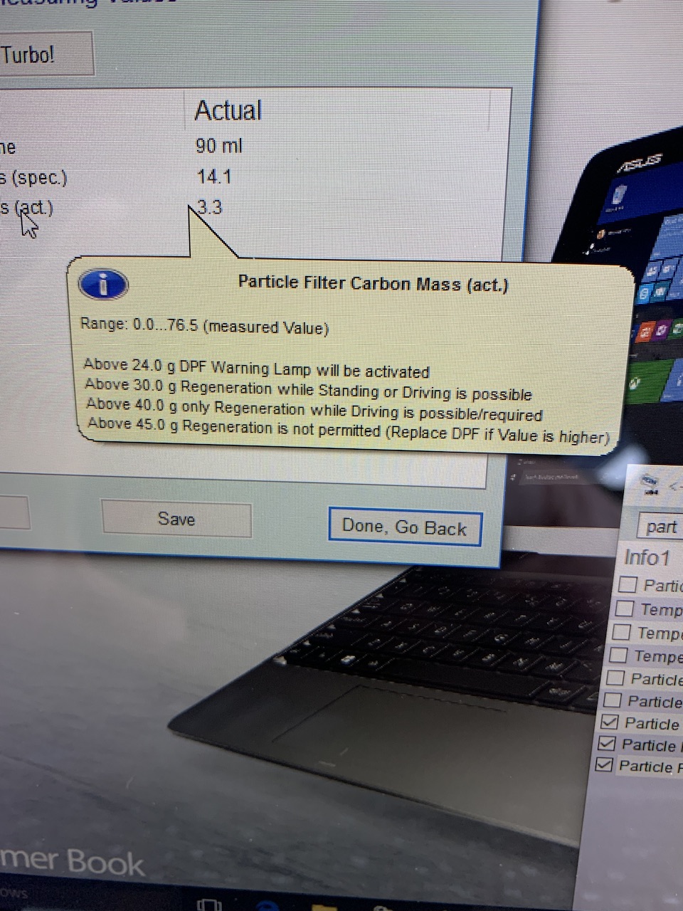

sorry for late replies on the photos,, worked late and was pooped 🤣,, so done them this morning and yes they give a kettle more info when you click on them,,, hopefully you bright sparks will be able to shed a bit more light on the extra info ??? thanks peeps
Well came home did a bit of shopping with the other half and then thought I’d go get the laptop,, plugged in turned it on yes you’ve guessed it my lad has flattened the battery and not bothered to charge it back up 🙄🤣,, it’s on charge ready for tomorrow 👍🏻
Hmmmm ?? battery ??? Mine does occasionally ping from the dash and I don’t know why ?? Never had an issue with it not starting? But my dials do sweep every time I start it,, remember with my ford if it did it I was a battery issue
My regen light has never come on but every 2 weeks the revs hold at 1000 rpm and if I don’t take it for a quick 20 mile spin it can be in for a couple of days then it stops. never had it in limp mode neither if I tell it it’s new how would I go about doing that ??? Can it be done through VCDS
No mate but I will try when I get home 😢,, can I put hetty hoover on the end and suck it out 🤣🤣

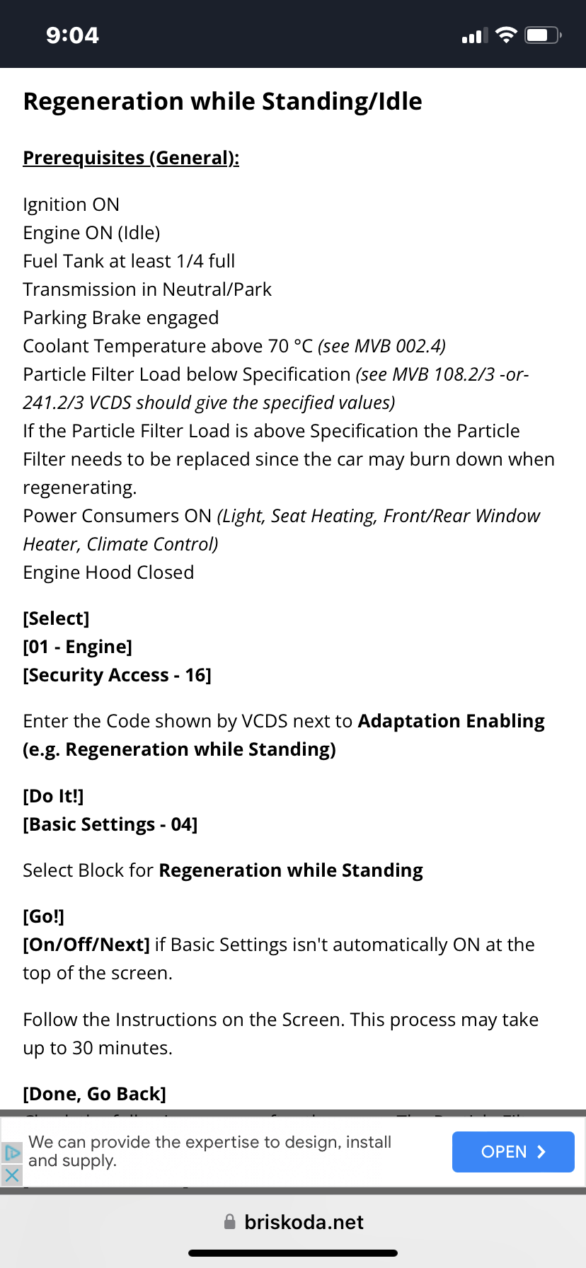

did find this and used it to have an idea what to do but it said power consumers on lights heater window heaters seat (don’t have em) would it be because I never put any of these on maybe ???
Cheers guys really appreciate all the advice, I suppose baring taking it for a drive again,,my only options are DPF delete or a new one at about £1000 or find out if somewhere can clean it out (with a Jack hammer 🤣)
Cheers boss,, If it is high would a good drive help or is it close to been fubar 🤞🏻🤣
That number does ring a bell I pretty sure I did that

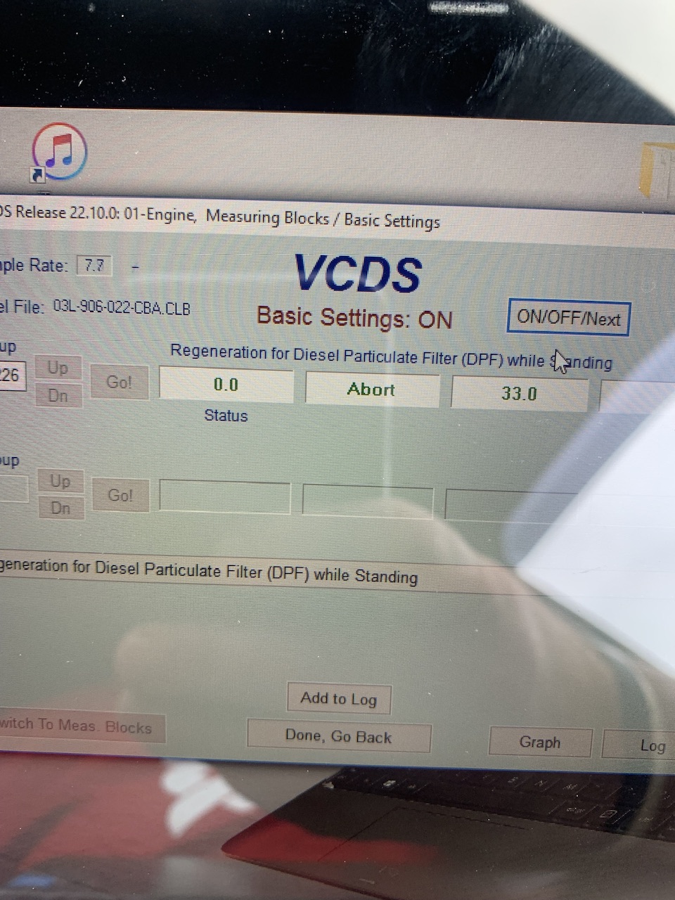

tried to use VCDS to force regenerate the DPF,, due to car every 2 weeks seems to hold the revs at 1000tpm even when I’ve blasted it down the motorway,, (60 mile round trip) it says press brake then throttle but then shows the screen above,, am I doing something wrong 🤣?? I know I should have taken a photo of the readings but I forgot think something said 90 but can’t remember 🤣🤣,, would anyone know what the readings should be between??? Car is a 2.0l tdi VRS 2010 124k thanks peeps
