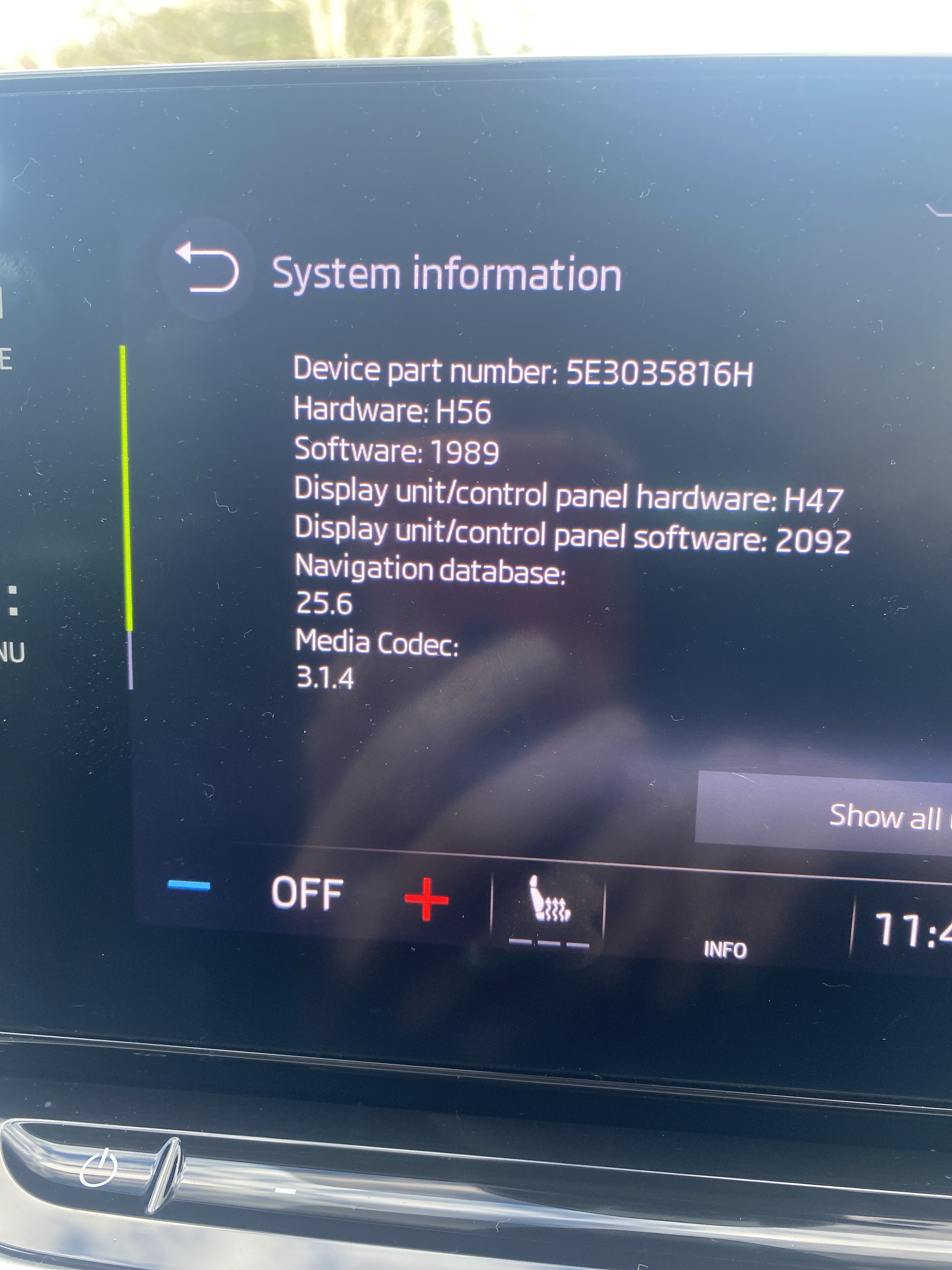

  3. Menu/settings/scroll down to System information. Tap and you’ll see software. Latest is 1989. Bugs slowly got fixed with most updates. Insist the dealer gets it updated as it’s crucial for nearly normal car behaviour. Prior to this there were dangerous errors

  7. It’s not possible to downgrade. To me it seems a bit suspect that a new version of software has appeared some time after the facelift. Especially as it’s only a few numbers after 1985. Hard to believe Cariad are still working on it. Is this an official release? How was it obtained? I think I’ll stick with 1985 despite it still being imperfect
