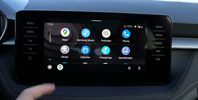

  7. What happens in android auto when you select phone? I have ever used android auto myself but ask because i saw it in that demo

  9. Have you tried to connect with android auto app. and mirrorlink https://www.youtube.com/watch?v=FgKSKeBO490

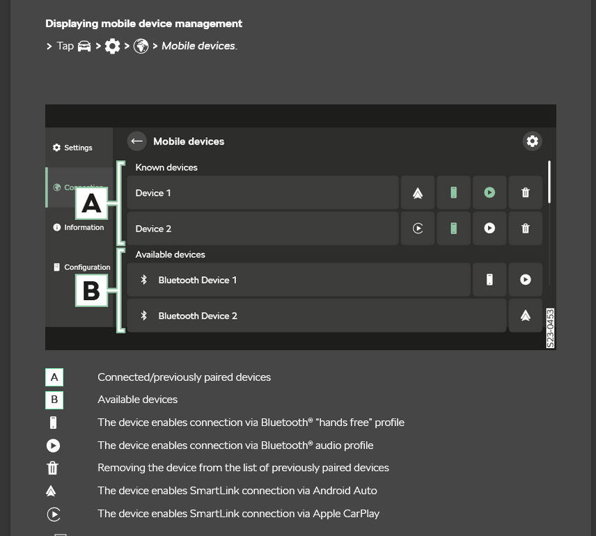

  20. If without doing anything with the phone until the car pings it for the code, which should be blank, awaiting you to put the numbers in and press done/pair and it doesn't work. I think I am stuck too. The only situation i have been unable to pair is sometimes in Mercedes minibuses at work never had trouble on the enyaq. we have 40 mercs all different ages. When I cannot get the ping. usually removing a phone or two from the Merc system. Works. When it fails resetting the merc system to factory settings is my default fix, but it wipes out all the radio settings etc as well which is a pain for the other users of the vehicle when they get back in and they also have to pair their phones again. By the way when the car sees your phone does it have the icons on the right for hands free and audio profile?
  21. That is the problem. Make sure the phone is visible in it's settings ( i am not trying to say you don't know that. it's just the first caveat) Go to In the car your phone should be in (B) if there are two items in (A) remove one or even both. Touch the screen on the line for your phone. Note the icons to the right and what they mean. The pin request should arrive on your phone. 🙏
