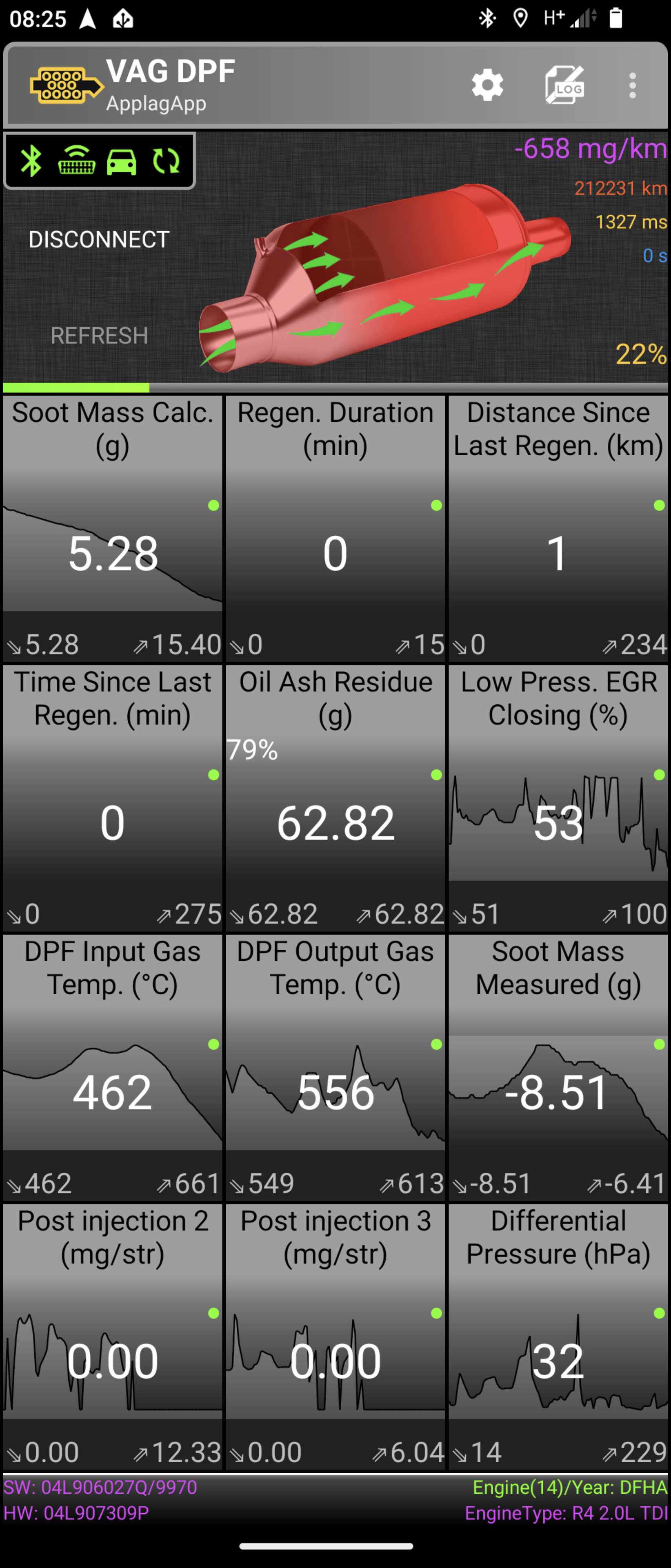

  8. Just jumping in on this topic, I get a Regen roughly every 250km. But looking at my VAGDPF results I have a negative reading for measured soot mass. Anyone got any insight on this?

  15. Maybe, but the Soot measurement is only calculation not a direct reading, I believe.
  16. That looks like it's a soot increase over 3km? That can't be right, definitely something wrong somewhere. The DPF might be doing its job, but not burning fuel well.
