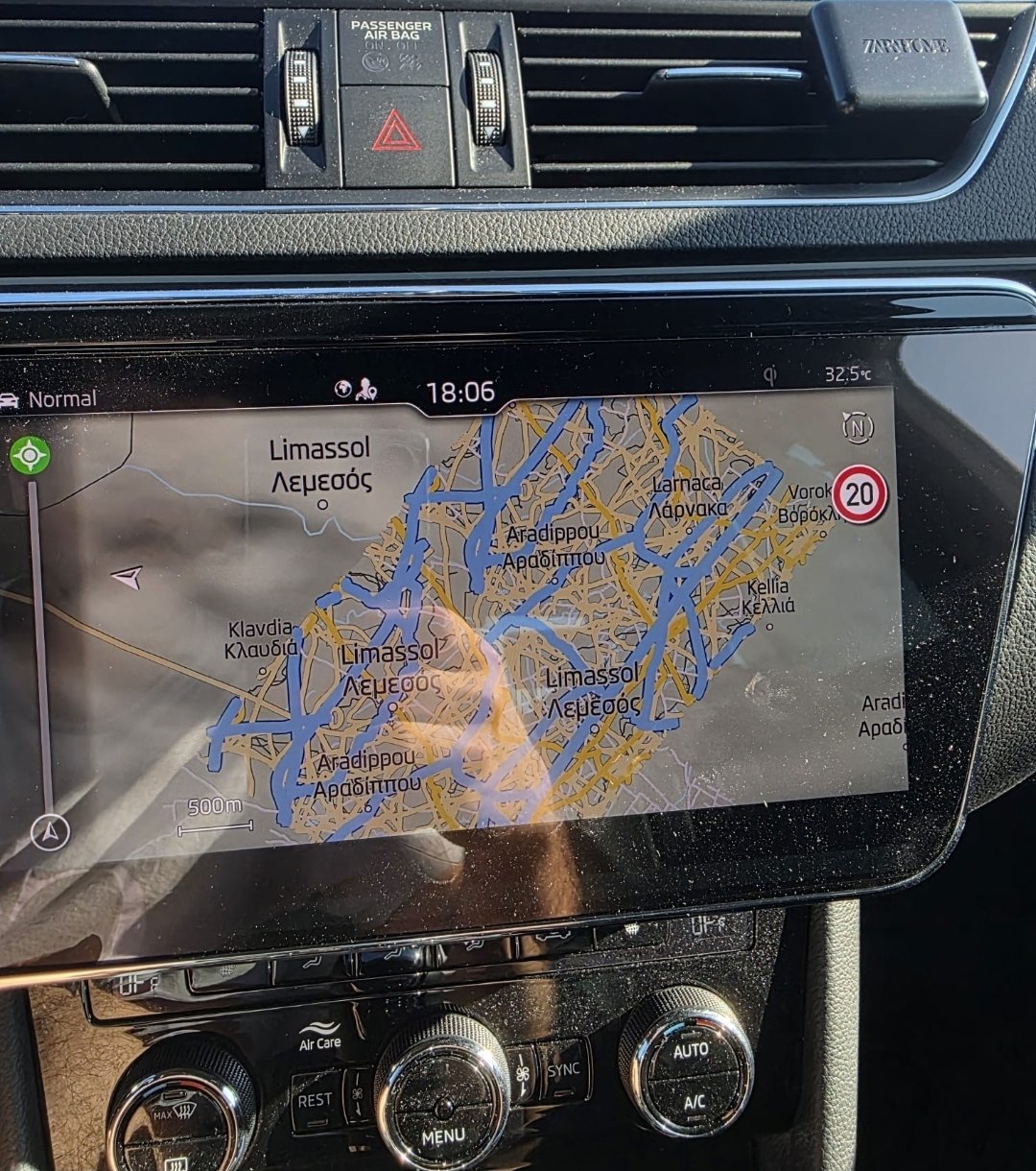

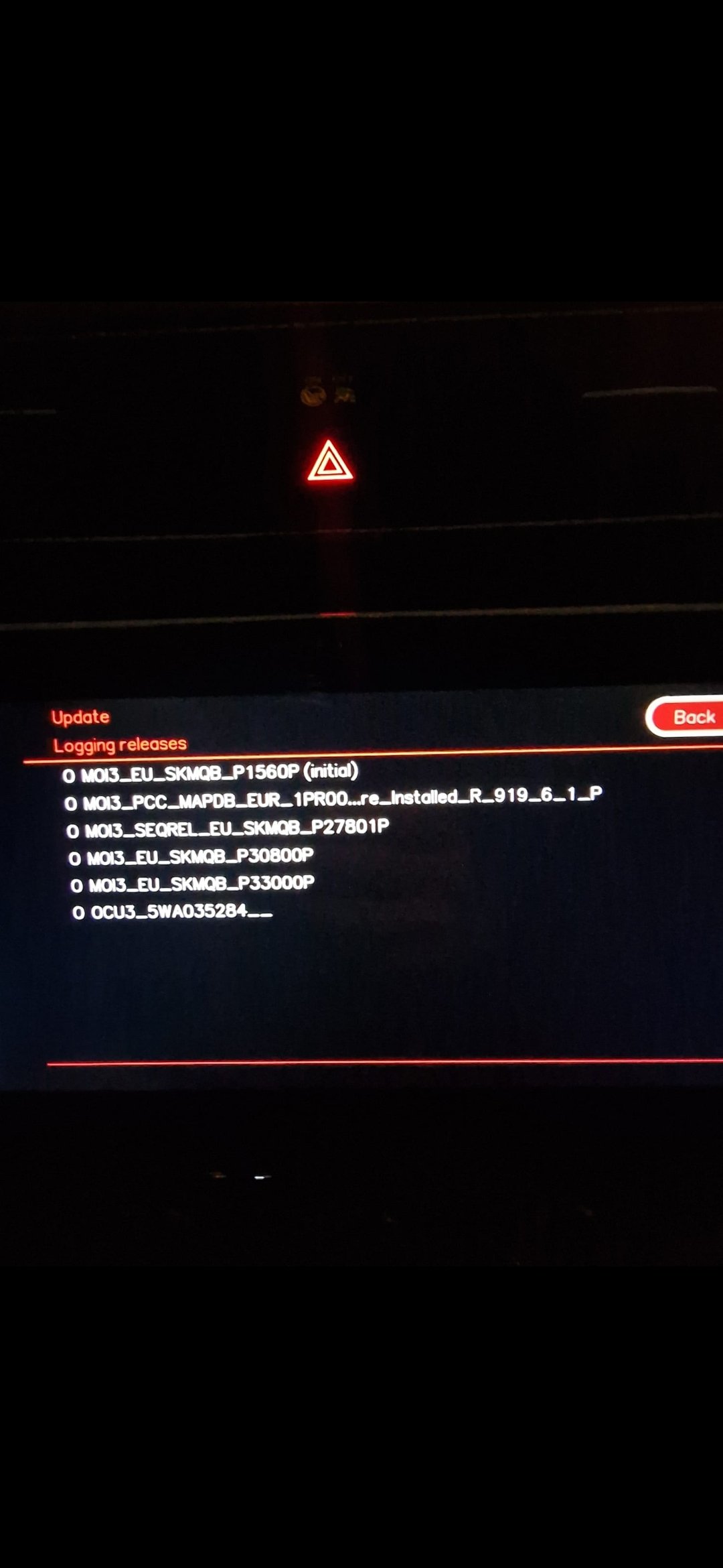

    Hello @Rainesh and everyone, I will be pleased if you could help with a piece of advice about a problem that I have with my MIB3 unit from a Skoda Superb iV MY2020. So, I'm seeing 2 cities from Cyprus (always same 2 cities) in random places everywhere on the maps, and they appear mostly when I zoom out. Maps are stuck to 23.6. Tried with offline update via USB, also with Infotainment Online, no change, no new road appeared, nothing. Swap codes are looking good, the 00071c00 appears to be installed and valid. While navigating throughout other countries, maps are looking.. not great, not terrible, however, navigating through Cyprus is a total mess (please see the attached picture). The unit was updated by dealer from 0156 -> 0278 -> 0308 -> 0330 by dealership. OCU also updated. I managed to update to 0332 recently, update ended successfully and the emmc ended with status "New", however, nothing changed on the maps. Connected with ODIS, tried to format the Navigation Data Bank, but every time I tried to start the operation, it would just return "Incorrect Results" as the outcome and won't do anything. Do you guys think there is anything that could be done further at this point or the maps will be "bricked" forever on this unit? Regards, Alex
  8. Hey, I have a Superb iV from 2020 and my MIB3 unit was updated from 0156 -> 0278 -> 0308 -> 0330 by the dealership in Germany. OCU also updated. I'm having a problem with the maps, I'm seeing 2 cities from Cyprus (always same 2 cities: Limassol and Nicosia) in random places everywhere on the map, and they appear mostly when I zoom out. Maps are stuck to 23.6. Tried with offline update via USB, but also with Infotainment Online, no change, no new road appeared, nothing. Swap codes are looking good, the 00071c00 appears to be installed and valid. While navigating throughout other countries, maps are looking.. not great, not terrible, however, navigating through Cyprus is a total mess (please see the attached picture). I managed to update to 0332, the emmc ended with status "New", however, nothing changed on the maps. Connected with ODIS, tried to format the Navigation Data Bank, but every time I tried to start the operation, it would just return "Incorrect Results" as the outcome and won't do anything. Is there anything that could be done further at this point or this unit is "bricked" forever? Thanks a lot!

  11. Hi folks, I bought a Superb 3 iV MY2020 last year and I got it with SW 0330 already installed. Everything is working good, except for some issues with the maps: 1. Maps are stuck on 23.6 - can't get them updated neither with Infotainment Online Subscription nor with Offline Update via USB Stick 2. Some maps are completely missing for couple Eastern Europe countries ( ex. Hungary, Serbia ) 3. Various cities from Cyprus appear when driving in Romanian countryside areas ( please see second and third photo ) My question is: can I do anything at this point to solve this issue or my MIB3 unit is bricked? Please see the first photo with the update history.

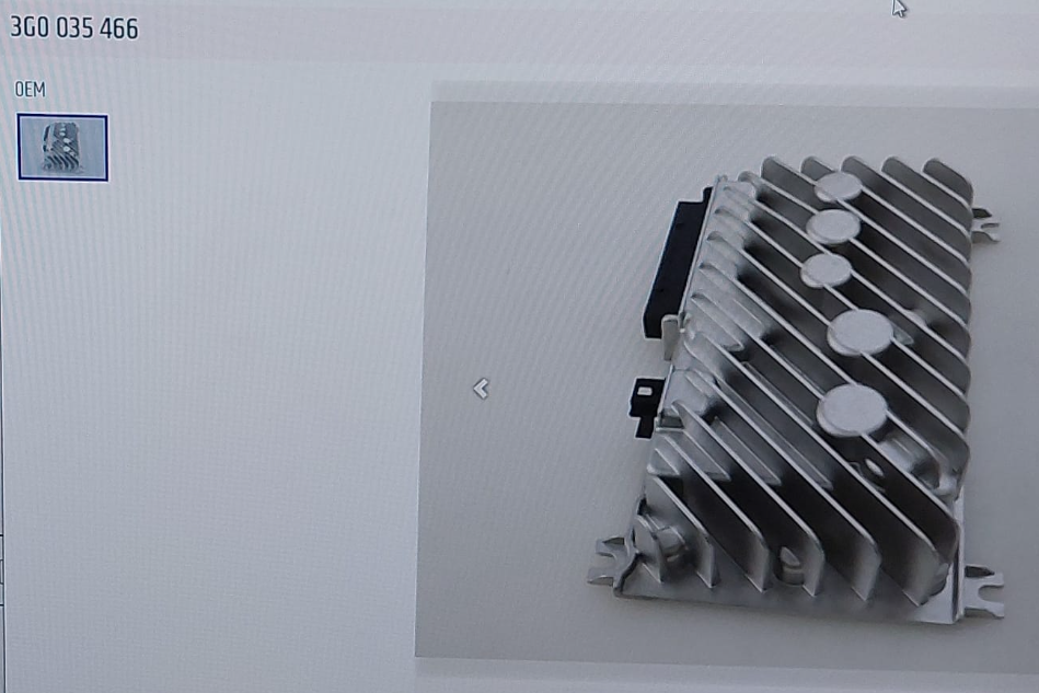

  12. Hey folks, I have a Superb iV 2020 L&K with "Sound System" setup ( not CANTON ... ). It's a bit better than the standard sound setup (10 speakers), however, I am missing a subwoofer. I noticed that I have some space available under the front passenger seat and I was thinking if I could fit a pre-amplified subwoofer there. However, I'm not sure if that would fit well along the other speakers and the amplifier that is under driver's seat ( I have attached a photo with the amp part code ). Has anyone tried to install this kind of subwoofer? Can it mess with the existing amplifier? I don't have much knowledge about this stuff. Thanks!
