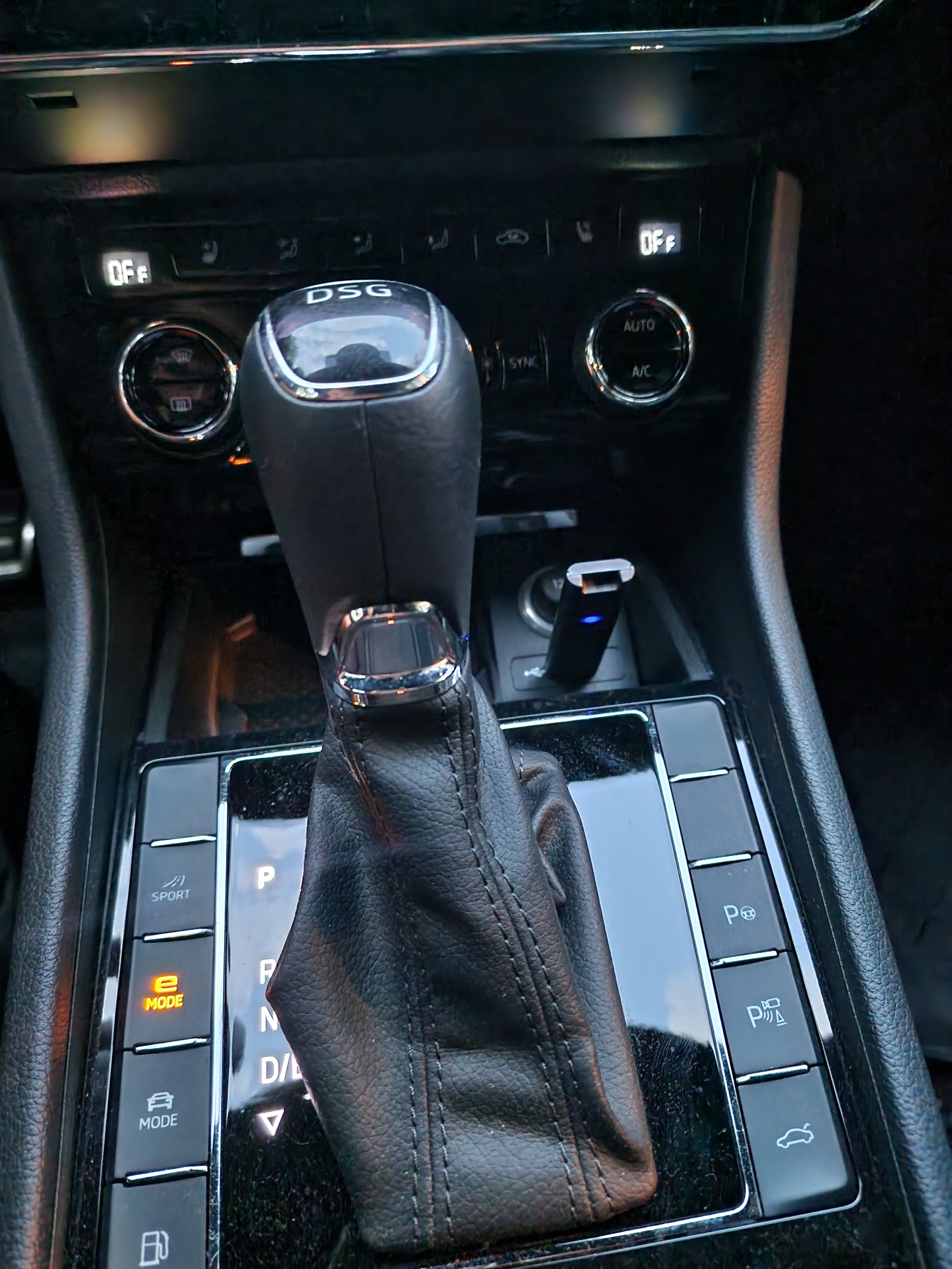

I have recently purchased a used Skoda Superb iV L&K 2020.
Unfortunately I am not able to update the maps in the navigation in any way. I am using a Kingston DataTraveler Max 256GB USB Type-C Stick and I have downloaded the latest navigation maps following the appropriate steps for MIB3 from updateportal.skoda-auto.com.

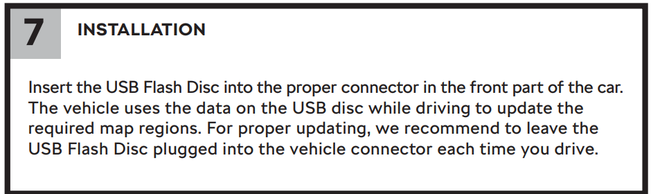

Even when the stick is connected to the front, no message appears on the navigation system that the update has started. I'm not sure how this offline update can be triggered using an USB Stick.
I have left the usb stick connected in many sessions of driving so far, but nothing changed at all.

Try a 64gb card, make sure it’s formatted correctly as per Skoda guide, plug it in and leave it.
It should take around 40-50 minutes to install and will resume where it was interrupted like turned ignition off after 30 minutes

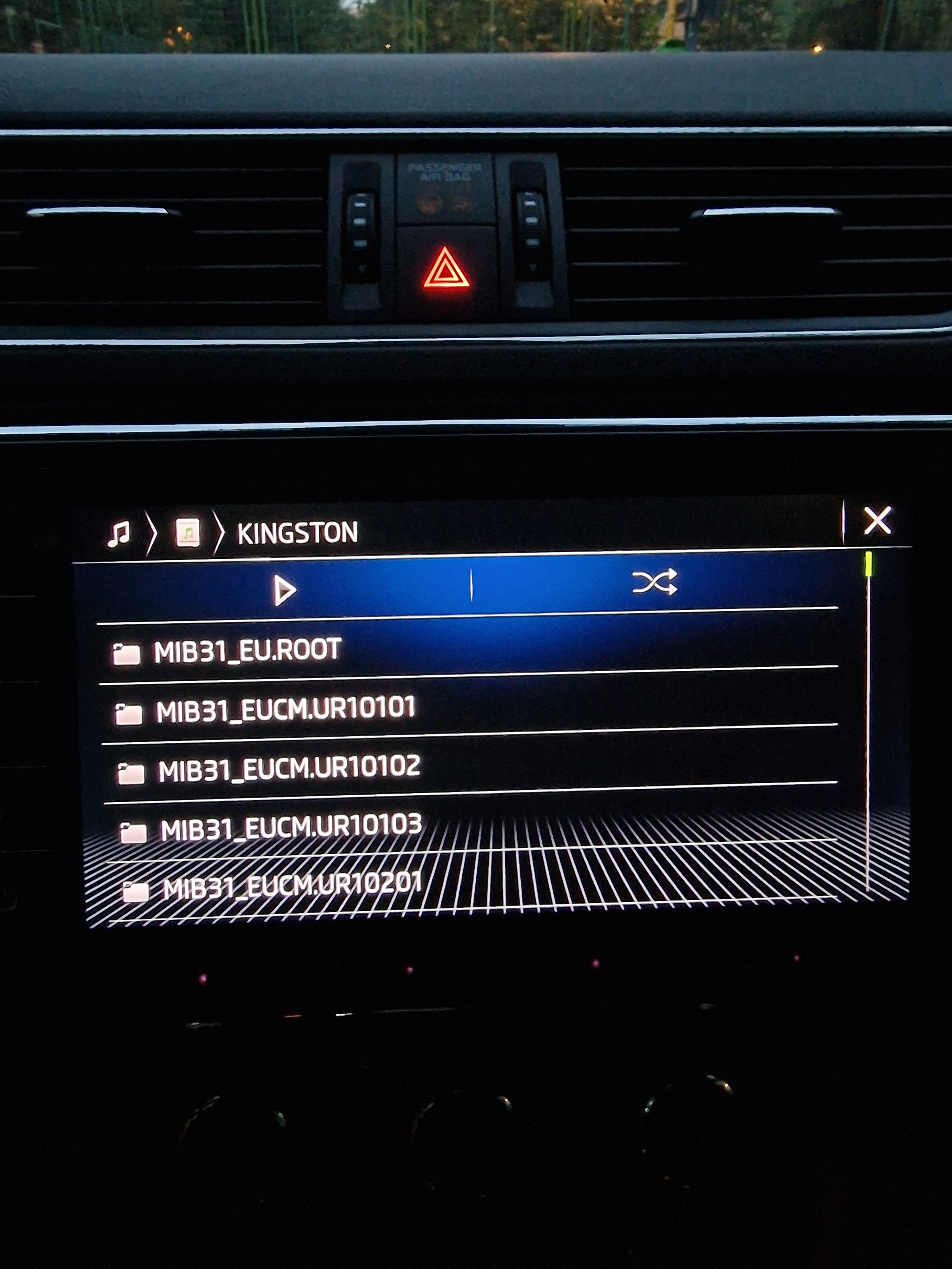

One thing I did notice when I plugged mine in and it was read was that the drive appeared under the Media section, may be worth checking there as that will show that the unit can actually read it

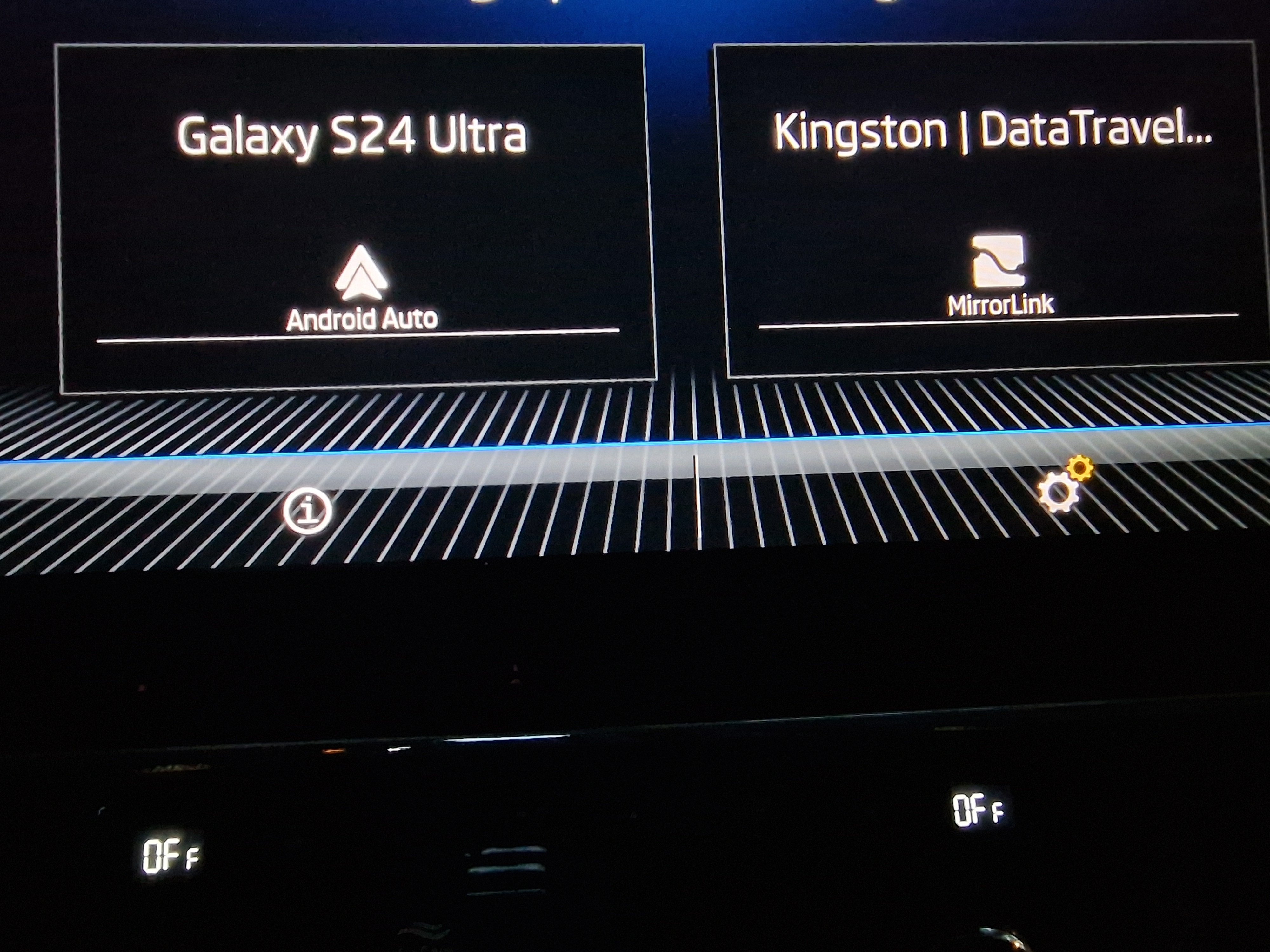

So I plugged the usb stick and the drive appears under both Media section & SmartLink, as attached in the screenshots. So I guess that the unit can read the drive, but something's... still not right with it...
Edited by AlexNec
Had you unzipped them before transferring to the stick?
Already unzipped, yes, as you can see in the screenshot from the previous post, I only have the contents of the update on the stick
