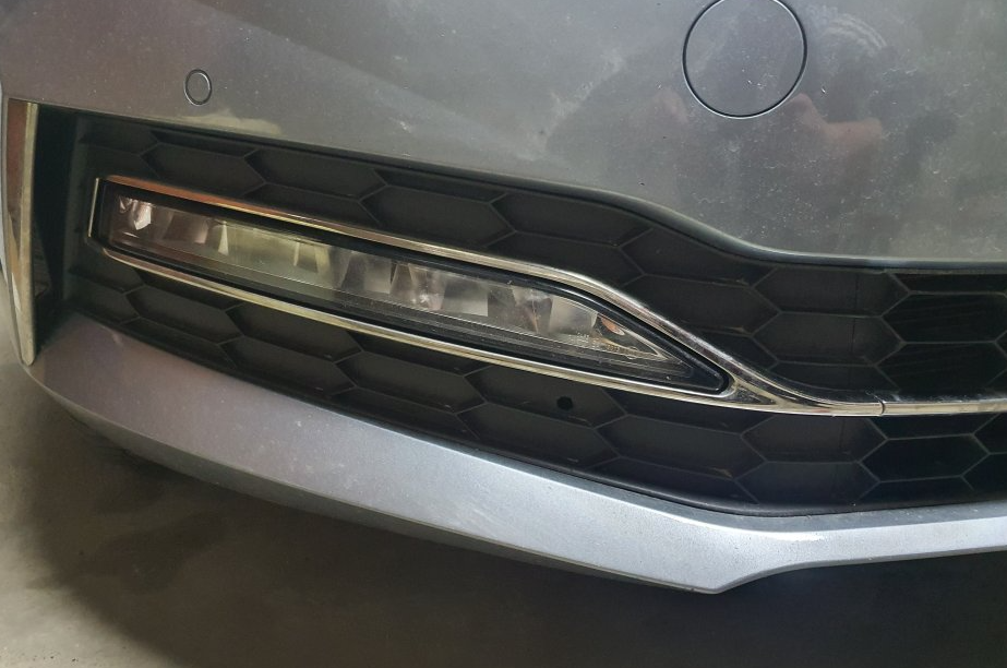

You have to get the grille off, the foglight is held by four screws screwed in from the front.

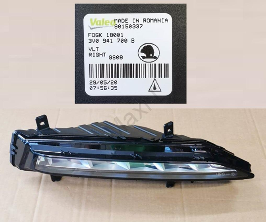

this is the style of light I'm trying to get to the back of to remount. im hoping its just been pushed of some clips, but if its screwed in the threads hay have been pulled off?

just found the part number and picture. so its held in with 4 lugs and screws from the rear. looks like I'm going to have to order a new one . ill look first.
The black honeycomb pattern grille pulls out leaving the light behind and revealing the screws. There should be a wire tool with a hook on the end in the boot for this purpose.

Good luck, in my case, the impact of the pheasant ejected the grille!
You might be able to push the grille out from behind with less risk of it breaking.
Don't waste your money on aftermarket grilles, very poor fit and flaky chrome.
Ok thanks. I’ll get genuine I don’t have Chrome on mine it’s black. That’s just an internet picture for reference.
