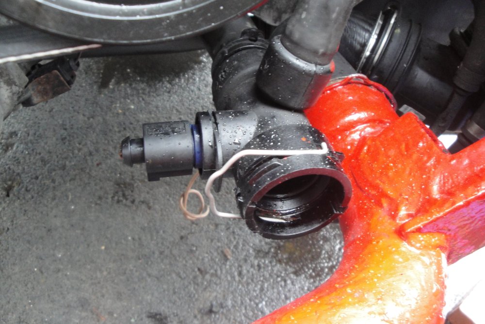

  8. Photo of cad shaft sensor next to the pulley

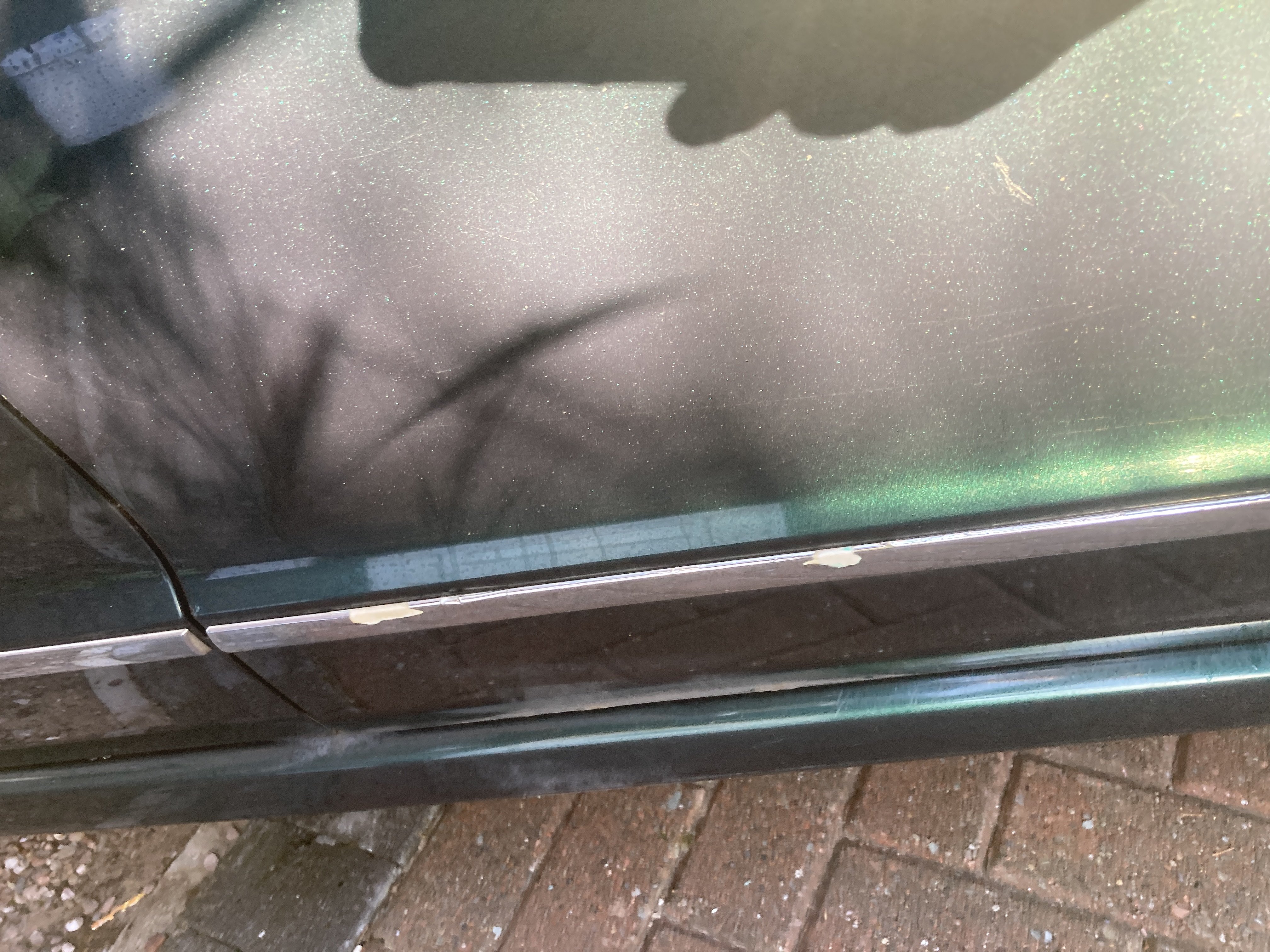

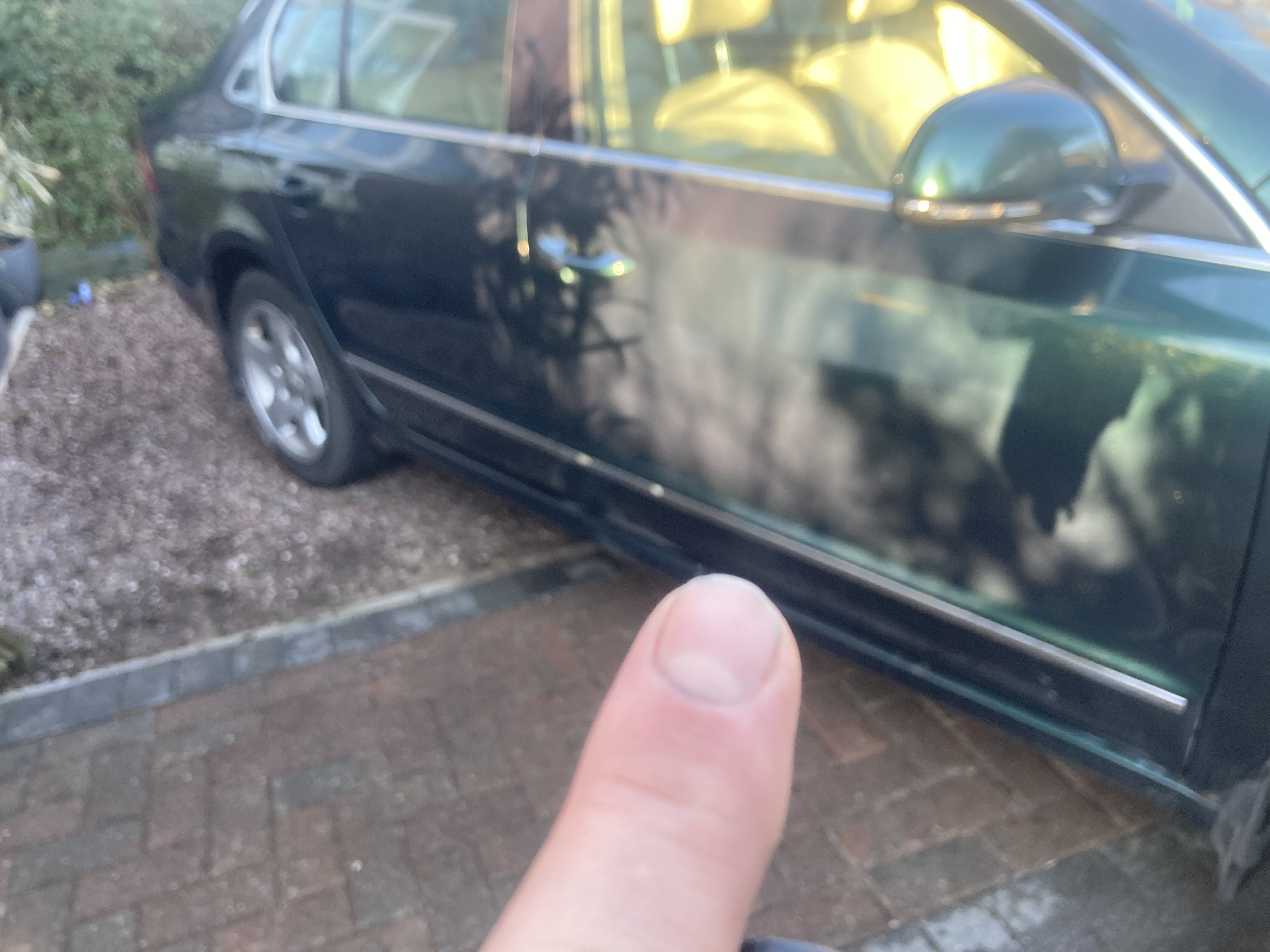

  13. Hi has anyone got any advice on replacing the lower external door trim please. Mine has decided to flake. What part number? Where to get it? Is it obtainable? Is it easily removable? And how do you replace it. Would appreciate any help to the questions Thankyou
  14. A replacement part is: 3T0810773A The motor part of the mechanism wears over time as it locks and unlocks each time you lock and unlock the car. Either buy cheap of ebay £20 or Horton Skoda sell them online for about £48. To change it you unlock the flap and open. Remove a screw. Remove the fuel cap Pull off the rubber cover surround off. I think there is one more screw to undo. Remove it by sliding it out. I would advise you cut the cables and reconnect them on the old and new one. This a is easier than removing the internal boot trim to get a the awkwardly placed plug and B makes it easier to replace next time if you go for a cheaper unit. Did mine about a month ago.
