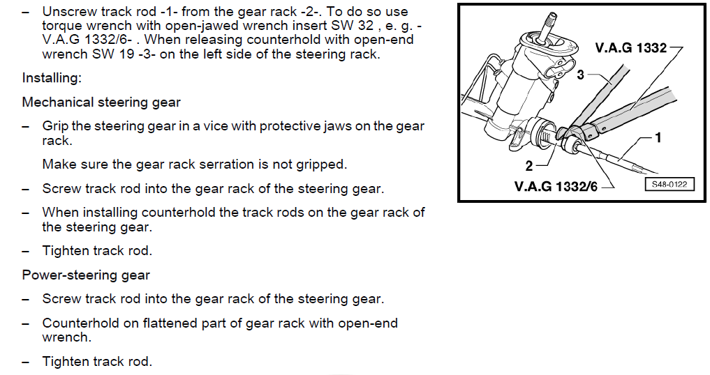

  2. Hi folks, I'm faced with fitting a new inner tie-rod to the missus's mk1 Fabia imminently and was looking for guidance about one particular aspect. The 'book' instructions insist on full removal of the rack from the car which seems extreme (won't be doing that); and then, with the thing out of the car they say that the main shaft must be counterheld against the loosening/re-tightening torques using a spanner on some (19mm AF?) flats which is present only on the left hand end: It's the other end I'm replacing so I'm a little reluctant to bugger about with this as it means pulling the boot back on the side I'm not doing, and possibly needing another pair of hands to hang off a spanner somewhere in the deep dark recesses of the bay. What's the level of risk of damage, does anyone reckon? Preferably people who've done the job without counterholding, and driven many happy miles thereafter. Cheers EDIT: just thinking...the diagram shows a LHD rack, wonder if the flats are on the other side for a RHD one, i.e. a mirror image and the side I am actually doing? anyone know?

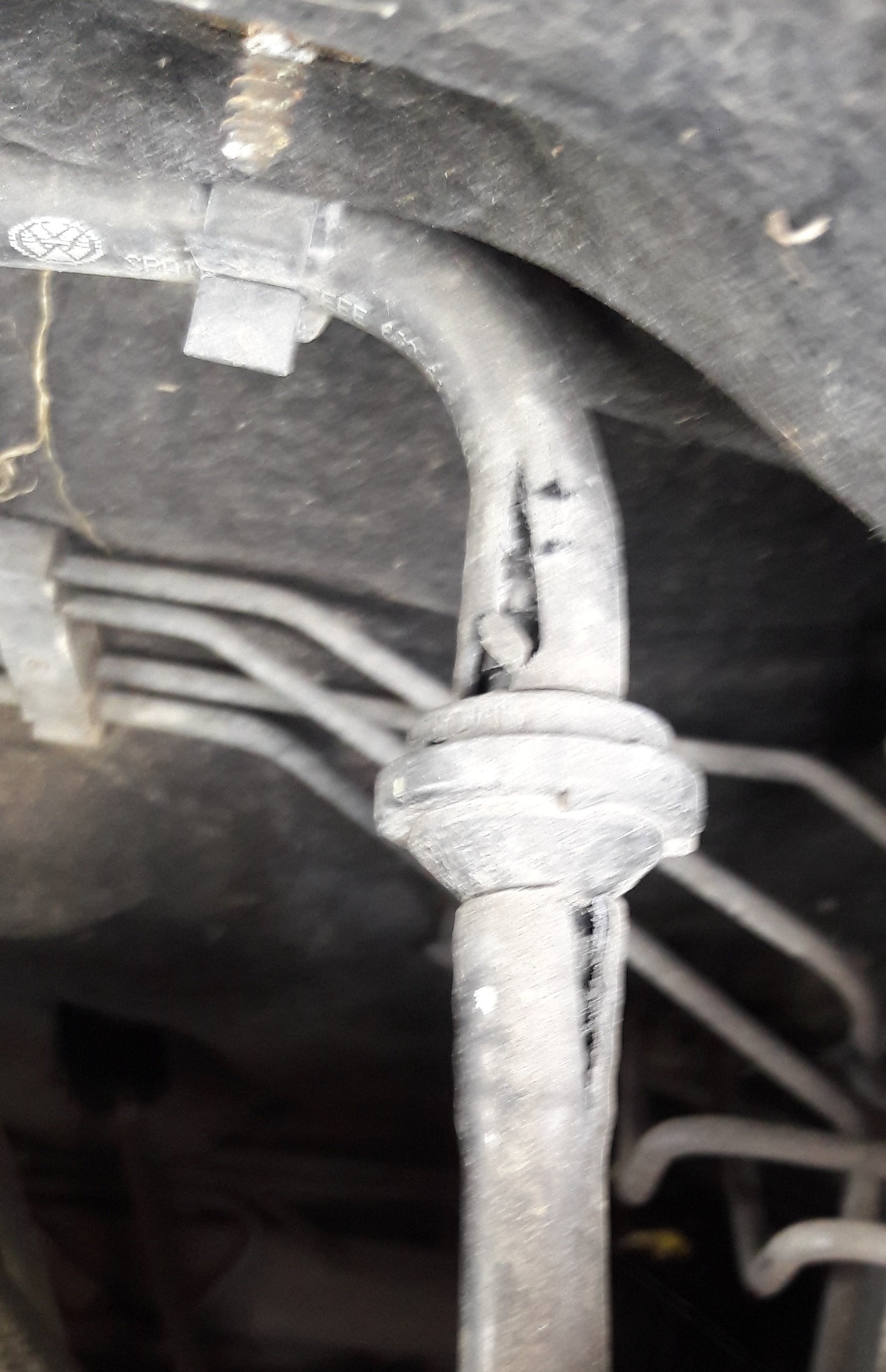

  5. Found another beauty at lunchtime on a new workmate's 05-plate Fabia. Check yours today, cheapest bit of diagnostics/preventative maintenance you can do. Gaffer tape until pipe replaced if significant cracks are found. Part number is printed at regular intervals along the hard plastic part of the hose. Don't forget to run your fingers round the underside of those connections, they often crack out of sight on the road-facing sides.
