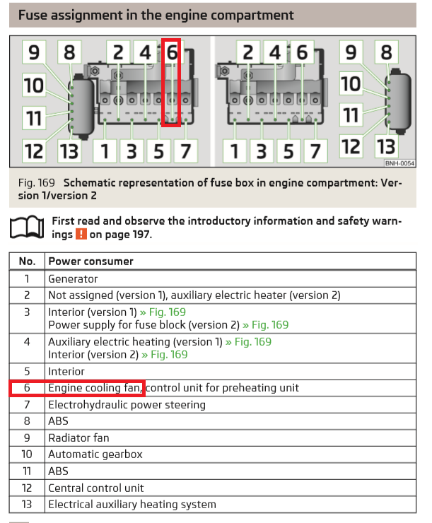

Skoda Rapid Radiator fan not working
Yes, probably hanging off a bracket on the left (your driver's side) chassis leg, near to the fan connector. Alternatively, you could disconnect the wiring connector from the radiator thermoswitch (just above bottom hose connection) and short the brown wire to each of the other two connections. Ignition on for this, and mind fingers/hands as the fan blades could injure if it does spin up. Brown wire to brown/blue should bring the fan on at low speed, brown to brown/green should cause full speed.

- Skoda Rapid Radiator fan not working
It's not in that fuse section that you want to be looking, it's the bigger fuses to the right of there. Only if there was no A/C would it be the second one down in that section, as far as I can see. In the wiring diagrams it's called SA5, a 50 amp fuse in that row of 6 (7 positions with one gap to the right of the first fuse). It has a thick (6mm² conductor cross-section) red/black wire coming from it. I've been caught out by this before, where the wiring diagram only numbers the positions where it's possible to fit a fuse (so rightmost position is labelled 6), rather than all 7; but the Owner's manual and maybe the physical fusebox? labels all 7 positions and the numbers after 1 all get mismatched compared to the wiring diagrams. So it might be in position 5 or 6 depending on whether this same mismatch has continued in this model. There's another fuse to check, in the cabin fuseholder. Number 9 which gives an ignition live feed to the radiator fan control unit.- Skoda Rapid Radiator fan not working
@Koreenium Is it the Climatic, or Climatronic A/C system? And I guess it's a Left Hand Drive car?- Correct gearbox oil
No, it looks like that may be an incorrect assumption. I believe all mk1 Fabia vRS's are 6-speed? In which case the oil used in the factory was G005100A1 (2.3litres), as per item 5A here: https://skoda.7zap.com/en/cz/fabia/fab/2004-225/3/300-300010/ (scroll down to the very last row of the table) That part number was superseded in 2009 by G 052157A2, according to this page: https://oemwolf.com/oem-parts/g005100a1.html#replacements- Skoda Rapid Radiator fan not working
I will investigate for you tomorrow ☺️- Skoda Rapid Radiator fan not working
Let me know if it's not obvious which fuses are involved, I should be able to help.- Skoda Rapid Radiator fan not working
