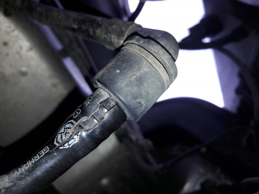

  2. Rather than trying to think about it, just do the free and simple check I've suggested. A new servo is a whole heap of cost and effort compared to replacing a vac hose, so check whether the vac hose needs replacement or mending first; no matter how hard it is to figure out why it might give rise to the observations. An (extreme) example of a failing servo hose:

  4. I'd be very carefully double-checking this, both by feel and phone camera images. Assuming the same questionable materials are used on your model as on mine; the hard plastic sections of the servo vacuum hose are infamous for splitting at the junctions where they are pushed over hose barbs on things like the non-return valve. If you haven't checked such junctions from all angles, have a look/feel now.

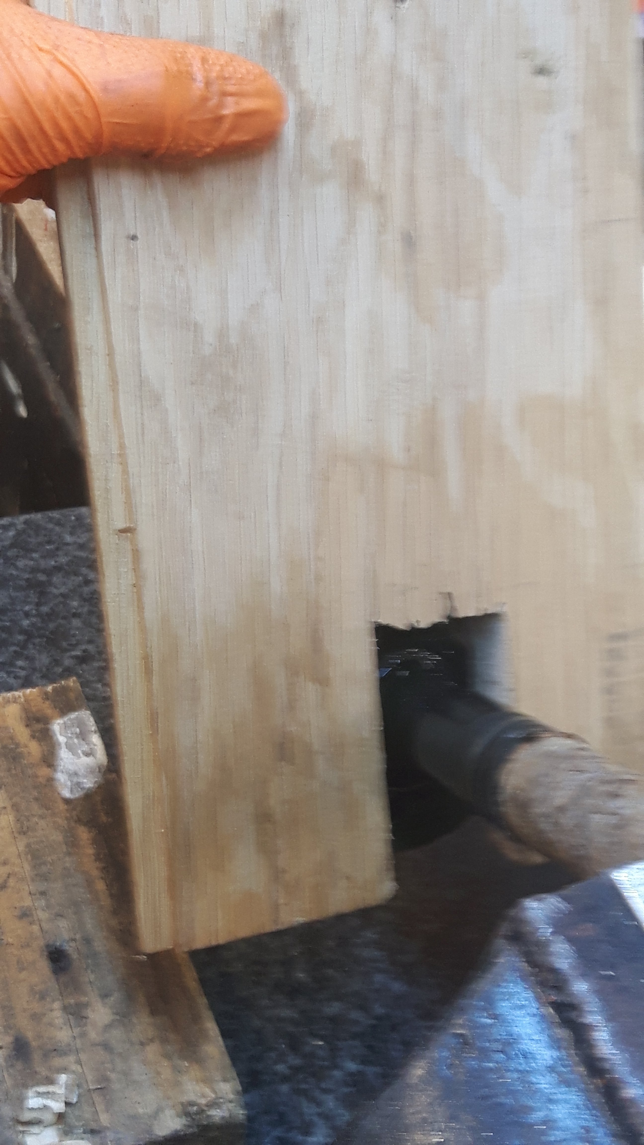

  16. I made a 'pusher' to work with the biggish hammer. Went on the first hit . Just wish I'd cleaned the oak sawdust off the pusher a bit more first.

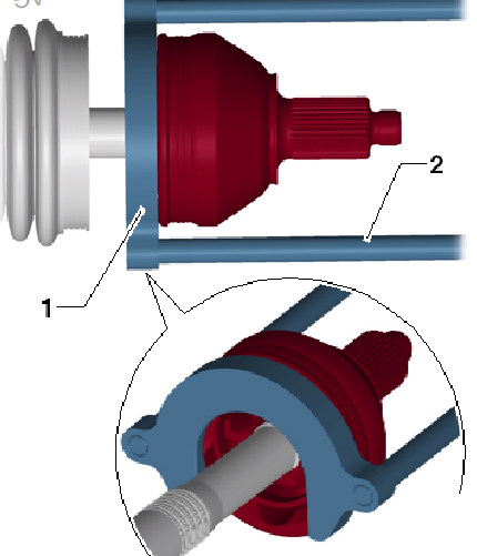

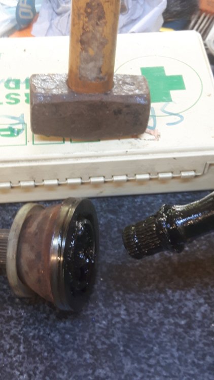

  17. I will try hitting harder after lunch. Yes, VW771 goes with that puller, and google says that's a slide hammer kit. Interestingly, the Fabia workshop manual for identical part (number) driveshaft suggests hitting, with a drift "positioned exactly at the centre of the CV joint.".

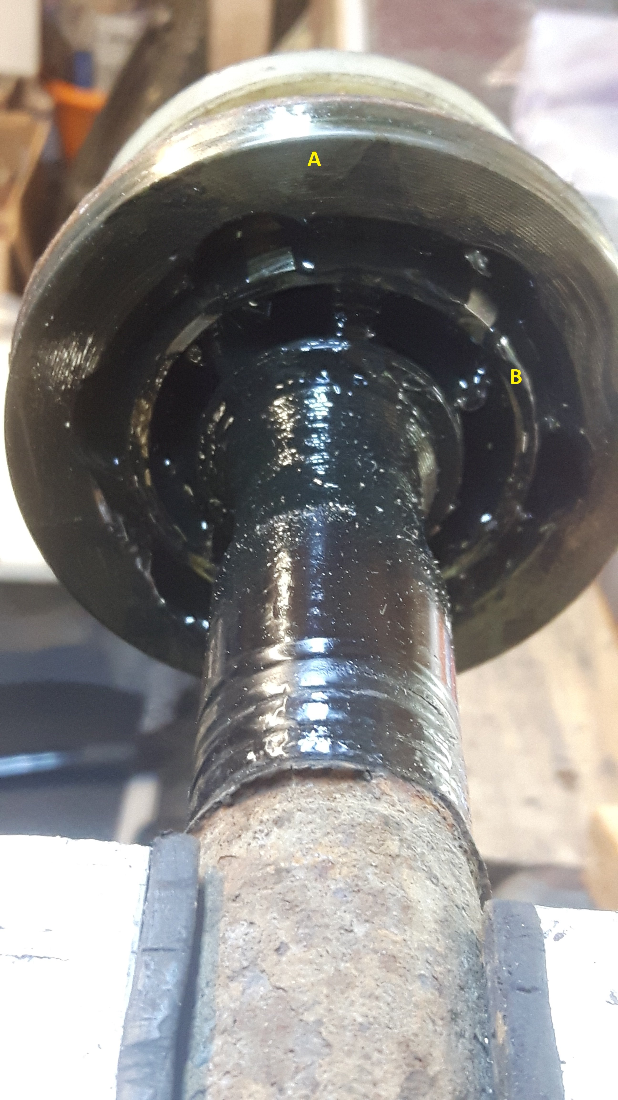

  18. Only done one of these before, years ago on a Mk2 Golf, don't remember any trouble but this one's not budging easily. It's actually on/off a 9N3 Polo, and the boot needs replacement. Workshop manual suggests a puller arrangement, which I don't have but can make if necessary. It's just not clear which surface(s) the puller needs to work on (A or B in my picture, or both)?:
