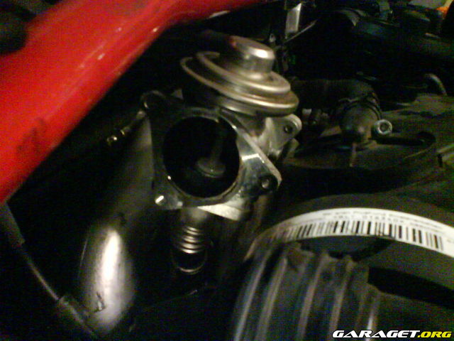

Quickest and cheapest investigation would be to pull pipe off EGR and have a look inside. Bet it looks black and oily. If in doubt take it off and give it a clean (lots of guides here and in TDI club website). It is easy, but wear thin gloves or you'll have black finger-nails for weeks!
Best of luck
Best of luck
Just any pipe or which one preferably?
I think he means the EGR valve:)
Oh that's what it looks like, may take the pipe off and have a look.
Do I need anything special to clean it with?
