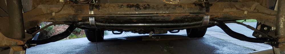

i've been looking at using the front anti-roll bar from a vauxhall tigra, it is almost exactly the right shape, just need to trim the ends a little and figure out a way of joining it the the beam

here's the vauxhall tigra front arb
£5 from the breakers yard
removed saddle clamps and the remains of the bushes and gave it a good clean, has come up like new :D
width looks about right to me, all i need to do now is figure out a way of mounting it... i might even paint it red to make it look fast
ok here's the plan....
use a pair of rover 800 drop links to connect the bar to the existing felicia rear arb which is bolted to the rear beam as shown in the scanned picture above

right i've thought of a better way of mounting it, completely remove the old oe rear arb.. use a pair of mikalor clamps and some bushes to secure the centre of the bar to the rear beam, then i'm going to cut down the ends of the bar to the right length, then weld on some mounting plates so that it bolts onto the shock absorber bottom mounting using a longer than standard bolt
peugeot 106 anti roll bar saddle clamp, i'm going to cut off the mounting lugs :o
peugeot 106 roll bar bush..
mikalor stainless steel clamp
i haven't forgotten about this, going to pick up a spare rear axle to play with soon.
now i've got a spare axle beam to play with
the vauxhall tigra anti-roll bar will sit somewhere approximately like this
i got these saddles from a citroen ax in the end, they are almost exactly the same as the peugeot 106 ones
after a few miniutes with a hacksaw, they now look like this
the bar is clamped on
overall cost so far is about £13
£5 for the vauxhall roll bar
£2 for the citroen clamps and bushes
£6 for 2x mikalor clamps (97-104mm)

looking good.
think i'd be tempted to put the clamps a little further apart mind?
yes, they can come a bit further apart, but the bar is not completely flat along that side, also i have to be careful not to interfere with the operation/routing of the handbrake cables...
tbh, it doesn't make much difference where they go
Looking at the picture at the top of the page, What are you going to gain on a trailing beam set up like this? Surely it should be attatched to the car chassis. I only ask this because i regularly retro fit arb,s to trucks, and know that they wont work unless attatched to the chassis
yes, i agree with what you are saying totally, i always have the same thoughts regarding the jabba-sport rear arb kit for the fabia, i completely cynical about it but based on the testimonies of people who have fitted them there must do some good, as you know the rear beam is 'solid' BUT they do flex a little under normal cornering loads, this can be seen when the back end of the car is in the air, if you put a trolley jack under one side and raise it off a little. one side is higher off the ground than the other albiet only a tiny amount, so effectively adding a sway bar (which is effectively just a spring) you are making the beam more rigid:)
