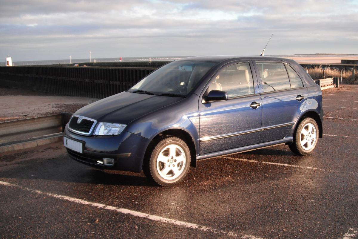

I bought her new in Jan/Feb. 2001 & sold her this Jan, so 14yrs, longest I think anyone has owned one from new! & yes I do miss her, here is what she looked like when I sold her:-
