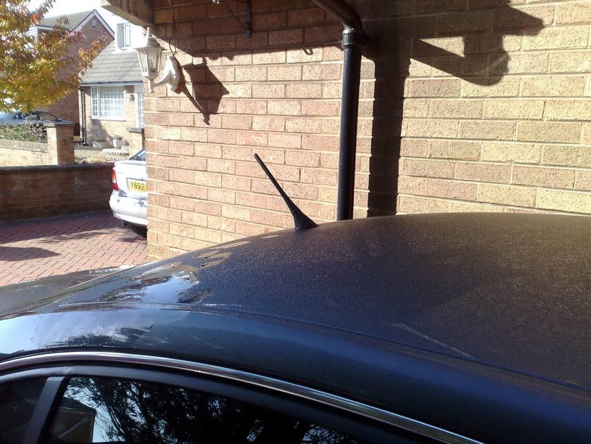

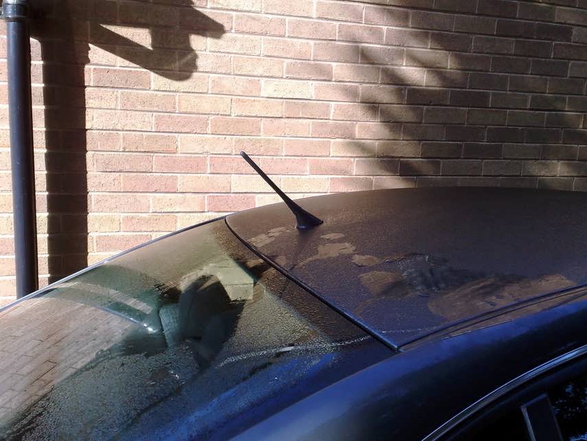

Here's one I made this morning.

Is this a 63mm or a 110mm aerial in the pictures?
Edit: It is not clear from the picture: Was this the aerial that folds rearwards after partly unscrewing? I noticed in Vagcat yesterday that there were several different aerials supplied with Superb.
Yeah mine folded flat once unscrewing, but like you I hear some don't, hence I didn't clutter up the "guide" with it .... not that I kept it uncluttered anyhow.:rolleyes:
The aerial length, not sure, it's a genuine Honda S2000. At a guess I'd say it's 180mm. Not the shortest on the market but I read a few comments and these still give excellent reception. I hear the alloy ones can be terrible.
