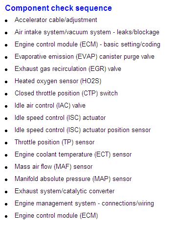

These are the published troubleshooting points for dodgy idle, in the order of checking:
