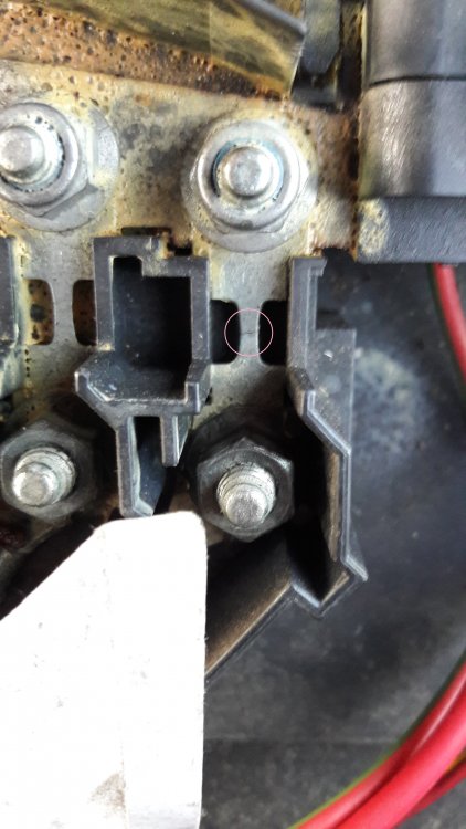

  • Same fault code read using VAG-COM, same solution for Fabia 1.4 16V 2000 W reg! Awesome tips. Had been quoted ~£500 for ABS Hydraulic Pump and ~£500 for Control Unit and ~£150 for labour by two Skoda
  • Thank you so much for this forum. Another beneficiary of the information given Took my car in with the abs warning light and quoted £700 for a new pump. I was having to consider scrapping the car bec
  • Well to say I am marginally ecstatic is an understatement.  Collected the little 40a strip fuse from the Skoda dealer, drove round to the garage who popped out the old fuse in two halves, fitted the n
Thanks go to docdlb and others for suggesting No 6 fuse. Work colleague kindly donated his old Fabia to us and it had the ABS fault light on, turns out
the fuse had gone on this one too! So that's £500-odd less to have to pay out, just needs a service and mum now has a car of her own to use.
Happy days  :sun:
(It would be interesting to find out why this fuse has become weakened enough to crack like that - I'm thinking that the car cycles the pump
for a short time at startup (bearing in mind the starting current of the pump motor would be very close to the fuse's rating), just enough to heat
the fuse and weaken it, but not enough to cause it to blow. I'm wondering if VAG underspecced that fuse, and it should've been 45-50A)

Another one bites the dust. The missus phoned, sounding a bit anxious, said she'd just got to her destination, then started the car again to move to a different parking spot and ABS light came on. Got her to pop the bonnet and examine the fuses above the battery. Her mate spotted the hairline crack.
Not too tricky to see when you know what you're looking for. There was a spare fuse in the car but no suitable tool to undo the nuts, so a 3 minute fix when she got home.

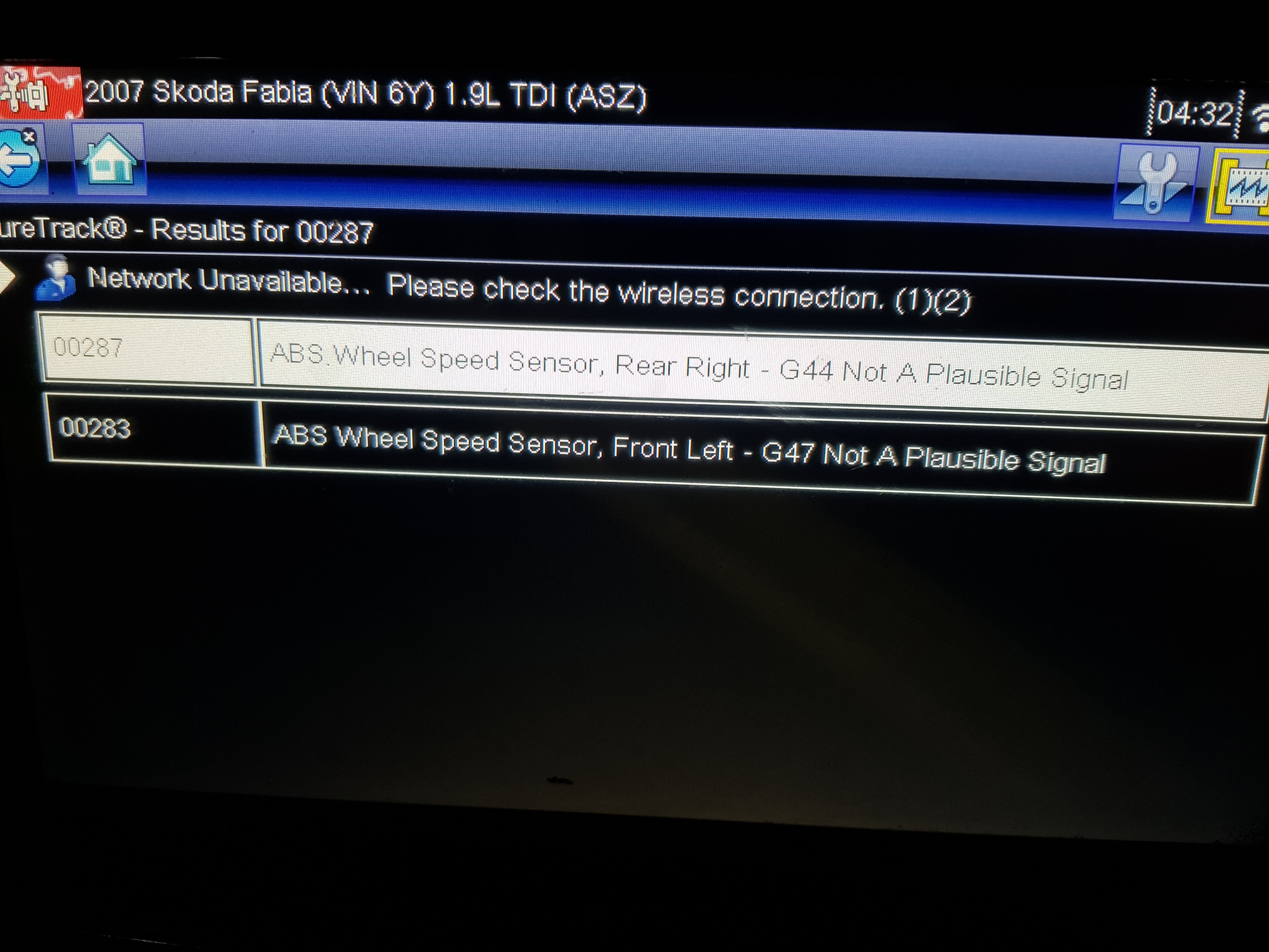

I have sweet talked a local VAG garage to squeeze me in for VCDS scan at 5pm just before they close, any excuse to leave work early! They're charging £30 which I don't know if it's a fair price or not but its a same day scan with a few hours notice, so i'll take it!
  • Sponsor
Oh that's good news. Write down any/all codes that result, ideally get a printout.
'Not a plausible signal' so seated incorrectly, wires bad or magnetic ring bad?
