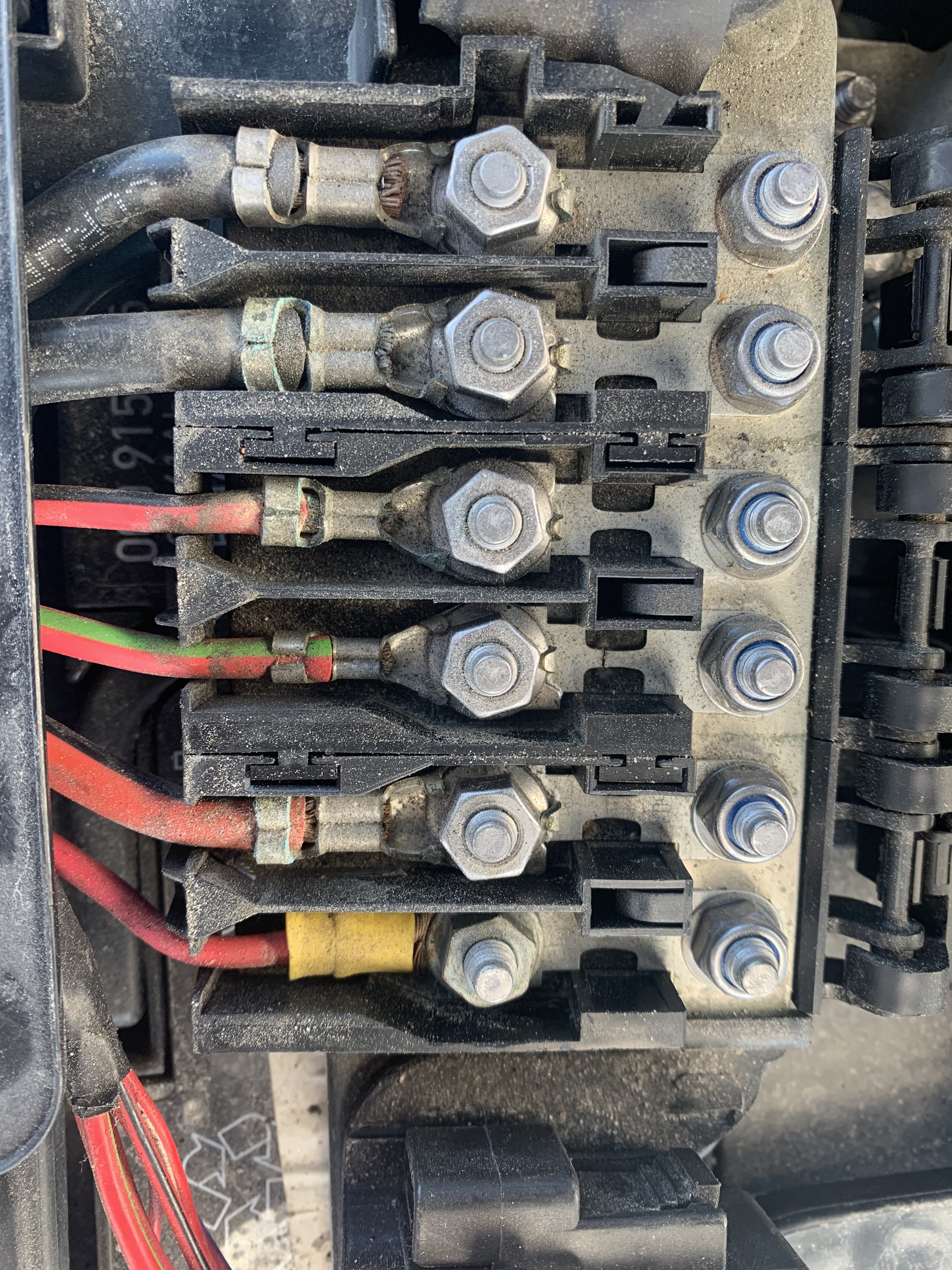

Thanks for this thread, there is no way I'd have diagnosed this one as being a faulty fuse.
I've a 2003 Fabia vRS, dropped the rear axle off to replace the bushes, battery went flat and so I removed and charged. When I refitted everything back together I got two rear sensor faults. I replaced the passenger rear wheel bearing (It was stuffed anyway) and ABS sensor and then got the additional ABS Return Flow Pump fault. Quick search, found this thread and guess what... crack in Fuse 6.
Replaced with a new fuse and it looks all good for the moment.
Thanks everyone for sharing on this thread, saved me time and money.

Thanks guys! I have a Roomster 1.6 -07 with the abs+esp+braking lights that turned on from nowhere. The mechanic checked for error codes and it was apparently the 00301. Would be quite expensive with a new abs unit så googled and found this excellent thread, a change of the 40A fuse solved the problem! As a bonus I actually noticed that the 50A steeringservo fuse right next to it looked somewhat broken (although not completely) and changed it as well, now the steering feels much smoother.
