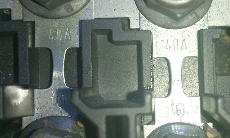

Unbelievable, but the same helped me too. Skoda Fabia 1.4 16V 74kW (2004). ASR, ABS alart, before EGR alaert, the fuse was broken as on the pictures here. After the change, everything works fine! Thank you very much for the tip!

Yeah, mine looked like it had more weakened in the middle and just broken. No signs of anything actually blowing apart like you sometimes see when an internal fuse pops. It just looked like a hairline crack.
Can barely even see the crack in this pic (far right one)
I might get under this car for a look at the wiring for the ABS unit, just to be sure.
Ah ha.. Yes they do just go for no reason sometimes, I think it's just the constant heating and cooling cycles the engine bay goes through makes them expand and contract..

I've also attached a picture of my number 5 and 6 fuses, does number 6 (one on the right) look damaged at all?
It doesn't look entirely broken to me, but does look like there's some damage to it.  I have cleaned the fuse to make sure it's not dirt on the fuse.

40 amp fuse...hairline crack....sometimes hard to see. Bought a pack of 'ten' online for £3.50p !!!!!!!!!!!!:-)
