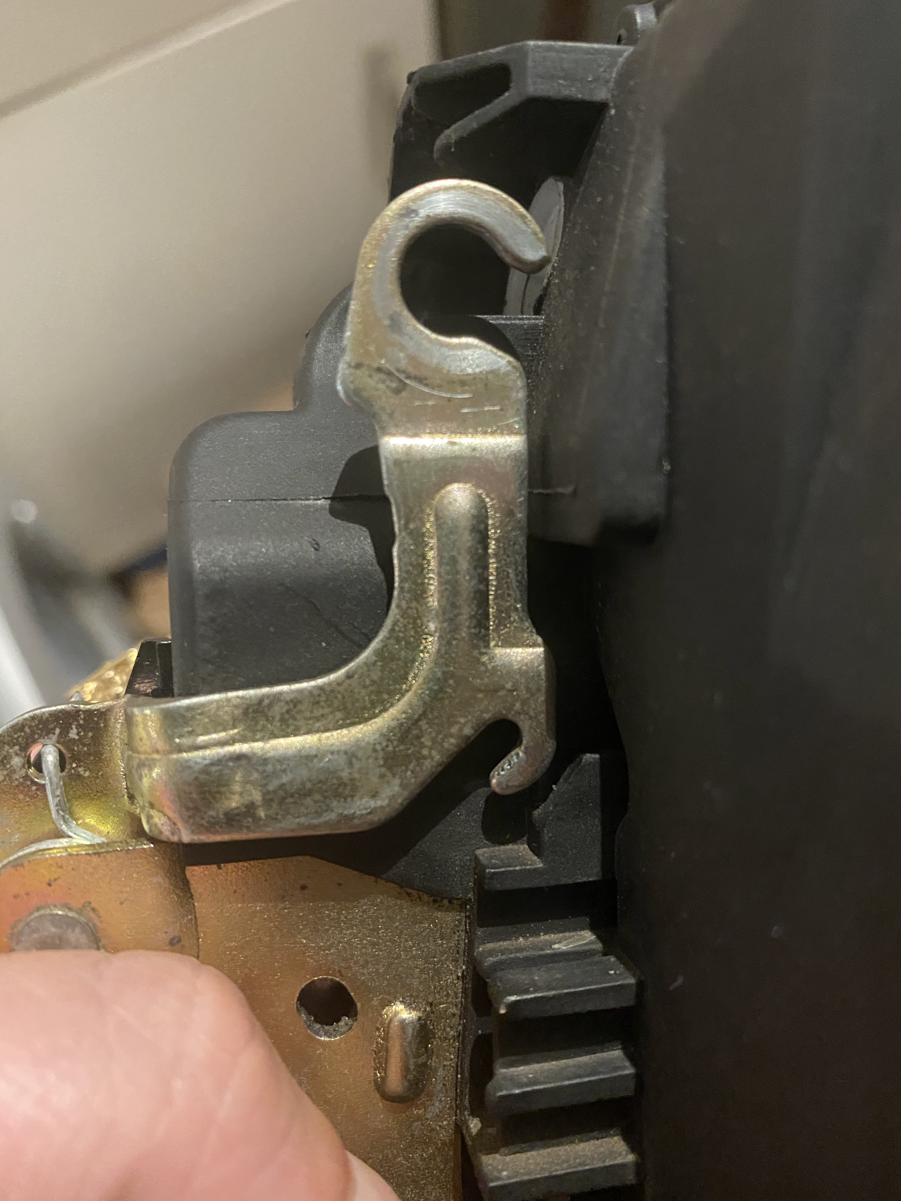

Done this now the door has deadlocked shut. It can’t be opened from Inside or outside with or without the key.
ive left to door card off to make sure it would’ve been easier if something like this were to happen.
how do I get around this?
since doing this I’ve discovered pins 7/8 are corroded so now thinking there’s no power getting to it even though the windows work. Is there an easier way to fix this other than replace the entire wiring loom?
Biggest issue though - how do we get the deadlocked door open? It would open with the old locking mechanism (which only had a bent pin) which was discovered after taking it off.

if its dead via the loom, it might not be locked (as in it mightve not locked but just wont open)
did you carefully count the threads the ribbed end of the outer bowden cable before removing and refitt with the same count visible?
did you test the mech several times with a screwdriver to close the latch before you closed it?
try leaning a bit on the door panel just beside the handle to push the metal in just a bit and pull the handle at the same time. if the cable is over tightened this will relax it just a smidge and might allow it to release.

do you any idea how to get this deadlock off? I’ve already smashed my way into the casing of the NEW locking mechanism to access the gearing, I’ve tried turning the gearing but it remains deadlocked. Any other ideas?
wanna know what my problem turns out to be? Corrosion on pins 7+8 of the 8-pin wiring loom connector. 🙄🙄🙄 not only that, pin 7 was bent flat in the old locking mechanism, I’ve straightened that up and checked whether it worked and it did (this was with the lock off the car but powered up, you could put the key in and turn to open and lock all doors but remote isn’t working to lock and unlock the drivers door only. Lazy lock/global unlocking/windows down and up (whatever you wanna call it), that worked today with the key for the first time.

got it open by following the steps in this video:
mech was tested multiple times, it was this that wasn’t returning to where it should’ve returned to (see image). It was out by about 1/2mm causing it not to open from both side. Once the wire to the handle was released and the hook pushed forward the door opened.
I now need to find out what pins 5, 7 and 8 are for on the 8 pin connector to the mechanism as these ports are corroded. I will order this as a replacement:
