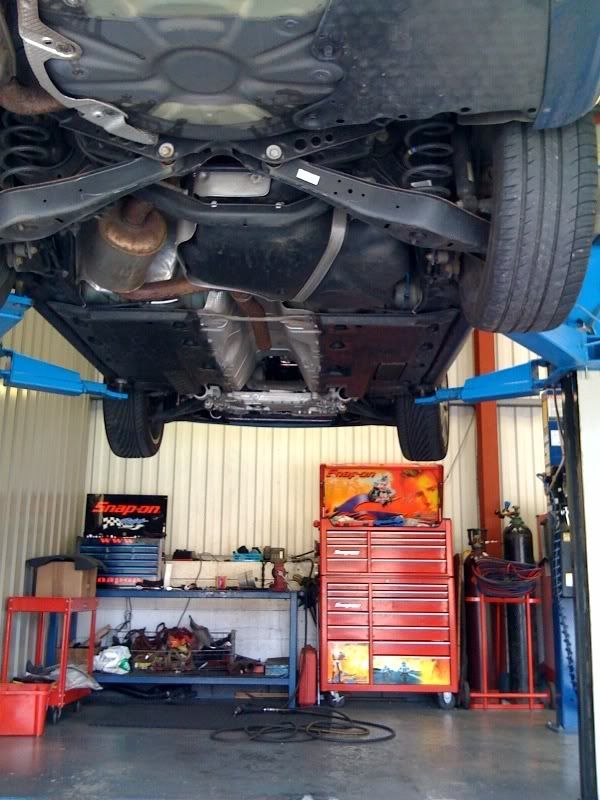

Out with the old...
Edited by wega3k
... and in with the new ...
Edited by wega3k
Mapped and driven home. Very different car to drive. All or nothing torque spike gone. Now very smooth, much more linear. Great top end (for a diesel ;) ).
