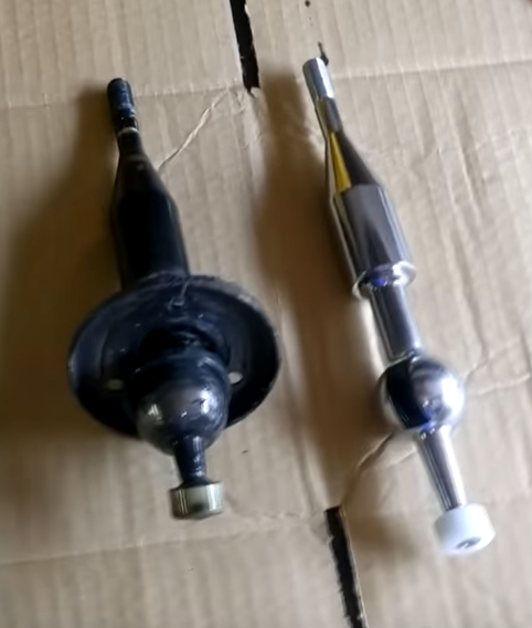

    Sometimes depending on the angle, the sun reflects especially on that chrome square frame of the console. Yes, beauty demands sacrifices.
If your gearbox and clutch are not up to quick shifts the short shift will just save a bit of cabin space, you could do the same for this effect just by cutting the gear lever down, and if required rethreading the top, for the gear knob to sit lower in the car.
As i have seen in other cars as MX-5 Miata the new lever has bigger length below the ball.
Miata is the American name, at home it's called the Eunos and in UK MX-5.
Yeap, you alter the point of wotsit (fulcrum?) pretty standard stuff, either kit adaptation or as you have shown replaced lever.

Interesting, it looks like they just put together two auxiliary levers (the one that's in front of the gear lever) and moved the pivot upwards to compensate. It's obviously meant only for hard motor mounts, since it lacks the secondary rod which compensates for engine movements.
Oh, so it's not for us.

Quickshift, short shift, these are about motor sports, what's good for motor sports might not be so good on a road use car or even not good at all.  Shortening the existing gear lever at least keeps standard parts that you know fit and work, whether this or different parts actually achieve what you want is a different matter.  I've had shorter levers in two of my cars, one I just cut the length down in situ, didn't  even need to thread it, it gave me the effect I wanted more elbow and knuckles room.
Below cheap quickshift lever being offered up for my mate to cut down and thread at his work during hie lunch break.
