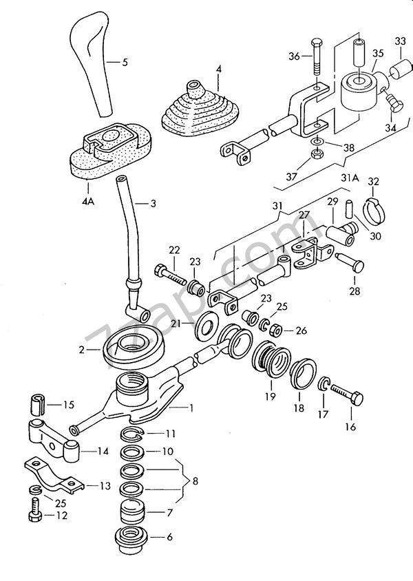

Here is the Felicia mechanism.
i have installed some years back that kit because was a bit loose, not any other oprion except VIKA.

The potential for slop getting into such a remote rod changing as on your car must be great but to reduce it would introduce transferred vibrations which are not noticed on race cars with all the other noises, plus driver wearing ear plugs and driving helmet but would be on a road car.
Here as is in the manual, high resolution photo which don't fit in a post so i put a link.
https://img.7zap.com/images/oem/vag3/SK/Bilder/101/101711000.TIF.png
Shortening the A is not an option, making bigger the B is but i have to find an electro welder to take the responsibility.
Even so, how much length? 2-4-6cm longer?
It is an option, you might not want to do it and doing it may not give you what you want anyway or improve things.
This you might want to do but it may not give you what you want anyway or improve things.
But it's your car so you will as always do as you want.

Not for me, i have already installed and aftermarket knob which had 3 plastic cones as accessories to fit it properly.
Now the height is as it should be, in M3 or MX-5 a factory short gear shift it suits, not in my case.

I don't want to shorten the A part, i can not drive with a gear stick like this
because my console is lower than this MX-5 and every time i have to bend so my hand can reach it. :D
