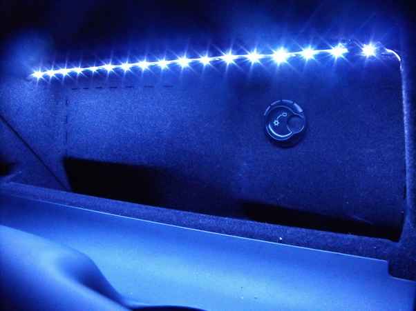

Pictures as requested.
I will add that, if I had thought about the location for about 30 seconds instead of 10 seconds then maybe more light would end up in the boot, rather than the side of the car. Still, at that price I could add 4 more strips and have Blackpool Illuminations in my boot.

Happy to try out some of the suggestions comming in, I never think much about a job before I do it and generally do the first thing that comes into my head that seems like a good idea. I have already thought that I should have stuck the strips in a different place but where they are seemed such a good idea at the time, hidden from view and out the way. It's a shame they point in the opposite direction to where the light is needed though. Still, at that price, I can just get some more and do it again or add to the ones I've already fitted.

I shall post some more pictures ASAP. I can't get in the boot yet as it is frozen solid. They are stuck to the inner lip of the plastic side bits that the rear speakers would be mounted to if I had any. This means they point to the wheel arch. I should have stuck them on the bottom part (90 degrees to where they are) so they point down onto the boot floor. ????Confused???? I shall try to get some photos to help explain.

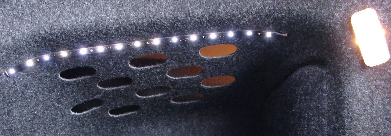

Since asking for the pics I decided to throw caution to the wind and bought 2 sets of the same leds.
I was initially going to fit them facing down on the plastic part sides of the hatchback tray but due to the supplied cable not quite being quite long enough, I took the easy option and stuck them in the arch at the top of each 'cubby hole' opening in the boot with a discrete hole for cabling.
They were joined in parallel to each sides normal boot light thereby causing no canbus problem. Access to the bulb cabling was via the trapdoors in each side of the car and a firm pull removed the bulb plug to enable greater ease when 'splicing' in the wires.
Here's a pic to show what I mean:-
This may appear a bit disjointed as I've inserted the pic after andy's next message but I'm awaiting delivery of another 2 smd leds for the footwell lighting. This will need additional wiring soldering on but it's possible to join on to the front interior light wiring via the LHS door pillar so shouldn't be too much of a problem.
Im not lucky enough to have a boot light both sides... Where you said you were going to fit them is where I should have put them. My explanation was pretty useless. I had to extend the supplied cable anyway to get the feed for the o/s strip from the n/s boot light so I could have put them anywhere, I just didn't think it through very well. I even know that LED's are pretty much directional and not a lot of light is emitted from the side of an LED but I was so keen to get them in and hidden away that I ignored myself. I was thinking of removing them and putting my new ones in the "right" place and using the original strips in the front footwells. Sounds like a bit of a messing around but my new ones are brighter so would be more suited to the boot. (they are brighter as they are standard LED bulbs rather than SMD type)
